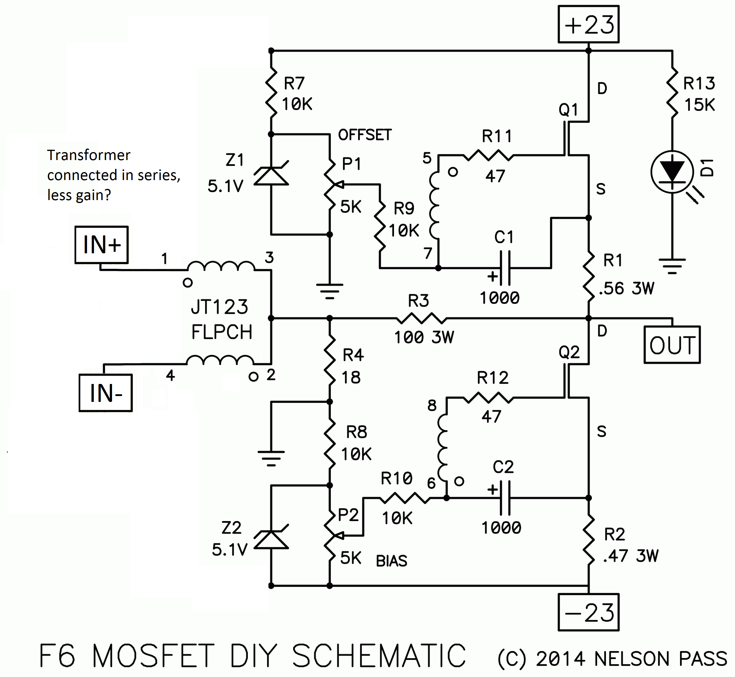

I have decided to try an build an F6 & F6 ish amps but have some wonderings about it:
First is about the input stage. I have a low source impedance of 100 ohm so I will skip the buffer, which is nice as the JFETs are hard to get anyway.
I do, however, have a balanced source so I'd love to use balanced input to the transformer if possible. The issue lies in that I'm not sure how I should go about it to integrate it with the feedback loop.
Let us start with the normal unbuffered F6. Nothing fancy here.
If it is too messy to use balanced input and keep the smart feedback of the F6 I might just give up and use single ended but it would be nice to know that options I have =)

- I believe I could series connect the transformers as in the second image. Should work but this should loose some gain right?

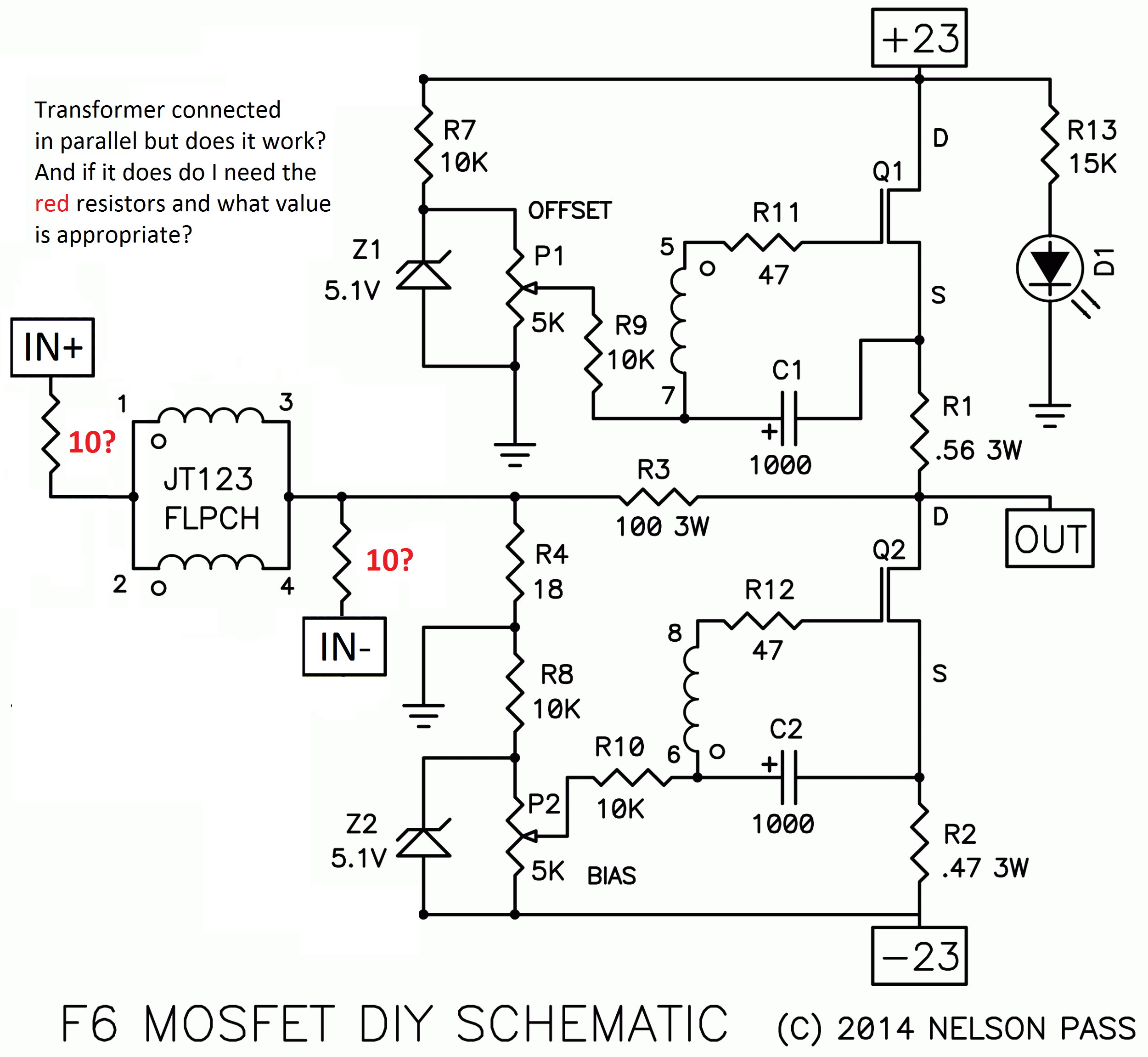

- Another option I think is to parallel connect the transformer but add a negative input at the other side. The question here is about the series resistors though. If I'm not mistaken I want them high as to not mess with the feedback loop but if I remember correctly they become my input impedance so I don't want to set them too high.

It's messy.
Thanks for answering, single ended input or less gain it is.

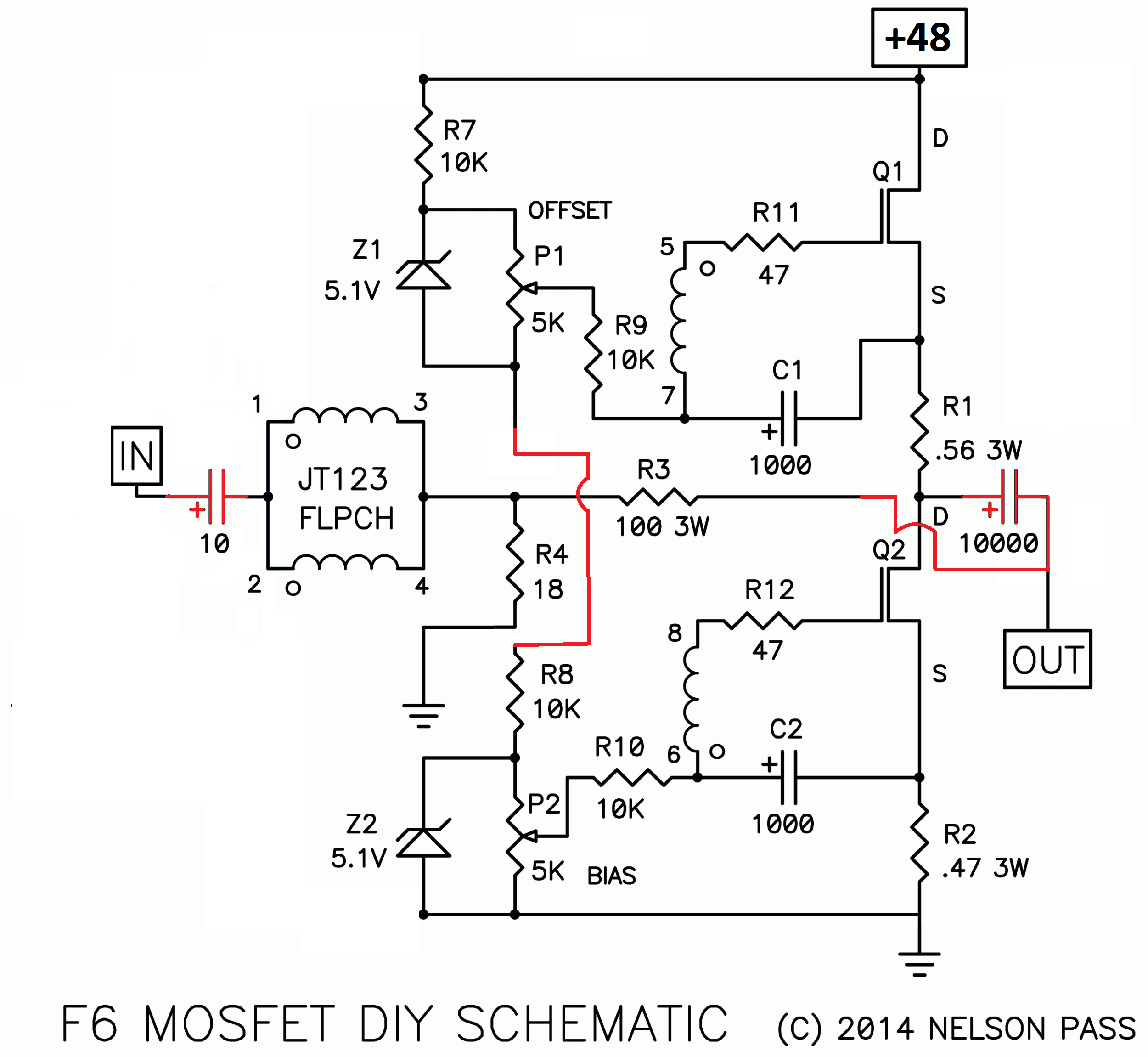

One issue though is that I do not have dual 24V supplies but I do have a single 48V. So My proposed solution to use a single supply is:
I'm pretty sure my DACs (Hypex DLCP) do not have DC on the output so I might omit the input cap. Though on second thought I'm not sure it would matter even if it did as it is a transformer.

you can use so called Quad trick ,for making bipolar supply from unipolar
look at Quad 606 schematic
Interesting, that schematic helped me find the virtual ground for power amps thread.

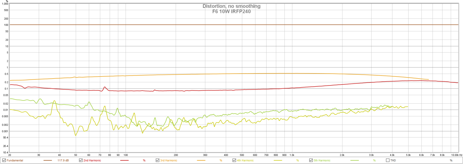

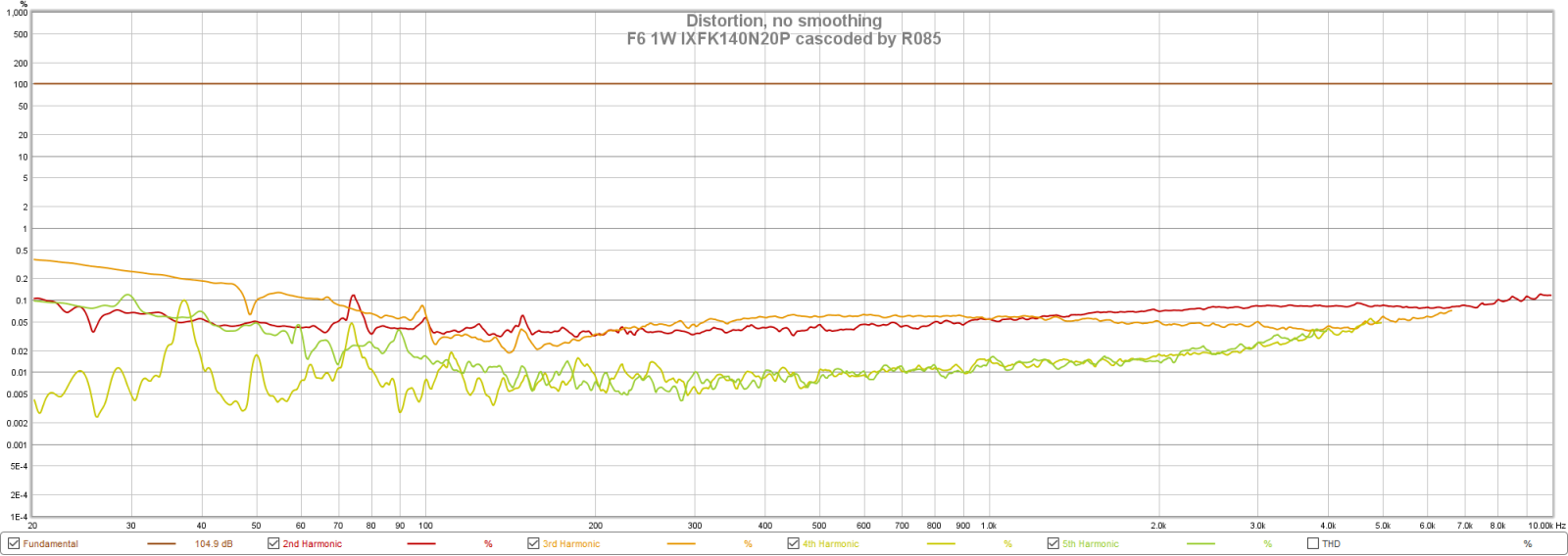

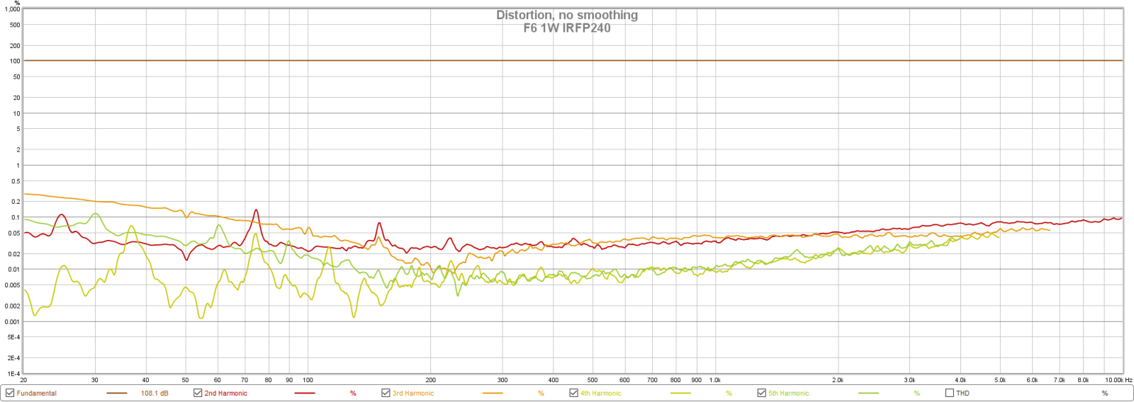

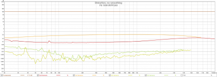

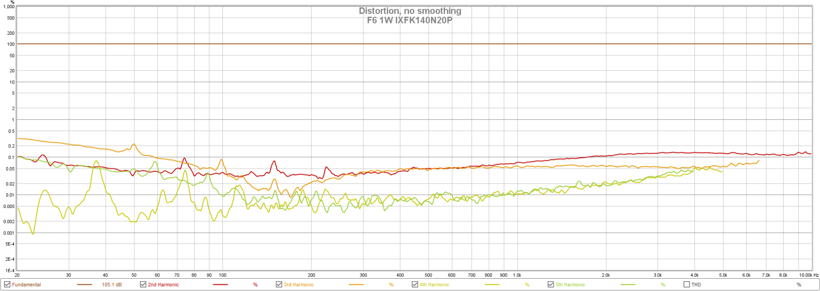

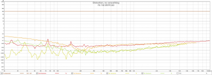

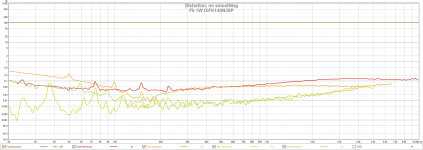

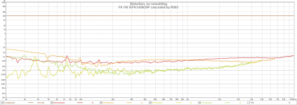

I have now tried an F6 with IXFH220N06T3, IRFP240 and IXFK140N20P (pretty much the BAF2015 Schade amps IXFN140N20P but in a cheaper plastic package)
No resistor changes apart from having it cap coupled as I only have a single supply and a resistor from bottom of R1 to bottom of P1 so that Q1 biases up nicely. I put 10k but in hindsight I believe you could simply short it as I the feedback loop was separate on my amp.
The IXFH220N06T3 didn't behave nicely at all. They say 440W @ 25c but in my experiments they are extremely fragile. When testing it in the F6 they broke when conducting 24V @ 1.4A. I've had other experimental amps and they broke in those setups too. The only kinda successful (as in not breaking) build I had was when I ran them at 5V @ 1.5A cascoded by a R085 running at 19V @ 1.5A but then I didn't measure even close to the monstrous transconductance I was hoping for. In a single ended setup with no degen I got ~ 35x gain where my R100 in the same setup got ~ 75x. So I have abandoned the IXFH220N06T3 at least for now.
So the IXFH220N06T3 is out, how about the others but with actual measurements? So here are some!
I believe the low frequency hiccups from the transformer is because my testing source is not... ideal. I had hoped that the line outs of my external sound card had sub 100 ohm output impedance but well... that was not to be It had over 10k so without a buffer it didn't work so well. I did get something workable when using the headphone output which sat at 50 ohms but those hiccups appeared. In the long run I'll do tests with my actual source (Hypex DLCP) which should perform better but these should do for now.
The IRFP240 seems to be a pretty good device in the F6. The beast mosfet derails at higher output which if I'd guess has something to do with that the capacitance falls apart when having less than 15-20V over the fets. So would probably need some extra care to work well but as the IRFP240 works perfectly in the F6 why bother?
