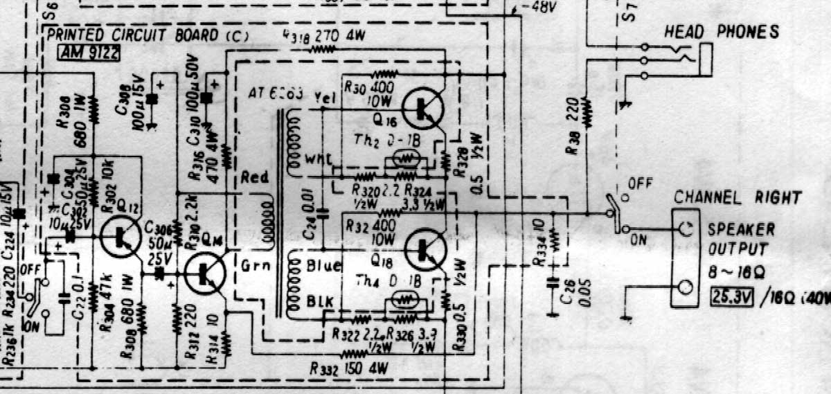

Added my own asymmetric mod.
I'll do my own listening test later. One channel is stock and the other is modified.
While I was at it, checked the noise at output, getting less than 100uV (averaging around 30uV to 50uV), based on the fact I have 4 times more capacitance than stock this seems correct.
