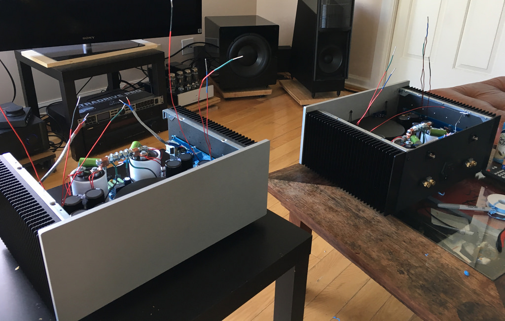

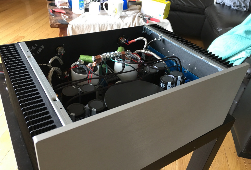

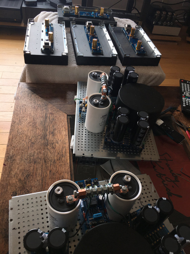

Just wrapped up 2 x F6 beasties. Excellent sounding even at break in~ 90% bias. Going to ramp them up today
Had some RIFA/Kemet PEH169 100,000uf caps that needed a home, and they got it.

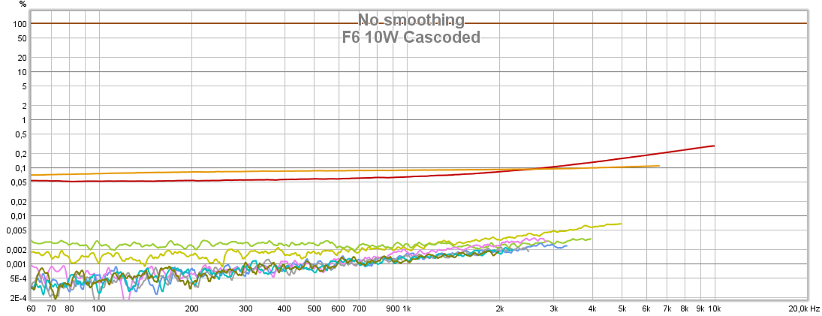

After playing some more I'll have to revert one of my previous statements:
Cascoding works magic, it more than halves the 3rd harmonic and reduces 5th harmonic almost down to nothing.
As I have my ground at 24V potential I used a cheap isolation transformer (FGA-40HQ) for my distortion measure input and the amp input from the sound card and it turns out that this transformer was pretty bad and added lots of distortion. After running the laptop on battery and bypassing the transformer I got great distortion numbers, as good as the stock F6 without cascoding and even better with.
I have better input transformers on the way, LL1540 which I hope will let me isolate but without a big distortion penalty.
I did measure output impedance with moderate feedback (0.56R to ground) and if the calculations are correct I end up with Zout ~ 200 ohm which is high enough for me to be satisfied.
That is if the following formula is the correct way to calculate it:
(Voltage@11.77Ω - Voltage@3.77Ω) / (Current@3.77Ω - Current@11.77Ω)

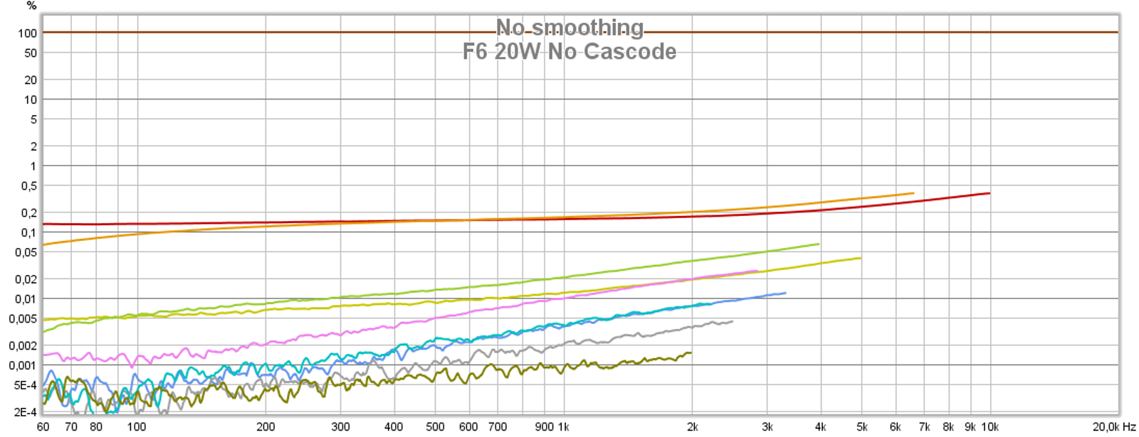

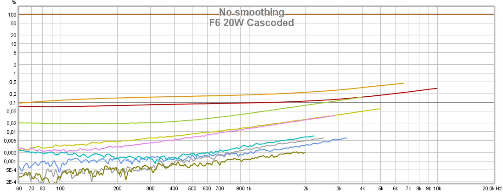

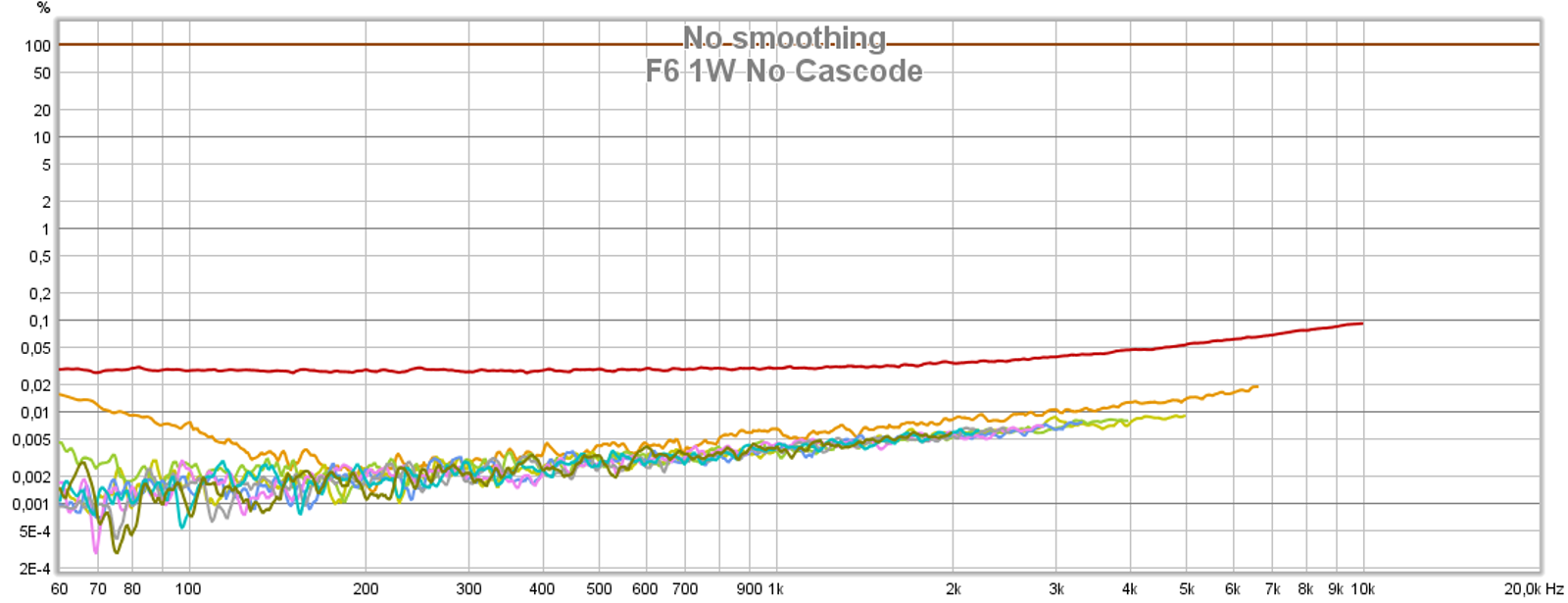

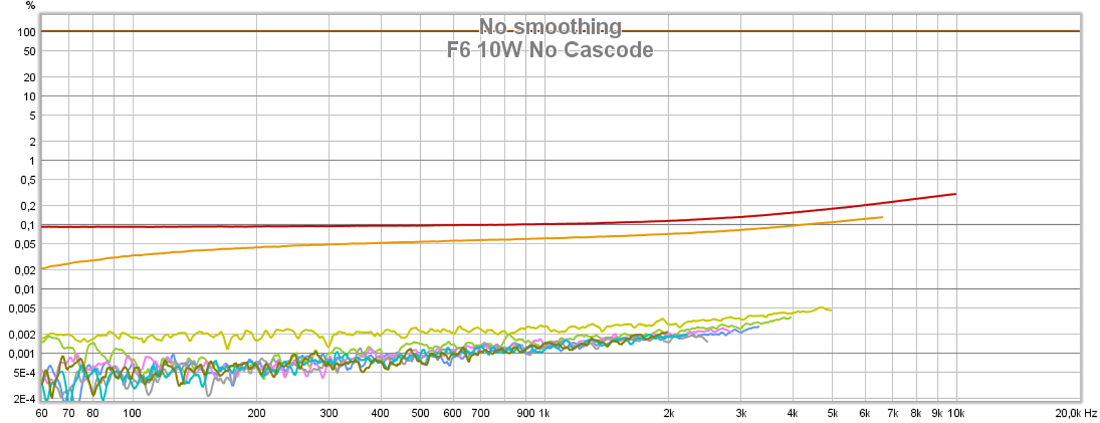

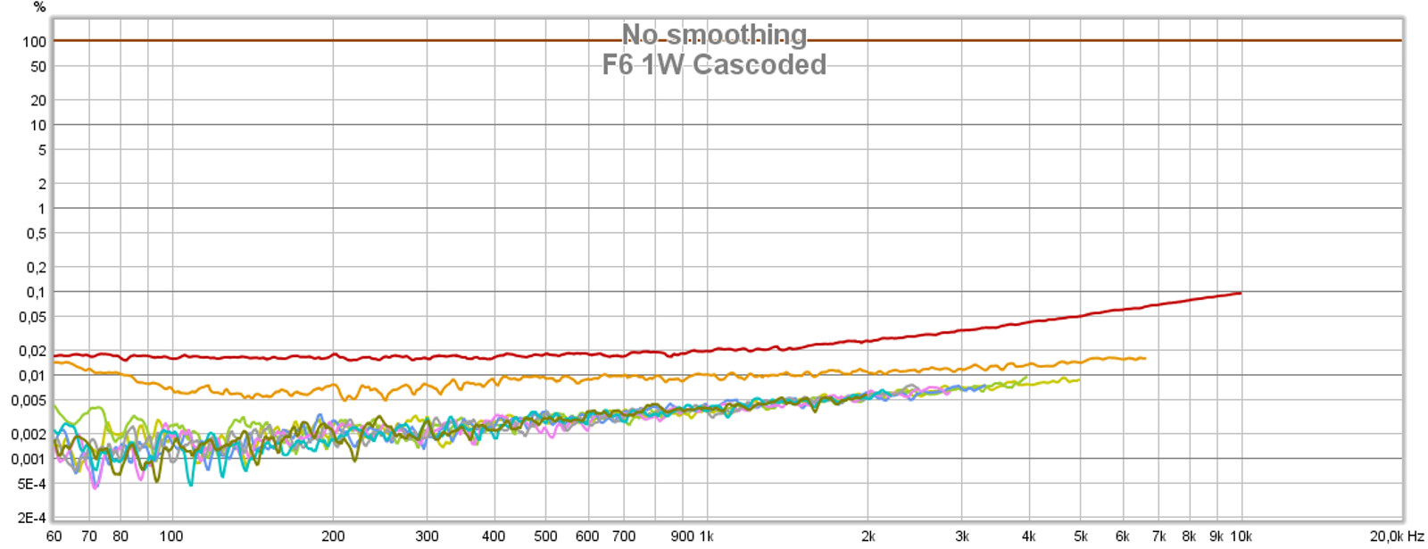

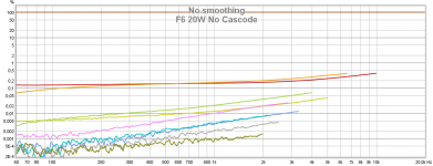

I now have data!
The LL1540 did solve all my problems. I now use wire them for +6 dB stepup at input which also converts the ground referenced input to my +24V virtual ground reference as my power supply is a grounded SMPS.
I set the feedback resistor at 1 ohm, and the current load is 3.8 ohm:
After looking at the data I'll have to revise my previous statement again... My current cascode setup does not improve distortion performance and so I'll do away with that.
The performance is great though so the only thing left is to combine everything into the final amplifier. I'll probably order new customized boards as they are currently a bit of a mess =)
EDIT:
Brown is fundamental.
2nd is Red
3rd is Orange
4th is Yellowish green
5th is Green
6th is Blue
7th is Pink
