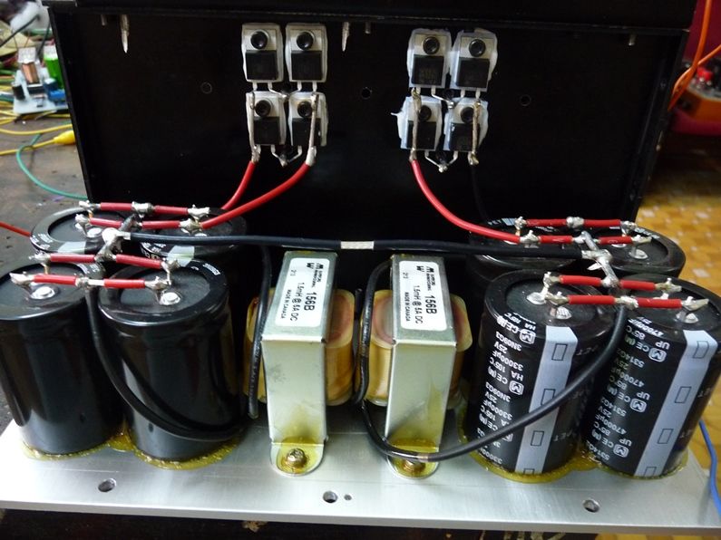

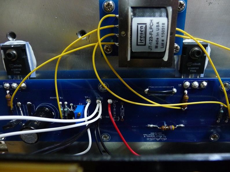

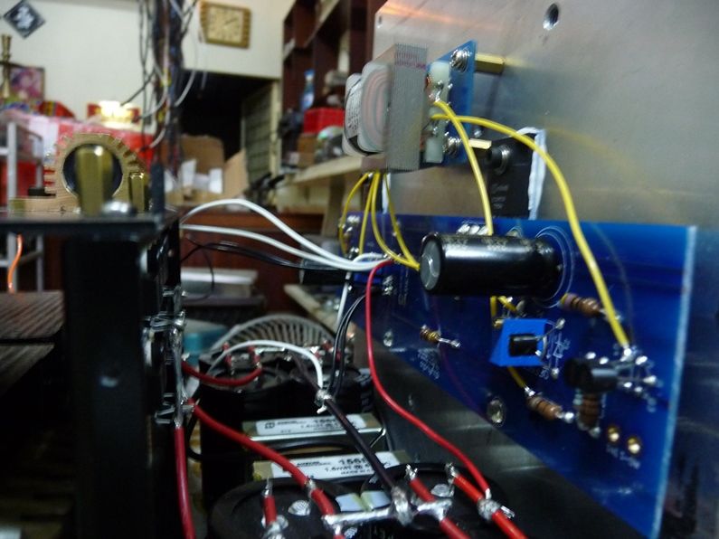

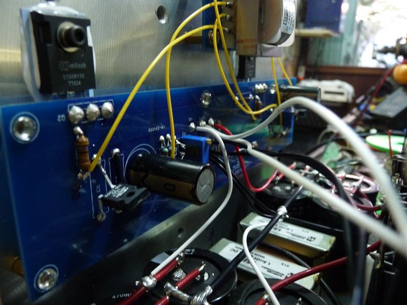

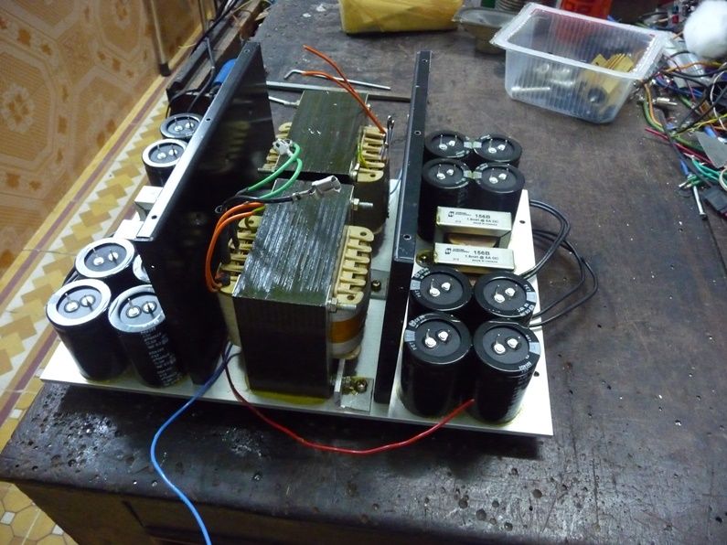

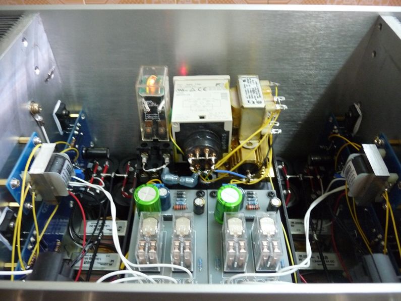

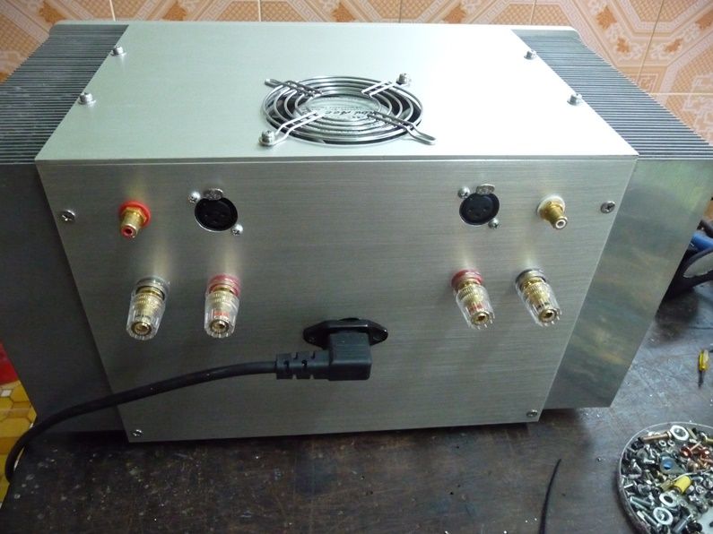

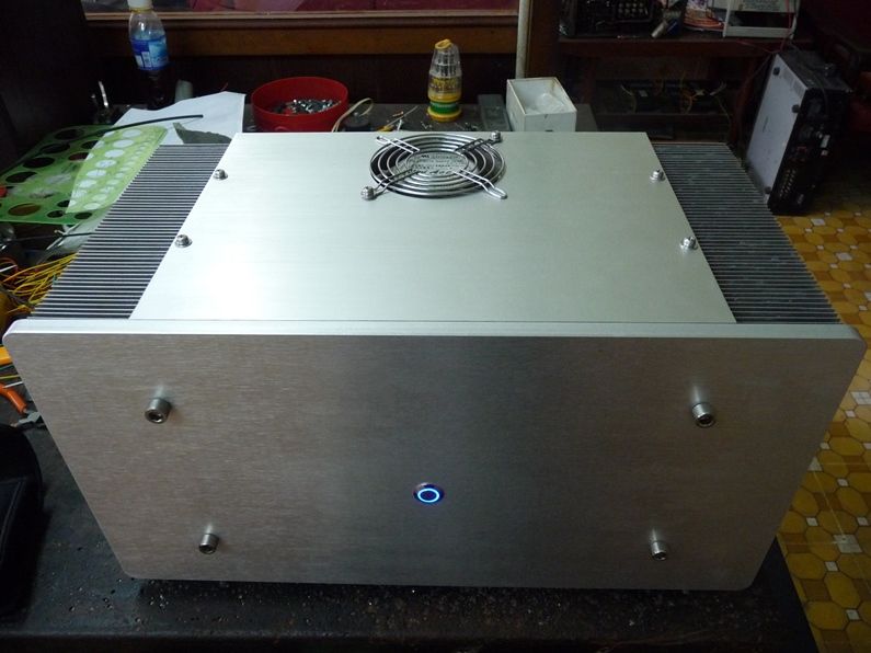

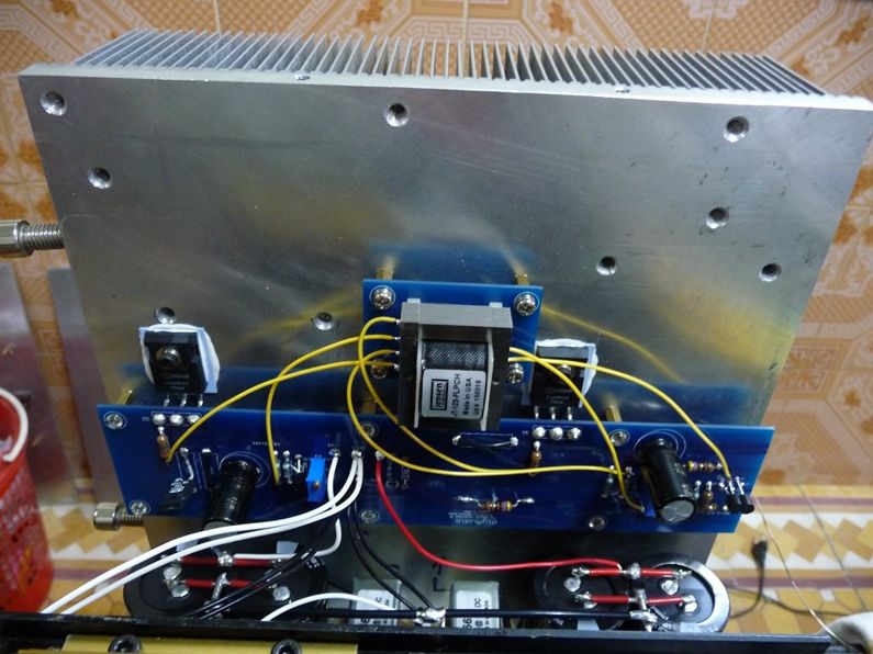

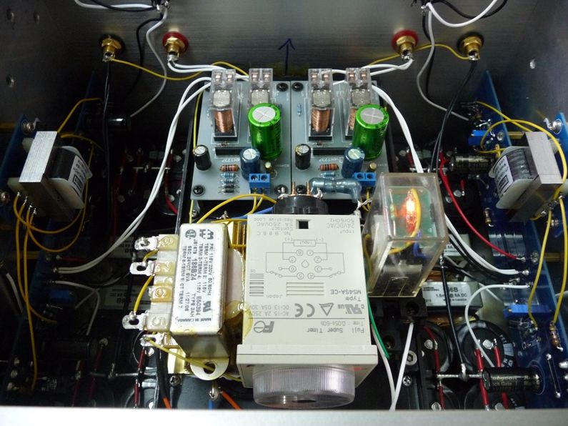

About one year ago, I built a F6 amp. I used the PCB from diyaudio with a little modify, unfortunately my heatsinks are too short so I must cut the PCBs and wiring interstage transformer
Some images to show and hope all of you like it!
About me, I always love these images because I built this amp at my old home that I was live for 31 years
Nicely assembled . nice workmanship
Immediate impression is the Helluvalot of additional Complexity tho.
Imo it seemingly goes against the KISS basis of the design.
As pointless digression;
there are 'other' solutions to a too short Heatsink, beyond sawing off bits of the PCB...
remembering that Only the irfp240's needs be on the sink

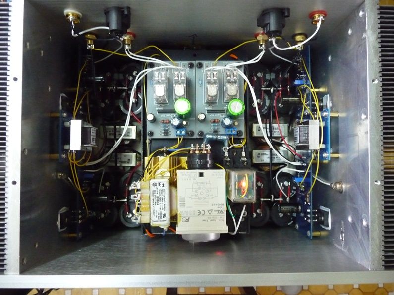

I think he has speaker protection and soft start in there. Maybe he has speakers he wants to protect?

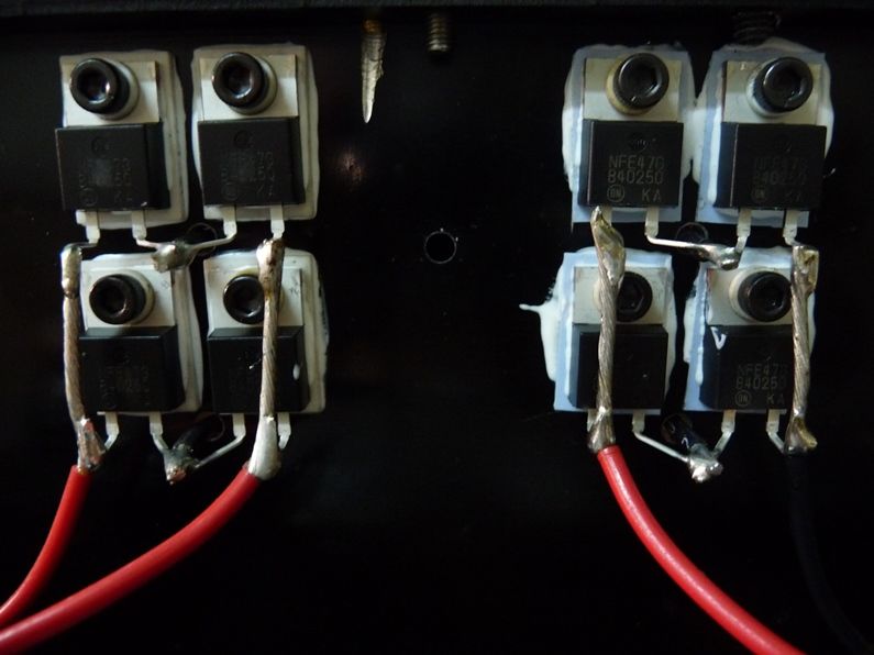

I must fix the chassic with the heatsink so my chassic size is not good and of course the mica insulator is better blue insulator
The amp running very hot so the fan is necessary
Beautiful chassis work, but also very densely populated internally. Ample vents on the bottom to draw in cool air under the toasty bits?
BK
Yes, you right! The bottom is so close, I can not drill some holes for air flowBeautiful chassis work, but also very densely populated internally. Ample vents on the bottom to draw in cool air under the toasty bits?
BK

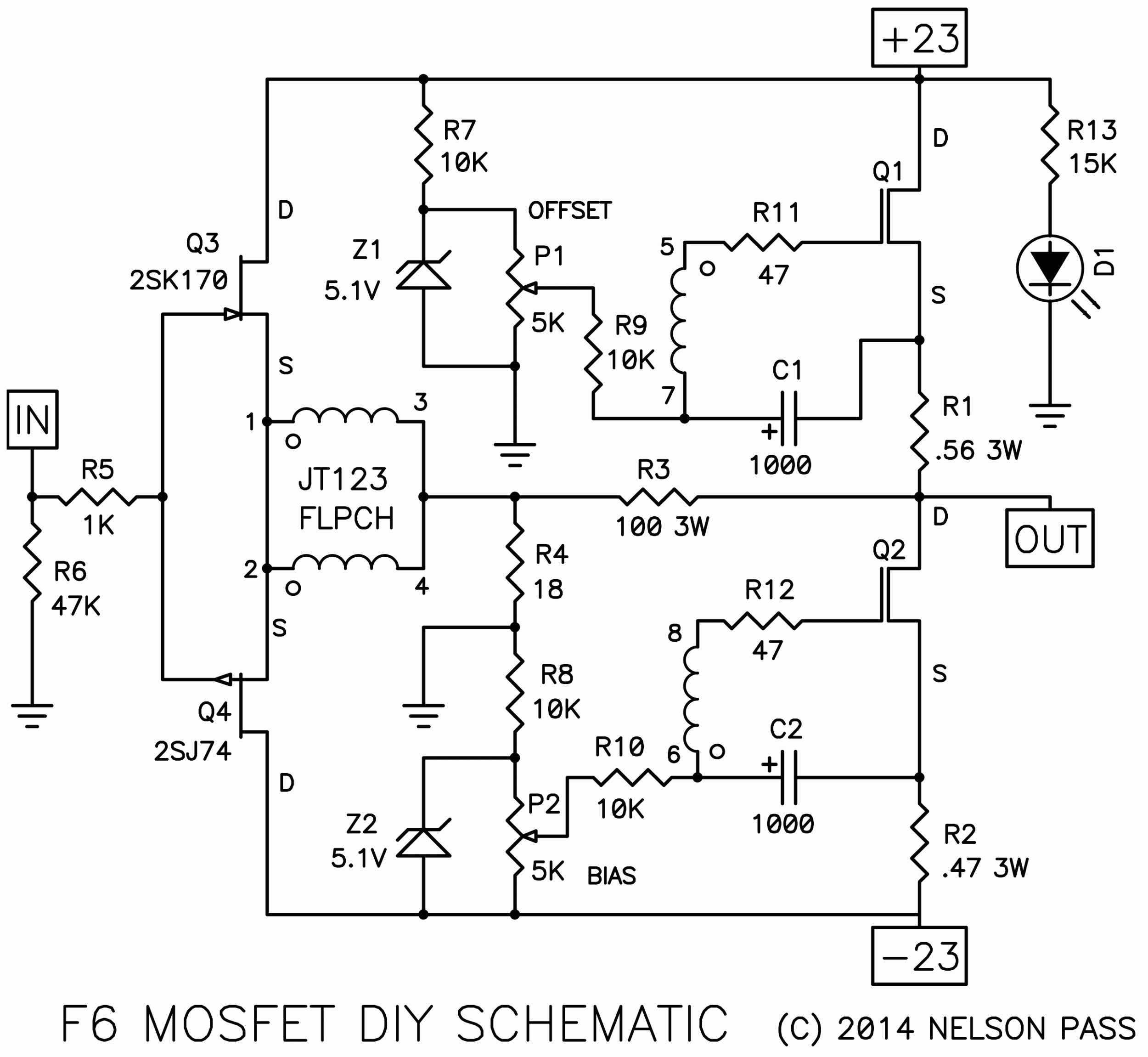

Q2 2SK170BL or LSK170B
Q3 2SJ74BL or LSJ74B
(This circuit will benefit from the input Jfets having a similar Idss, but don’t obsess about getting matches down to 3 decimal points — within 10% is more than good enough.)
If they need to be within 2,5 - 6,5mA range (LSK170A) or more i dont know through?
