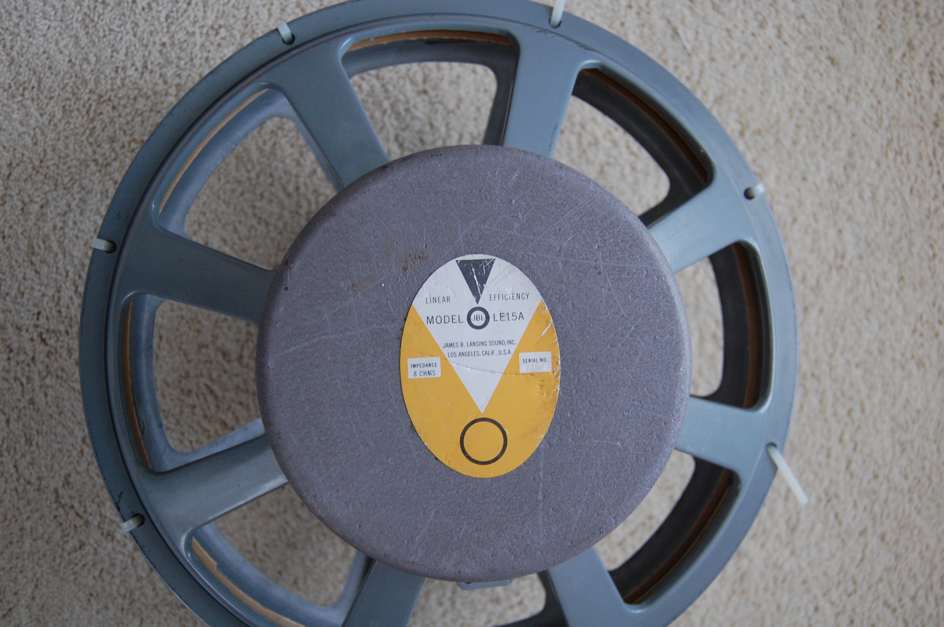

Not going to fail due to lack of options.
THese have those cool clear phragms
