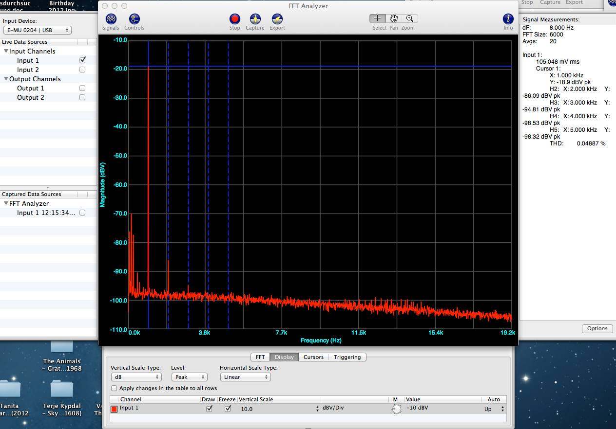

hello F6 sleeve 13 fans.....:)
I am not really good in distortion measurement (dsdjoy is much better) but astonishing at 8 Ohm and 1 Watt and Jensen I have with my Frankenstein 6 build besides k2 and a bit k3 nearly no higher harmonics, I did not see this often.......:p
