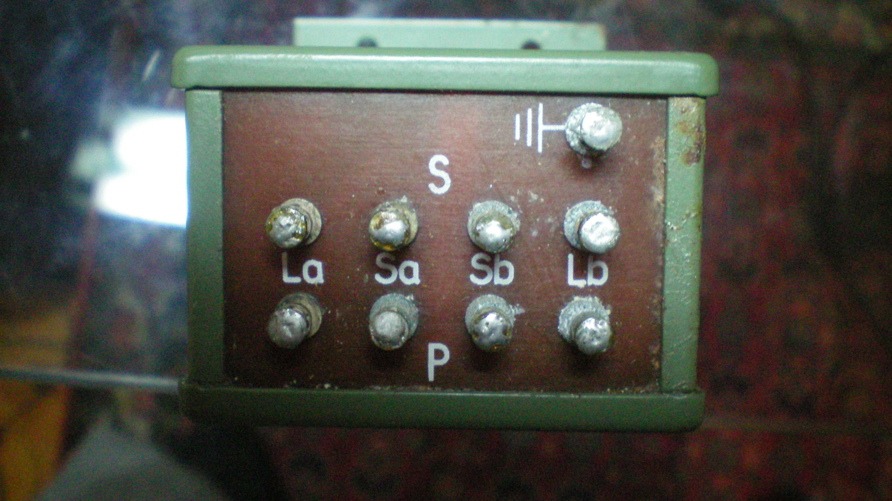

Zen Mod at the moment I get a heavy oscillation using the ISKRA.
I thought I was clever enough to wire it up in the right way after the Jensen and the Edcor..... unfortunately not.
could you mark me the pins according to Jensen and sleeve 13..please.
oscillation was so heavy that the whole house was rocking....:D
you got positive feedback ,obviously
will search for data in PC and post

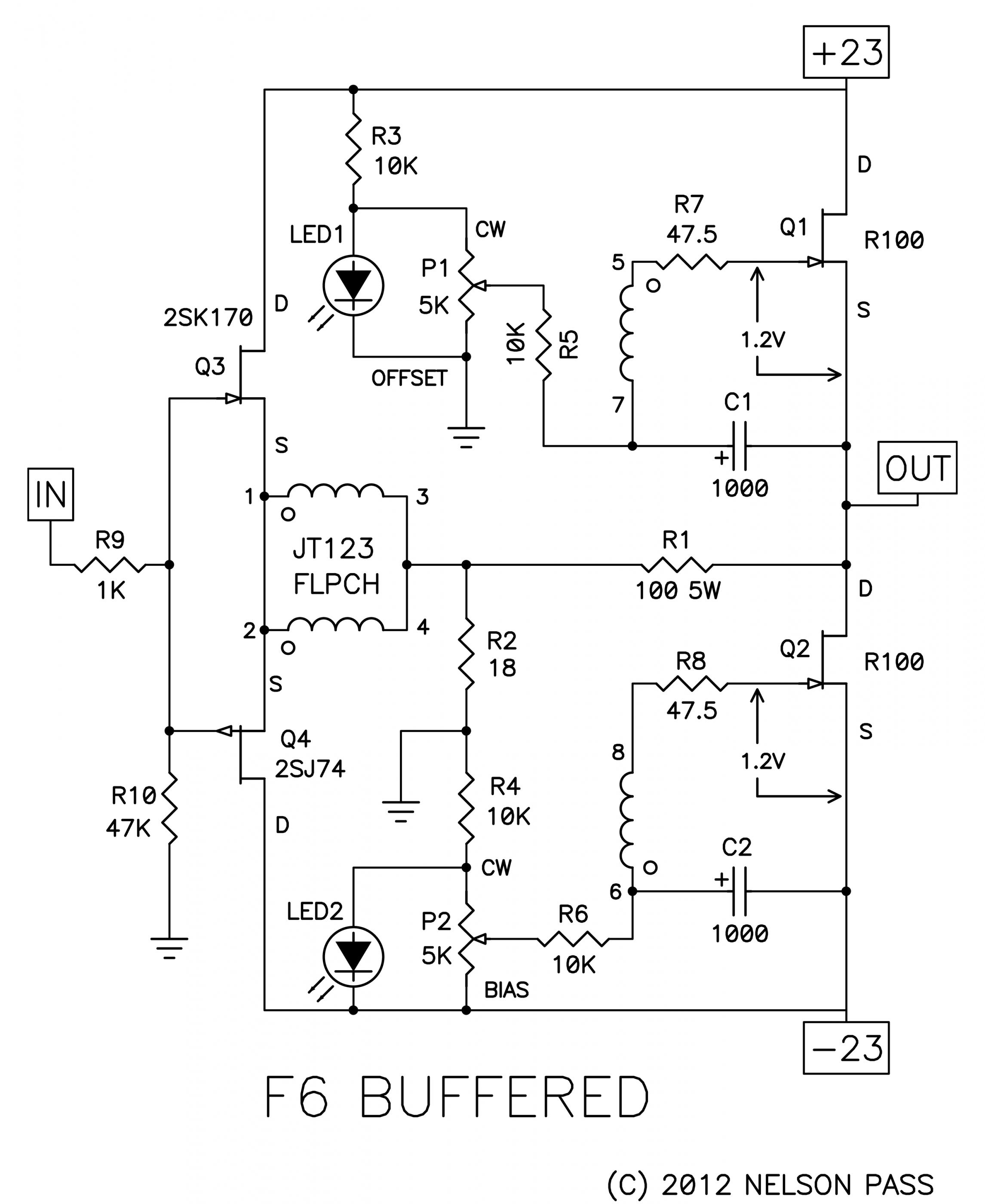

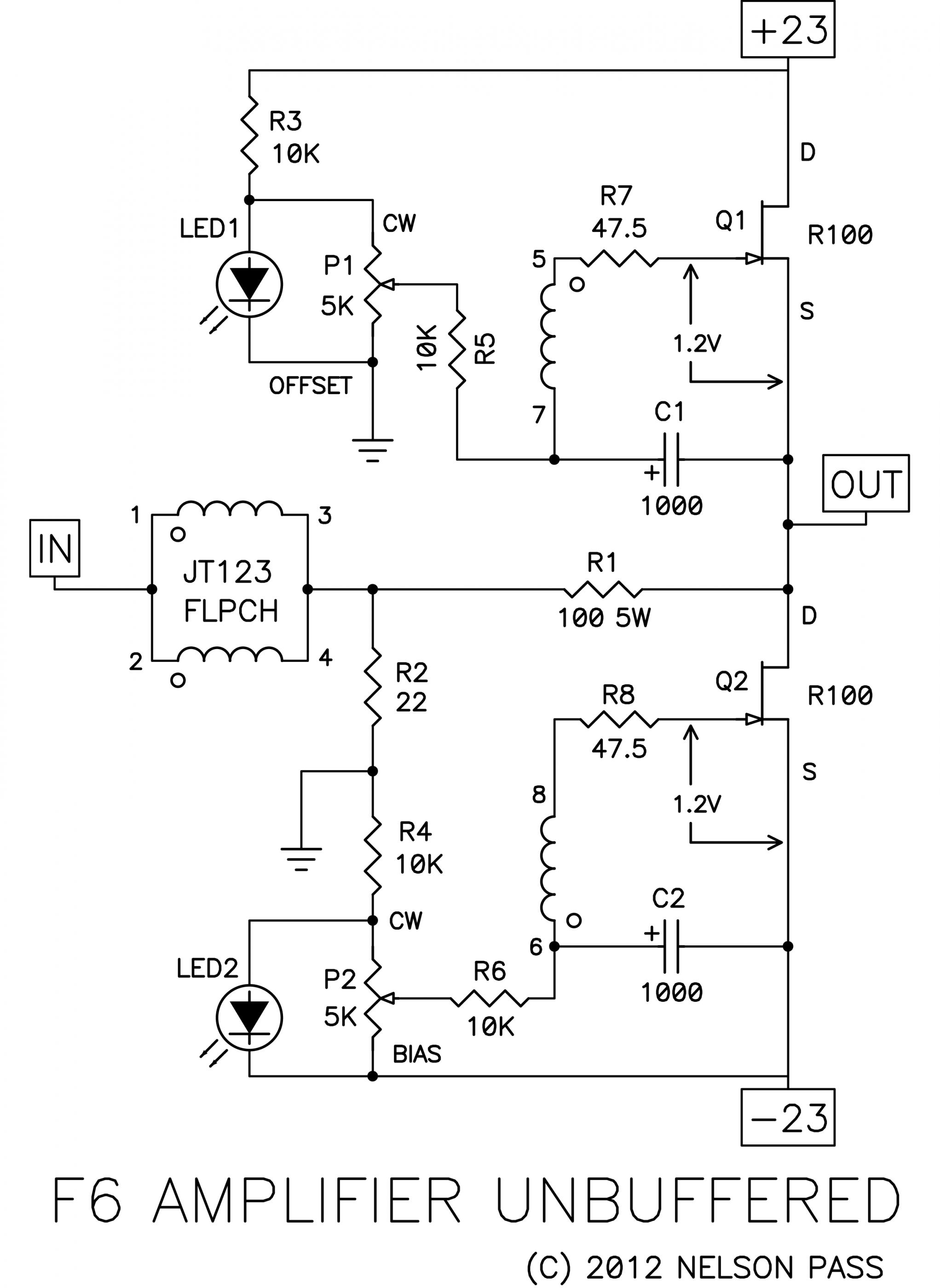

Now that the cat's out of the bag via BAF, here is the official F6 schematic.
There are several versions, but I am building 10 channels of this for in-house
use. There is a version without the input buffer, and a couple of versions
showing degeneration on the input devices and degeneration on the outputs,
which I have not chosen to use.
:cool:

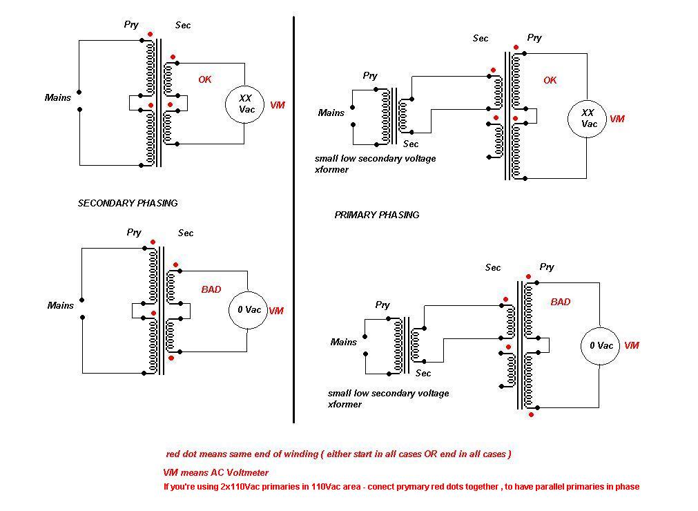

Generg , I don't have data in this pc for those repeaters
anyway - make like this :
P means primary , S means secondary
on P side , solder together ( brucke ) La pin with Sb pin ; same - Sa with Lb ;
now your primary is La-Sa , and say that La is having punkt ( use marker for that)
one secondary is La-Sa , another one is Sb-Lb
now connect sig gene (1-2Vac is enough) to primary , observe sig with scope first on primary , then on each secondary , trying to orient scope probe ( hot and gnd of it ) to have same phase as on primary
when you have that , just mark hot pin of secondary with marker
if you don't have scope near you , there is another way of doing it
edit - when you finish this , write back for exact pinout , if needed
little info , for different purposes , but useful
I drew that few months ago for some greenhorns

For those who have not suffered the audio file, the question will arise about
the degeneration.
a) Like with regular feedback, I use it only when it furthers my purpose
b) Undegenerated outputs on this circuit extend the class A region at the
specified bias by about 75% more.
