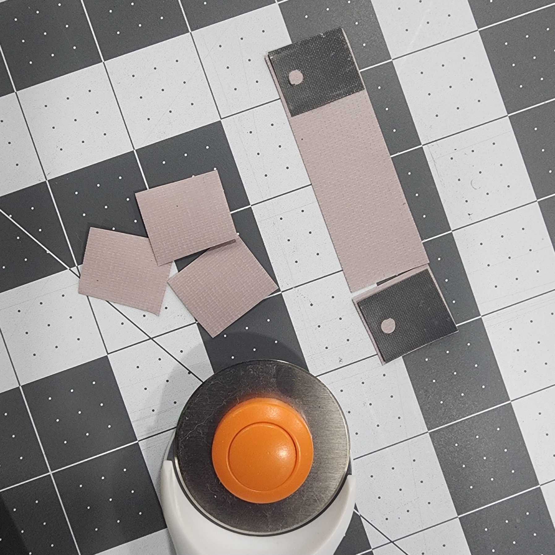

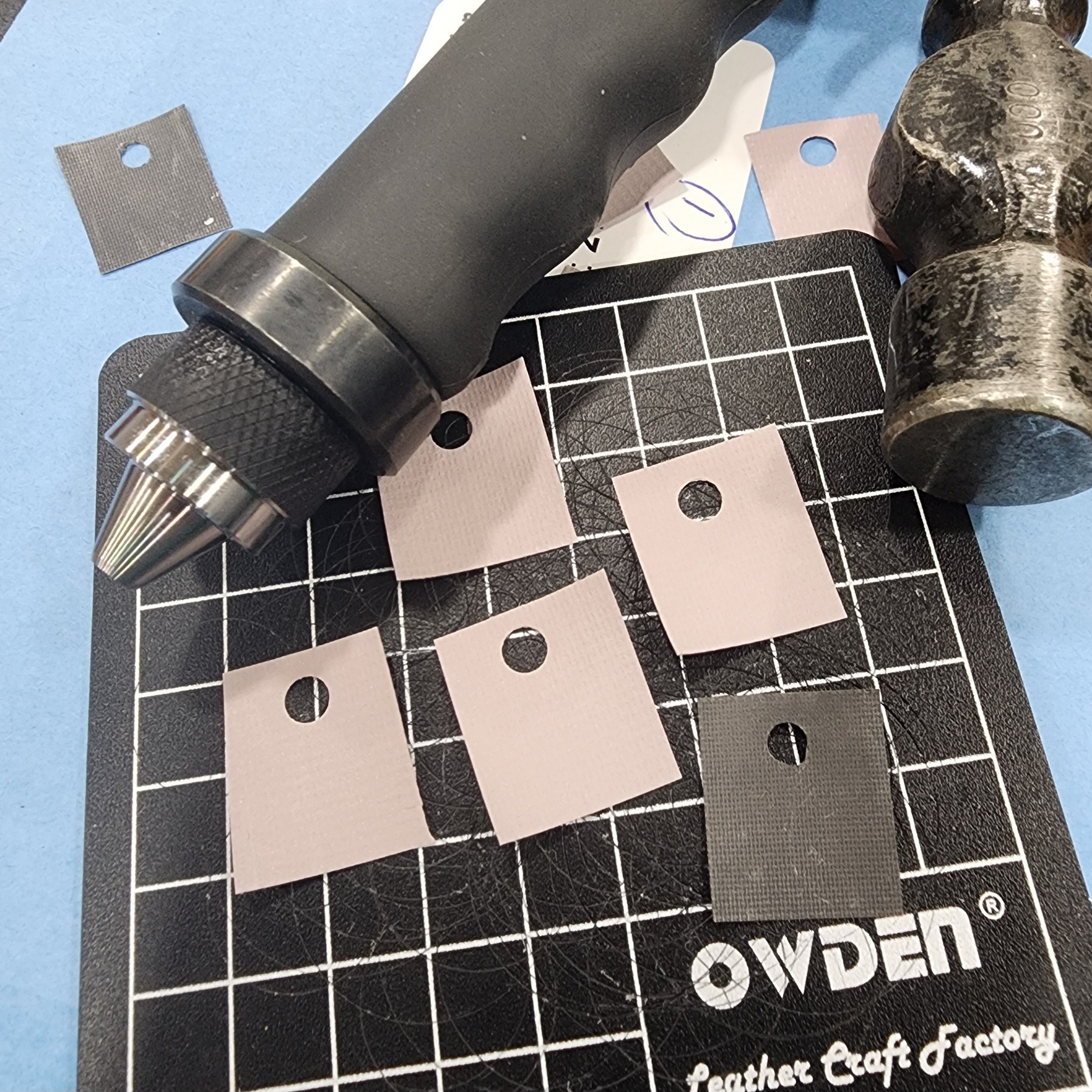

I tried out the suggestion @seventenths posted #931 (https://www.diyaudio.com/community/threads/f5m-kit.408290/post-7635258) which was sourced on Amazon and it's confirmed legit Keratherm 86/82 0.25mm. I used a cutting board and hole punch to make up 4 replacements. Wasn't pretty, but I was going full "diy" mode at the time.
Just tossing out more options. Not a bad price overall. The 0.3mm 86/82 was cheaper still, but I didn't feel comfortable deviating from the standard thickness as I have no clue what I'm doing most of the time.
