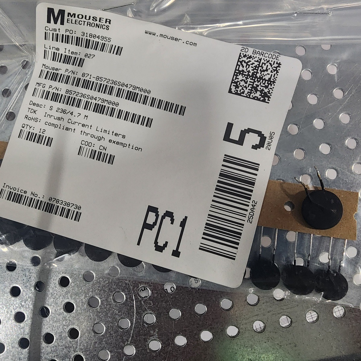

Got the 4.7ohm thermisters this evening. Desoldered the three 10ohm thermistors on the power supply board and soldered on the 4.7ohm.
Also swapped the black thermal pads for Keratherm 86/82 0.25mm. I'm leaving the bias at 1.7A for now as it's sounds good and temps were steady between 48-50°C.
Back to playing glorious 🎶 music 🎶 again!

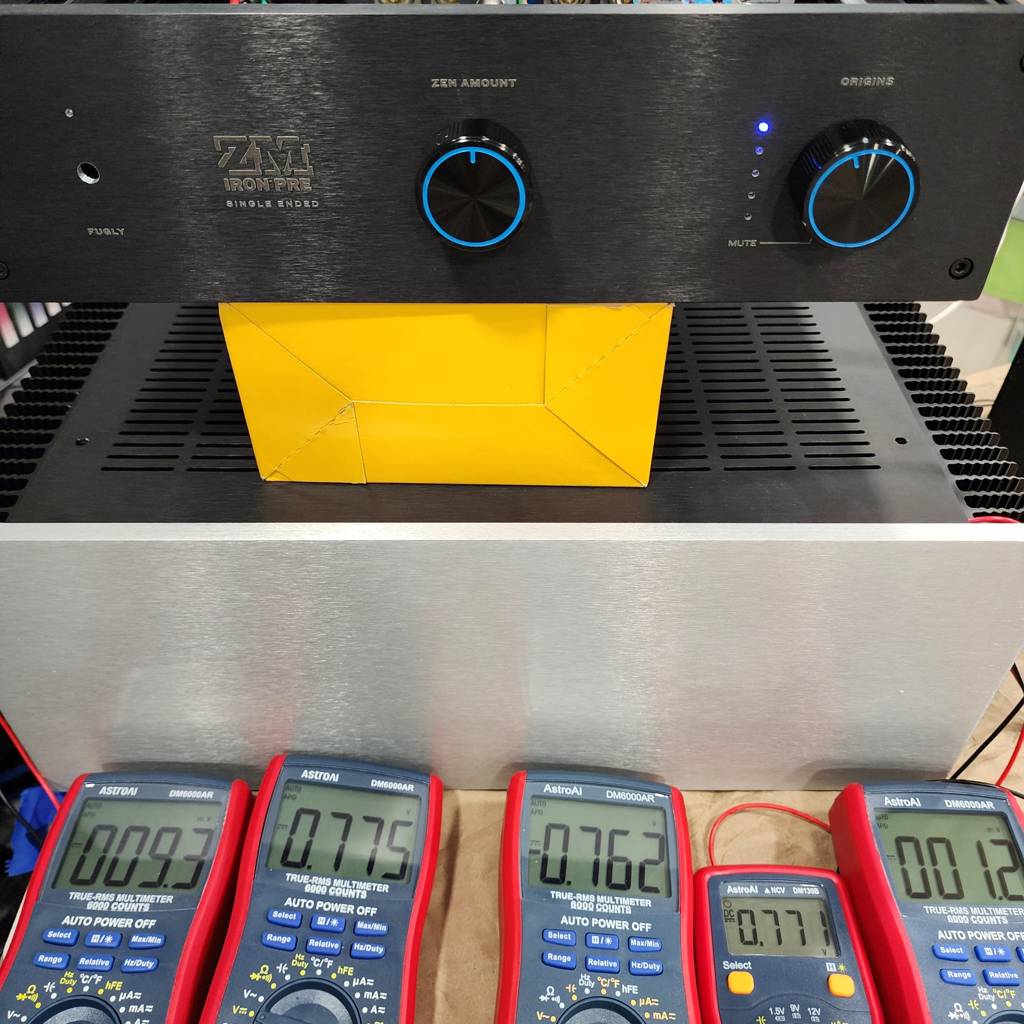

Just to share and possibly help newer folks (like me) building and biasing this Firstwatt design who maybe read my comment above regarding leaving bias at 1.7A and thought, "Is more bias better?"...I have now dialed my F5m back to closer to 1.6A (0.75V across 0.47ohm resistor). I had noted after about 3 hours of playing music at the original potentiometer(s) bias settingposition, the measured bias had risen up closer to 1.75A and I was now getting 55°C on my heat sinks. Since my house is currently in the low 60's °F for room temperature, I felt I should provide more margin for the heats sinks for warmer room temps that summer will bring. At 1.6A bias, I'm back down to 50°C on the heat sinks of the 4U/300 chassis. I may dial it back further in the future. From a listening point of view, I couldn't tell a difference between 1.7A and 1.6A bias. Both sound wonderful and the high frequencies are exceptional on this amp.
I feel I can't say thank you enough, so "Thank you Papa!" for the wonderful gift of the F5m.
Left to right DMM readings...
Dc offset left [mVDC] / bias left [VDC]/ bias right [VDC] / bias right (second resistor) [VDC] / dc offset right [mVDC]

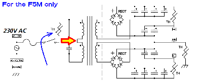

Wow! that's great stuff. I must admit I had assumed that such devices only come into play momentarily on start up and temperature wasn't an issue once up and running. Of course for cheapskates like me the third dimension in choosing components is whether you can use what you have already. I'm back where I started and feel ok with 2 CL60's in series for this.Not thrilled with CL-60 inrush limiter in USA/160W Class A First Watt
If you're looking for the message in this thread which suggested inrush current limiter disc part numbers, to install in the primary windings of the two Antek transformers which Nelson Pass's .pdf design guide specifically recommends for the F5m, it's post #501. This thumbnail shows one attachment to that post, it may look familiar. The other two ICLs, on the secondary side of the transformer, are not discussed in #501.

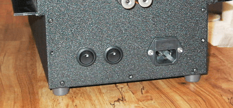

I'm going with a CL-80 (47 ohms) in the primary for my rebuild. I have a second switch I throw after the thermistor squashes the inrush (a few seconds). The second switch simply shorts the thermistor out. Taking that guy out of play after he's done his job. It's silly, dumb, lame, odd, out of the norm, etc... but that simple setup has been reliable for almost twenty years now. No loss of mains voltage and eliminates a hot running part. No additional "soft start" supplemental pcb's / timed relays or anything. And forgetting to hit the switch is no big deal.
After twenty years of practice I've gotten pretty good at turning off both... but ya you're right.don't forget to shut that switch off
That's a really simple solution @william2001 . Made me think of what could be done to avoid the one risk...
What if the switch on the inrush thermister was momentary, and when it's pressed in, current flows through the thermister, but once released, the switch automatically returns to the "bypassed" state taking the thermister out of the circuit, and then, you make a safety mechanism (think protected switch) that will only allow you access to the on/off power switch if the momentary switch is pressed in (flipping up the guard depresses the momentary "un-bypass" switch). Or maybe just make the gaurd position itself the momentary switch that diverts current through the thermister. I might try this just for fun after being inspired by your approach. It's a bit of a bunny trail off topic, however, I liked the simplicity of your approach.

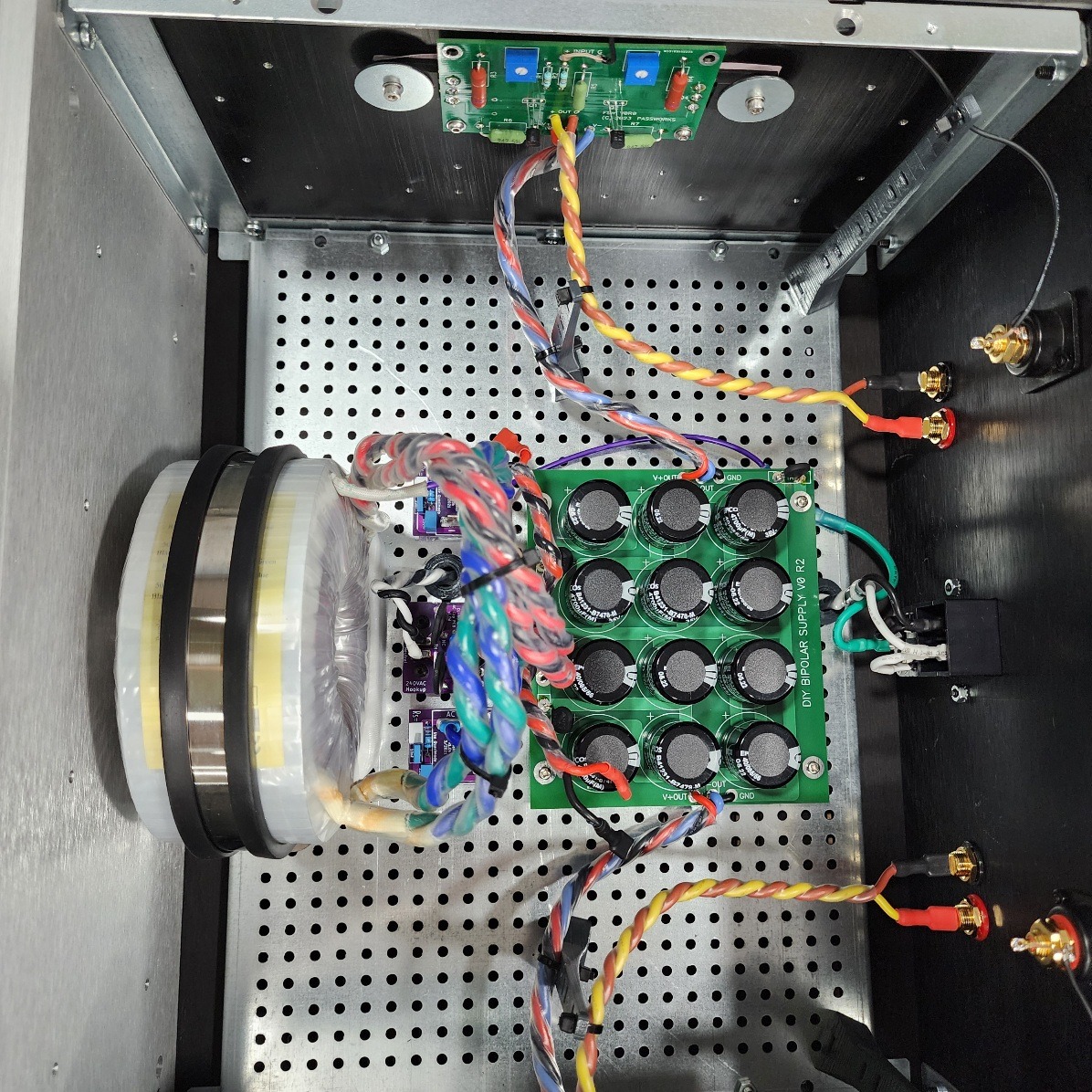

I am currently listening to my F5m with a recently completed upgrade to the power supply filters on each channel. Prior to this I was listening to a version of the Aleph J built with the simplified SS PCBs. And before that my F6 Diamond with the CineMag transformers..
All three of these amps sound more similar than different. They are all using high transconductance FETs in their output stage; some more so than others. My F5m and Aleph J SS now have very similar power supplies - a single transformer driving an enhanced Universal PS with separate motor run cap filtering in each channel.
The Aleph J has better rejection of the 120 Hz hum from the rectifiers. Once its motor run caps were in place, the imaging and soundstage were the equal of my best dual-mono build (the F6). Transparency was a revelation on some recordings. I needed extra time to find the right voicing to get just the right spectral balance. Obscure experimentation with Aleph coupling caps and tantalum film resistors, etc., nobody cares. But it became an amazing amp that I would happily live with indefinitely.
