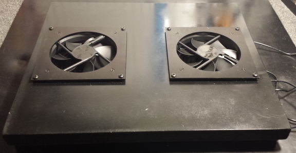

I had built a new cooling stand with fans on each side, 120 mm each, per ZM's suggestion, and the amplifier was sitting on the stand. The fans in the stand are not powered by the amplifier. I had inputs shorted and no load on speakers. The amp was biased at 0.8 A with relatively low temperatures - at least the heat sinks were not hot by any means.

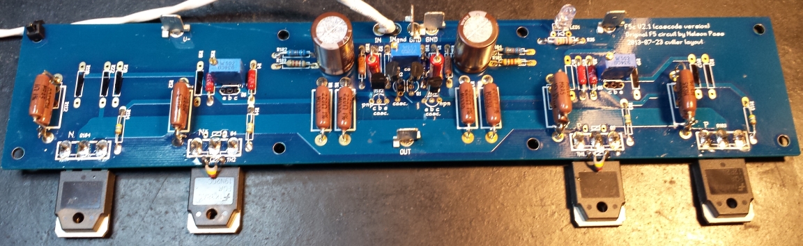

I'll put the scope on the PS boards in the next day or two, as well. I attached a photo of the L board, and can take detailed close-ups, but everything looks fine, even under the magnifying glass. The underside also looks fine.

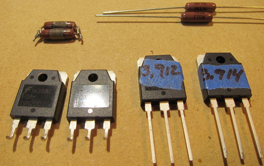

Removed both boards and removed all semiconductors this afternoon. I also removed the mica insulators and thermal compound from the sinks. I closely inspected all boards and tested each transistor.
Left Channel
1 P-channel MOSFET tests good with multimeter diode test (and appropriate switching on with charge to gate, and switching off with gate to source, etc.).
1 P-channel MOSFET is shorted.
2 N-channel MOSFETs are shorted.
All gate-stoppers test exactly 47 ohms.
All source resistors test normally.
Both bipolars test normal with diode tester.
Both JFETs test normal with ohm meter, and give identical values to those of new JFETs I compared them to.

Certainly, I will replace all MOSFETs on the left board.
1. Should I trust my JFET test, or should I simply replace the left board JFETs?
2. I plan to reuse the bipolars on the left. Any problem with this?
On the right board, the MOSFETs test normal, but I have extra.
3. Should I simply replace the MOSFETs on the right side and remove any possibility of a problem with them?
4. How about JFETs on the right? I have extra.

regarding the cooling... my suggestion is/was to make the platform sealed on at least 3 sides, foam was one way, this will permit more or less a pressurized compartment between the fan exit and the bottom of the chassis. This will force air through the bottom panel just fine, regardless of where the fan is positioned.

The current fan locations appear to be fine, and I'll post a photo later. The foam option for creating a seal between the bottom of the amp and the cooling board, on first impression, makes me a bit nervous - I would think air flow could be impaired in the event of a fan failure, which would not necessarily be recognized.

All of these were done with the amplifier sitting on the new cooling stand with dual fans, as suggested by Zen Mod. These are 5VDC fans with 50 ohm resistance, each, wired in parallel. The stand is 16 inches wide, 14 inches deep, and 1 inch thick with feet that are 7/8 inch tall. When operating, not only did air move into the amplifier, but I could feel some cool air coming up the sides of the amp (on the outside) across the heat sinks. A pleasant surprise. I grabbed a 25 ohm, 3 W rheostat and found that at 4 volts, cooling was still good, but fan noise all but disappeared adjacent to the amplifier. Thus, I will replace the rheostat with about a 5 or 6 ohm resistor in a small enclosure with a switch that will allow operation at 4 or 5 volts.
Biased at 0.8A, sitting on the cooling stand with fans running at 4 volts, and music playing loudly (just beyond class A) temperature measurements showed:

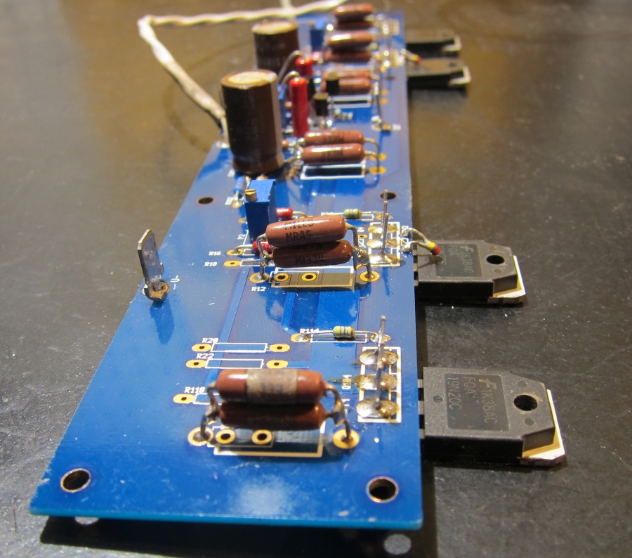

Back in post #104, and as described in the posts that followed it, 3 of 4 MOSFETs in the left channel had suddenly shorted. Zen suggested inconsistent MOSFET mounting or splinter residue. On replacing components, the MOSFETs seemed to be mounted just fine, there were no shorts between the MOSFETs and the heat sinks, and I didn’t see any obvious evidence of splinters or metal dust (from drilling).
Regardless, as described earlier in this thread, I replaced JFETs and MOSFETs in both boards and completely blew out and wiped down he entire amp. Everything appeared to be going well, and the amplifier sounded incredible and ran without problems for a several weeks. I then took it to a friend in another city. There it was installed on a home theater system. It received input from a preamp and was used to power front 8 ohm speakers. Sounded great and ran without problems for a few weeks.
Last week, while visiting to recheck bias a final time after about 4 weeks of use, I had the speakers attached and input cables attached from the preamp. The F5 was on, but the preamp was off. That is, no signal coming in and no output to speakers. I removed the input cable (RCA plug) to the R channel and there was a sudden puff of smoke from the R board instantly, and the fuse blew.
On inspection, as shown in the first photo, the source resistors (2 one-ohm 5 watt resistors in parallel) were discolored adjacent to the N-channel device on the end of the board, and the device was shorted between all leads. Other MOSFETs tested fine. I removed the board and the amplifier powered up fine with the L channel in place. I brought the board home with me for repairs.
I removed both N-channel devices and the source resistors on the end device. Only the MOSFET on the end was shorted and all source resistors, including the discolored ones, tested normal, but I chose to replace the dicolored ones, of course. I had a new matched N-channel MOSFETs as shown in the second photo.

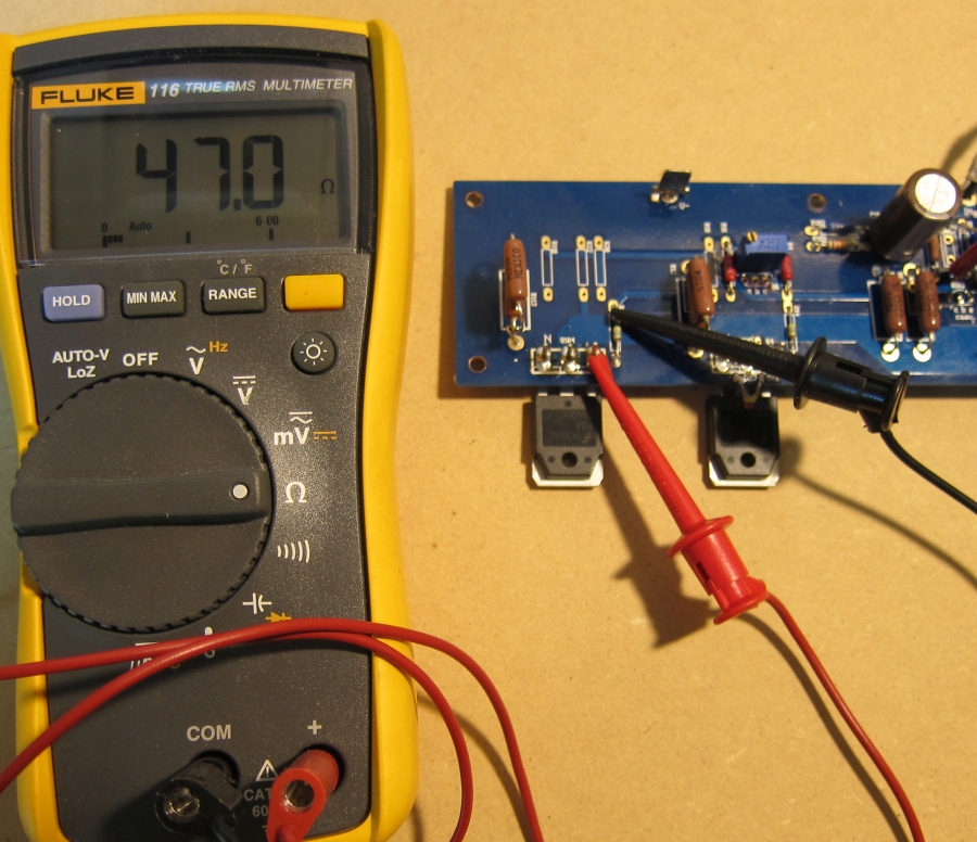

Gatestoppers all tested fine (photo).

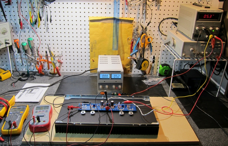

I installed the board on an extra heat sink I had and powered it up to between 5 and 22 V rails to be sure it would bias without shorts, and it behaved normally (photo).
So….what had happened? Bear pointed out that while the amplifier should be stable, some amps in the past have been famous for parasitic oscillation when cables are added or removed while powered up, and wondered if oscillation might be the case here. I had been afraid to mention the possiblity, but had wondered whether parasitic oscillation could have explained the first MOSFET failure given I saw no evidence for poor mounting or splinters. Again, I (we) didn’t know if oscillation was occurring, but I certainly took the possibility seriously. At higher rail voltages with 4 N-channel devices and 4 P-channel devices (and diodes) in the turbo V3, Nelson noted that he could detect some ringing at times and included an optional compensation cap between the output (drains) and just before the gatestoppers for the MOSFETs (one cap per board). These caps were found to be necessary for builds by, for example, 6L6. And various postings over the years have described increasing stability by increasing the resistance of the gatestoppers. 6L6 kindly reminded me that the cap in the version 3 turbo is 1 nF and the gatestoppers could be increased up to 680R (from 47R at present) without a significant change in sound. Bear provided some clear guidance on examining the amplifier with sine, triangle, and square waves to seek evidence of ringing, and noted that compensation caps smaller than 1 nF were commonly effective. I had put plenty of sine waves through the amp during the build, well into clipping, but had not examined triangle waves or square waves in much detail.
This weekend I hopped on a plane with the repaired board, a digital scope (trying to travel light), signal generator, power resistors, extra parts, 1 nF film caps, 680R resistors, meters, etc., and went to reinstall the board and examine the amplifier in more detail. I only lost a single needle-nosed pliers to the TSA agents (it was 7.5 inches long - measured with a ruler by the agent - and any "tool" over 7 inches must be confiscated.) No kidding. 7 inch pliers are harmless. 7.5 inch pliers are a threat.)
