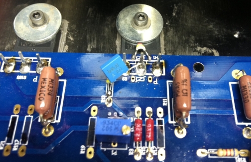

Heh, after the above comment I actually looked at the pix of the boards... seems odd to me, IF the blue box cap at the first right side mosfet is what you added?? What's the pinout on those mosfets anyhow, perhaps that is between the drain and the gate??

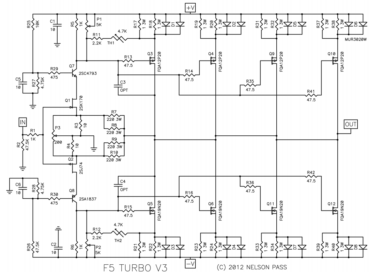

Where did NP say to put these caps??
I would have expected some smaller cap(s) between the drain and gate myself... in the 10s of pf range...
...the idea that this "worked" bears some more investigation, imo, if that's not the drain and gate. .
Papa puts it between gate driver (before gatestopper) and output, which shunts oscillation to output.
The toxic approach appears to be putting a capacitor in series with the internal gate capacitance and thus decreasing the capacitance from a oscillation perspective and thus pushing it up higher in frequency... but yes we need to think about this one. :D
Hi Christian,
The cap runs from just before the gatestopper to the drain (center lead, output) of the MOSFET. The angle of the closeup of the cap doesn't show this clearly in the low-resolution photo I posted. That is, the cap on a given board is placed on the N-channel devices at the location shown for C4 on the version 3 schematic (attached).

Got a 1 nF cap installed on the P-channel side of each board (example photo attached). So now each board has a cap from drain to just before the MOSFET gatestopper on a single N-channel MOSFET and a single P-channel MOSFET.
The amplifier sounds wonderful.
Next time I wander to the fine city where this amplifier resides and am taking luggage, I'll see if I can drag my analog scope, but will at least take my digital scope and signal generator and add some lower value caps in parallel to see if we can correct that final minimal overshoot, as suggested by Bear. Or I might increase the size of gatestoppers. We'll see and I'll report back then.
Thanks, everyone, for your expert advise.
