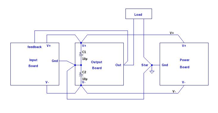

I have some concerns about noise in the multi-board F5 Turbo. The (potential) problem is the the output boards have a voltage gain of between 8 and 16 into a 4 ohm load. The Turbo kicks in, the gain gets even higher. The voltage gain is calculated as follows:
Vgain = Rload * N-fets * 1/(Rsource + 1/Gm)
where Rsource = .5 ohm, Gm approx 2S.
The problem is that any voltage difference between the power rails of the output boards and the input boards due to noise will be amplified by the output stage. The Burning Amp v2.0 doesn't have voltage gain, since the MOSFET outputs are voltage followers.
This means that extra care is required to avoid AC voltage drops. The power rail wiring must be done carefully. Capacitors C2 and C2 probably should be eliminated or on the output boards rather than the input board to eliminate ripple and noise currents running through the rail wiring to the input boards. I suggest something like the following sketch:

Yes,
I see your point, however, I would also imagine that any ripple would be a greater problem on the input stage.
It's not a big deal to add some cap positions on the ouput boards although it will mean running a ground connection that wasn't previously required.
