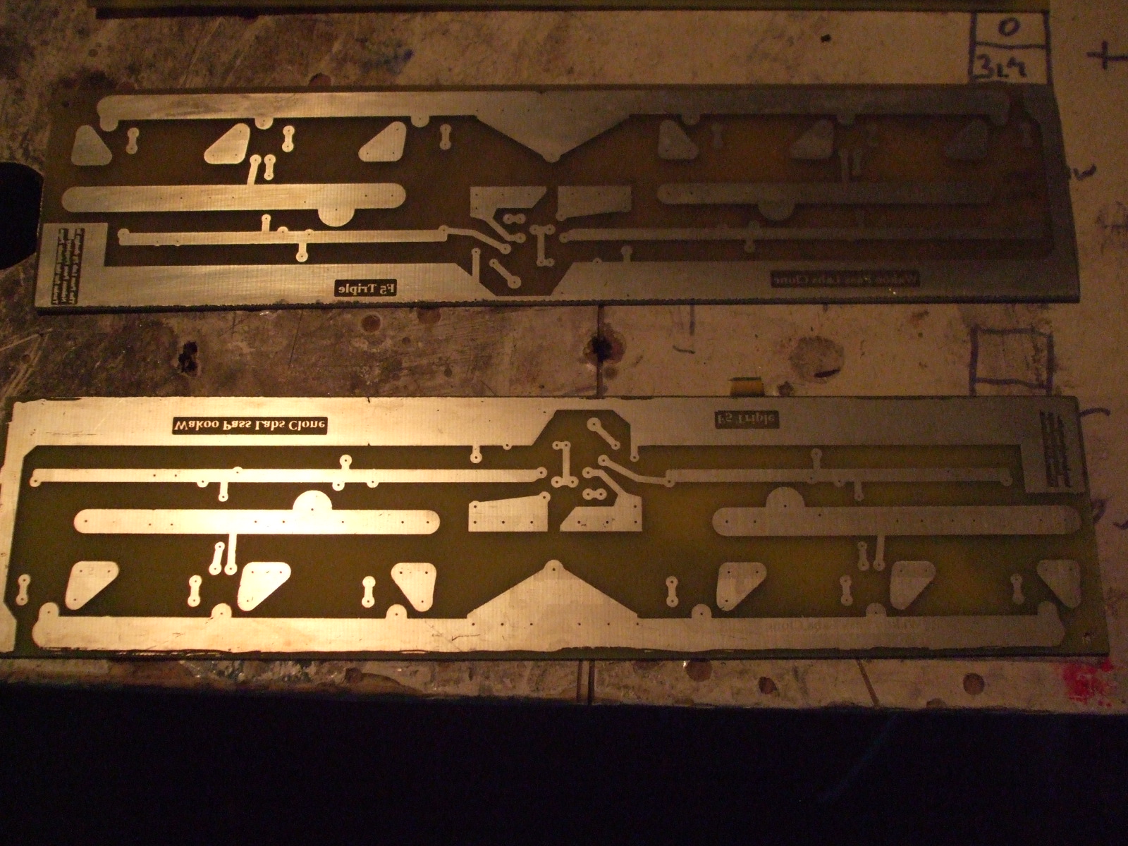

Maybe this help single sided duble mosfets cascoded duble imputs.
No current limiters space for 2 futabas source resistors
Sorry crapy picture was on MYF5 tread may see better there
At work at present but can do better tomorow if you like

Also from same tread
Triple not cascoded the first ones I built.
main thing is no need for duble side and Keep tracks shorth (this is a very fast amplifier and smal parasitic capacitance is a potential problem)
Gate resitor track as shorth as possible to the mosfet pin is realy good advice
