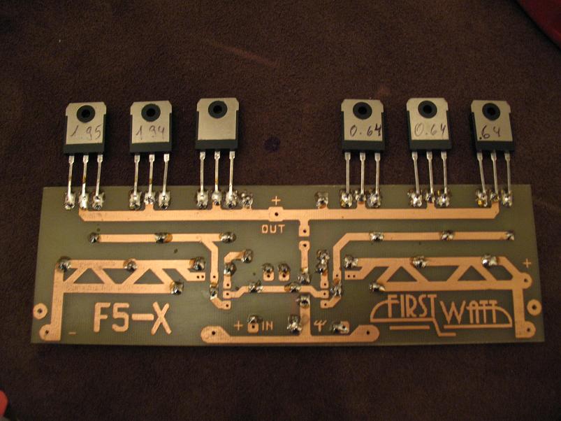

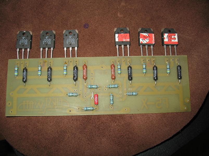

Hello
Can someone share the schematic, I'm interested on a stereo set with balanced input.
I want to see if these project will exide my knowledge .
I did started my own balanced version long time a go but I never finished or tested.
It would be great if I can see from that project what I can use here.
How you can see I spent $$$ on parts Toshiba transistors, Takman resistors 5W expensive resistors.
I have 4 board like that.
I would like to know how much a set PC board for a stereo amp with balanced or with out balanced input.
The schematic important to know if I can re use those parts.
I have more Toshiba transistors or I have IRFP to.
Can someone PM it to me. I promise I do not share it (or published) with nobody.
For these turbo version I would have a 1KVA transformer about 36 rail voltage.
Thank you
Greetings Gabor

The input boards are not suitable for the balanced version. In Nelson's schematic the feedback loops are not connected to ground but to each other. However, perhaps a jumper could be incorporated so that the centre pin of P3 could either go to ground or to the centre pin of P3 on the associated board. Or have I got it all wrong?

Chalk,
I'll have a look at that now
