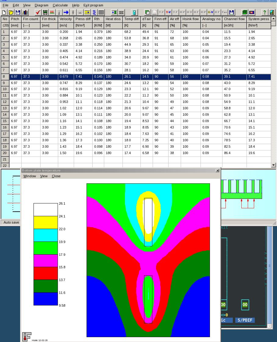

Sorry, somehow the attachment got lost. Try again
I agree, unless you use a fan.
Here is a simulation using a single HeatsinkUSA E007 12 inches long with an air velocity of .679 m/s. The table show results with other air velocities.

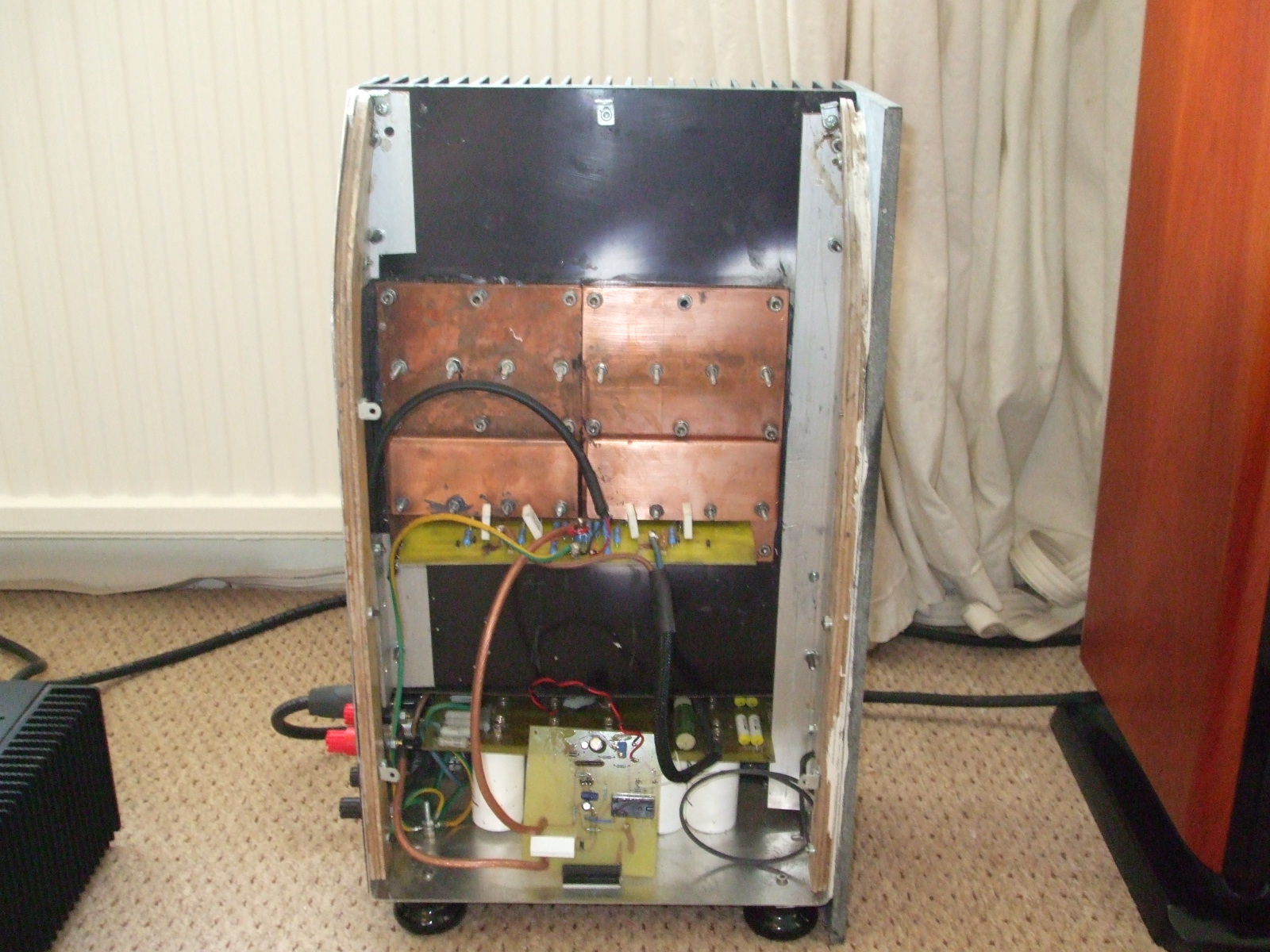

1. "Stock" Pass F5 design, standard bias levels
2. Conrad heatsinks
3. Two 120VAC fans, running at 65VAC for reduced speed and noise.
4. Airflow enters the chassis from the rear, flows through the open chassis plenum (cools the toroid, rectifiers, resistors), then UNDER the lower lip of the heatsink base, then UPWARD between the heatsink fins.
5. Airflow exits at top of amp
Outcome: heatsinks are cool to the touch..... (probably too cool). Works well.

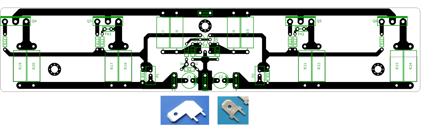

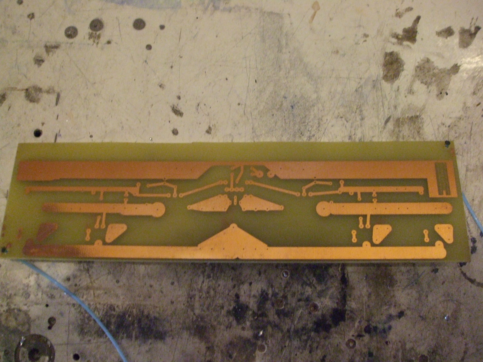

Finished drawn a F5 turbo V1 in single layer pcb. :p Can start playing the F5 turbo soon, hoping everything goes well! :)
Way to go
why not ad cascode (just a jumper to by pass) and make speaker out track
thicker.
