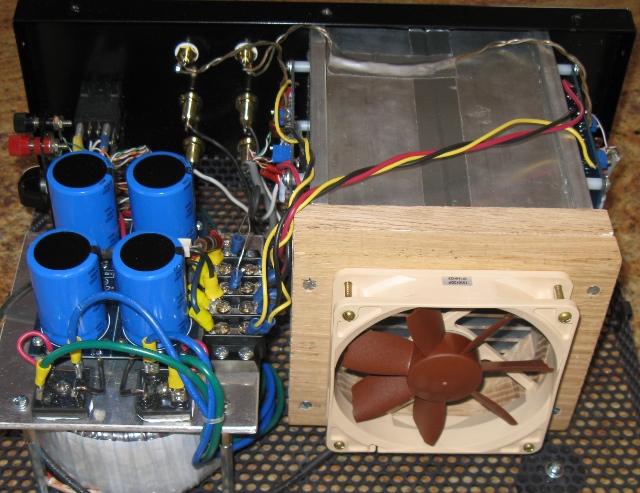

Measured Heatsink Performance
I made some temperature measurements of my F5 amplifier which uses 7" long HeatsinkUSA E007 heatsink. As shown in F5 Power Amplifier post 10205 http://www.diyaudio.com/forums/pass-labs/121228-f5-power-amplifier-1021.html#post2453420, the heasinks consists of a heat tunnel produced by connecting halves of the E007 heatsink. The heatsink is cooled with a Noctua NF-S12-B fan. The F5 amplifier has a standard bias current of 1.3A, resulting in about 62W per channel power dissipation.
Here are the temperature measurements:
22C Inlet air temperature
32C Heatsink near inlet and near mosfet
36C Heatsink near exhaust and near mosfet
14C/62W => R = .226 C/W for 1/2 E007
A full E007 would provide R = .113 which is enough for the F5-Turbo at 180 watts dissipation.

At 1.3 amps per channel, you will see idle heat dissipation of 62 watts. To keep the temperature rise of the heat sink to 20 deg C. above the ambient temperature, you will want a heat sink rated at about .6 deg C./watt for each transistor. An example of this would be a chunk of finned aluminum, with a series of 2” fins attached to an 8” by 6” base. You will need two per channel.
Inferring from this it's a safe bet to say that his sample heatsink, which is 48 square inches (120 square centimeters) is required for every transistor!!
So, our worst-case scenario F5 v3, biased fully class-A, with 8 transistors per channel, and then 16 in a stereo chassis, you come up with 768in^2, or 5.3 square feet (1.6 square meters) of heatsink required.
:eek::eek::eek::eek::eek::eek::eek::eek::eek::eek::eek::eek::eek:
So, a normal-looking, flat back heatsink, convection cooled is going to be staggeringly large. The heatsink profile will need to be much more complex. And probably fan-cooled.
Somebody please correct me if my back of the napkin calculations are incorrect.

100W continuous output power in 8 Ohm means 40V peak.
Add 5V for losses : 45V rails.
100W Class A in 8 Ohm means 2.5A bias.
With 45V rails : 225W output stage dissipation, of which the heatsinks will have to swallow ~220W.
But why full Class A ?
Bias to 25W in 8, the rest in AB : 110W for the heatsinks !
Still desire full Class A : go fan blown or build yourself a huge stereo power amp.
(me balanced X-files, 50W Class A, rest AB, 2 boards on 1 heatsink tunnel, with those pretty Noctua fans that Ihquam posted)
