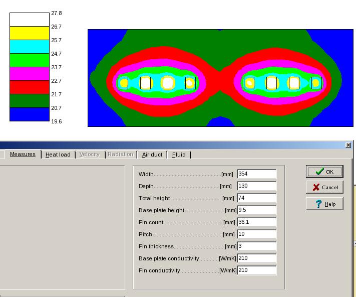

Does anybody has an idea about cooling this beast? It appears to require about a .14C/W per channel. I do not know where to find a convection cooled heatsink that can handle that much heat with the MOSFETS concentrated on a 12" board. Forced air (fans) can easily provide a factor of 3x improvement over convection.

I ran a NatSink convection simulation for the 400mm(W) x 83mm(H) x 200mm(L) heatsink with 8 MOSFETS dissipating 22 watts each. (400x83 appears to be the lowest C/W heatsink they make). The simulation shows a temperature rise of about 40C. Not good enough.

Here is a heatsink simulation based on using 1-1/2 HeatsinkUSA E007.
Unfortunately, HeatsinkUSA doesn't make anything wider than 256 mm, so I cut one E007 in half and weld it to a full E007 to make a 36 fin 384 wide. The resulting heatsink is 384 mm (W) x 130 mm (L) x 74 mm (H), with a baseplate thickness of 9.5 mm and has 36 fins. Too bad that such a heatsink isn't available off-the-shelf.
The simulation assumes 8 MOSFETs dissipating 22 watts each spaced according to the F5-Turbo-v2/3 layout. I also assume FORCED CONVECTION. The image shows the heat rise using .693 m/s air flow rate. Looks pretty good.
I imagine assembling two such heatsinks with the fins facing each other and using 3x 120mm low-noise fans in the same manner I used with the F5 shown HERE: http://www.diyaudio.com/forums/pass-labs/121228-f5-power-amplifier-1021.html#post2453420
