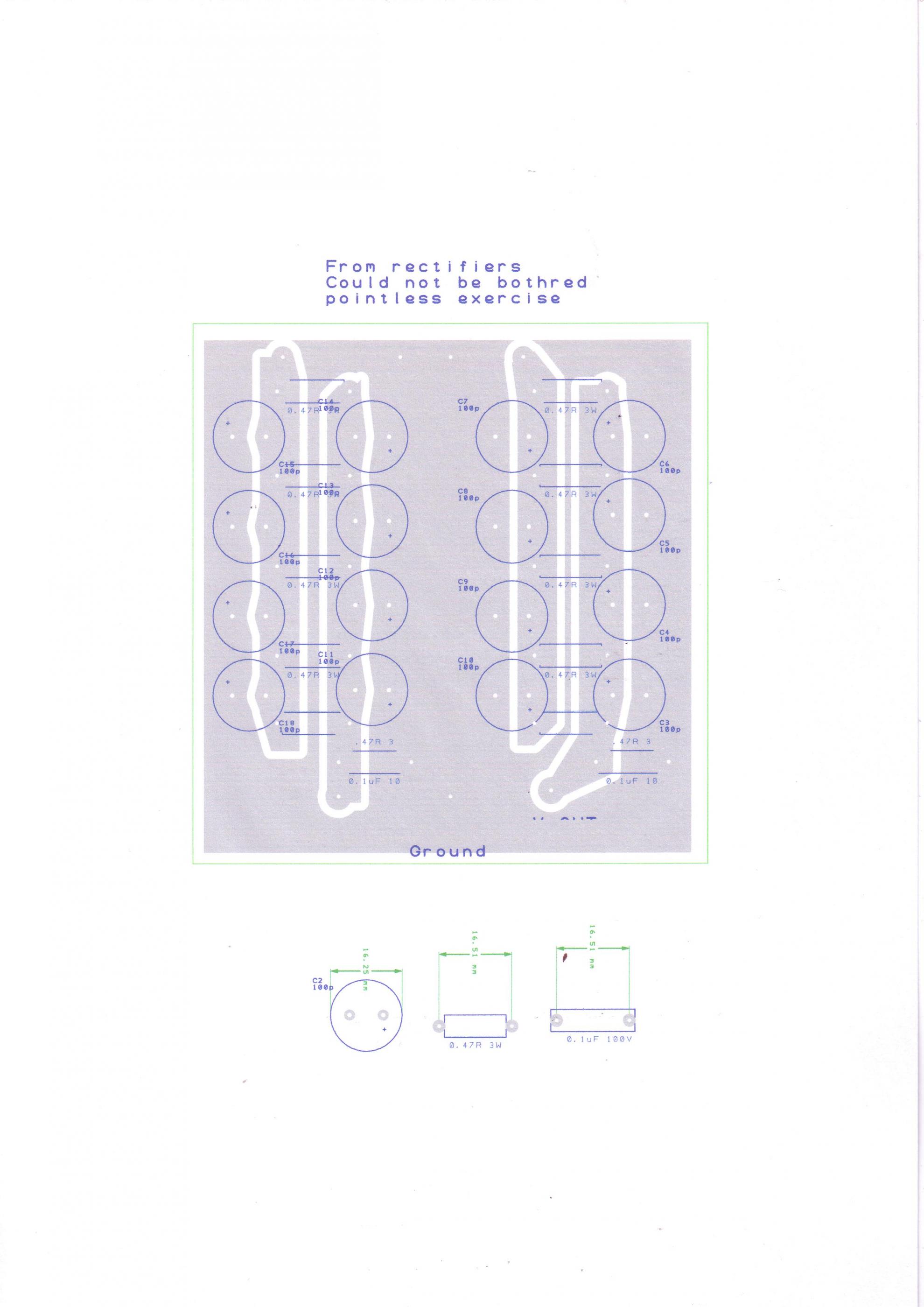

Per Anders designed it and organised a one-time groupy gang bang, so me bought a number.
Using 4 of these on the V3 (stinkin diode thing good for balanced only, imio)
Just an example piccy for No Toe UK.
It never ends, more caps, larger caps, more money!
How much is enough?
I was looking at 16 each 22,000 uF at 30mm = 352,000 uF.
Is that enough for an 8 amp supply? Smaller caps makes it easier to make the next price break (25 pieces).
Rush
Capacitor board
Just need rectifiers bit and your faw cap choice
Left it big for duble caps diameters.

Andy,
I like the board, great work, but I am struggling to understand the actual pcb dimensions.
I am only interested in V2 which can fit on my 9inch (228mm) long heatsinks (I am using fans).
You mentioned going two sided on the output tracks. Does that mean that there are no scoring lines on the back to break the boards if only two pairs used? Can you give me the OAL length I would end up with if the boards were cut right in the middle between the second and third pair?
>> Provided the dims worked out for me I'd be too interested in two boards.
