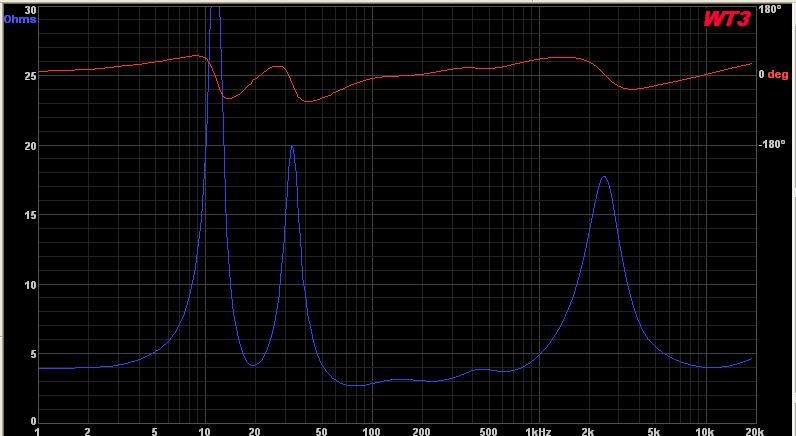

Impedence plot
Any opinions ?

post2103:
is that 70degrees of phase angle at 4ohms @ ~40Hz
& ~45degrees @ 3ohms @ ~60Hz?
Those will be very demanding of the output stage and drivers with short term loads.
At 40 to 70Hz the tones could be quite sustained. Could high levels of these bass tones these blow up the output stage?
Yes Andrew, that's the way to read the graph!
Hence ,my question: As much Power into 4 ohms as possible (higher rails) or as much "class A" as I can get from lower rails ?

post2103:
Not if he runs enuff and keep them within SOAR....
Your amp will have to be able to sink power continuously into 2 ohm to not have bass issues when driving that load, noticed you have the port tuning at a low 20hz, what size driver ... ?
Wayne,
quoting you " if he runs enough ****" , I guess you wanted to write bias "bias" ?
Driver is 15"
