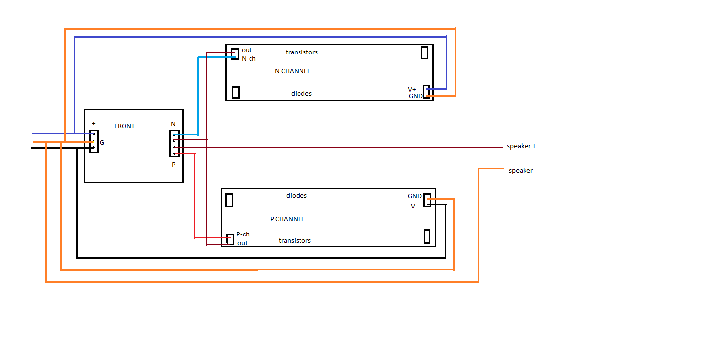

I'm building the full out V3 with 4pr.
So in the case of 4pr is there benefit of running wire directly to each connection hole of the output boards? or one wire split close to the boards to the gates and O/P at the output board be ok?
Also, what would be the best way to connect the speaker out when I have 4pr (2N and 2P boards ?)

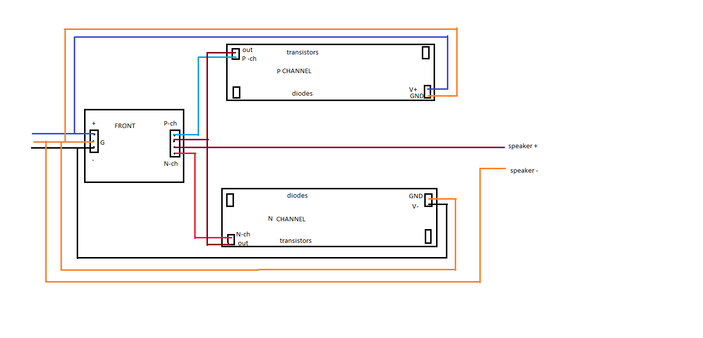

no smoking. there is a foult on that one. N ch and P ch must be switched.

her is a correct one. but the conections on the outputs are not the same on the store boards. this was for the prototype boards.
So if I use 4 pr, so 2 output boards per N and P, would I just join them right at the gain stage board? or would I somehow connect them together?
