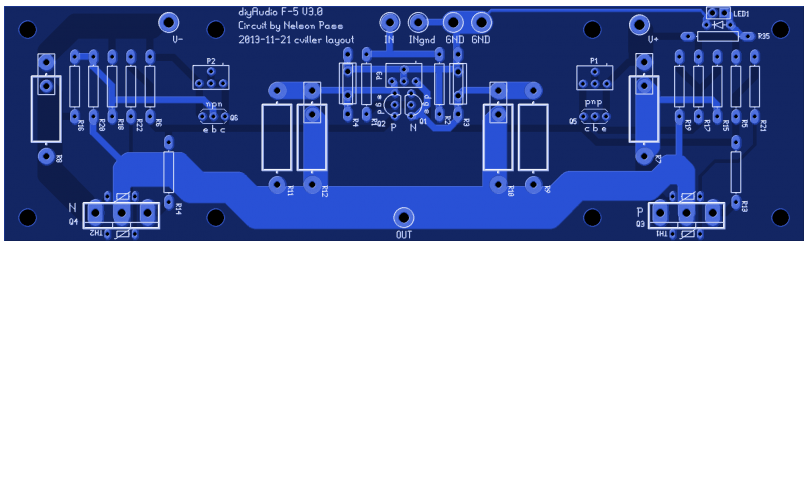

Quick question - I am now just starting to put power to my F5 v3 (Cviller) boards.
First power-up was with light bulb inline which lit briefly before fading out.
Bulb was removed from the circuit when initiating to adjust bias.
(In either scenario the board LED did not light up btw, could be wrong polarity but it might give a clue)
P1 & P2 were both set to zero ohm prior to soldering them onto the board.
Power is applied to the F5 board. V=51,2VDC over V+ and V-. (PSU reach 26,2VDC per side at idle)
At start-up I measure at R9 and R11 = 0,51V for both.
Offset at the speaker output terminals read 0,2V
No heat is felt from either mosfet.
All three DVM´s are set to VDC 2000m
I have turned P1 & P2 one turn each about 10 times and the readings do not alter one bit.
I am apprehensive to continue to turn the pots in case I have bad readings or poor/wrongful setup.
Input greatly appreciated :)
dont adjust P1 and P2 to 0 ohm BEFORE instaling them. adjust to 0 ohm (or as close as you get) over R5/R6 (origninal schematic in F5turbo ) R3/R4 in Cviller's original schematic) 2.2Kohm.
Thank you for chiming in :)
I have populated my boards based on the schematics attached, so in other words DVM1 and DVM2 is placed incorrectly now and should go over R7/R8 instead? (The 0.47R 3W resistors at V+ and V- inputs)
So I adjust P1 and P2 to read 0ohm over R5 and R6?

I can only adjust for 300mV over the 0.47 Resitors. Output DC is at 540mV

Changed the parallel resistors to 4k7, this leads to max 550mV with zero offset. Amp sounds soft and clear with no distortion. Should I change the resistors to 5k6?
But to get to 550mV one poti is totally open, the other just one third. Will this lead to any problems? I'm new to fets, sorry for this noob question....
