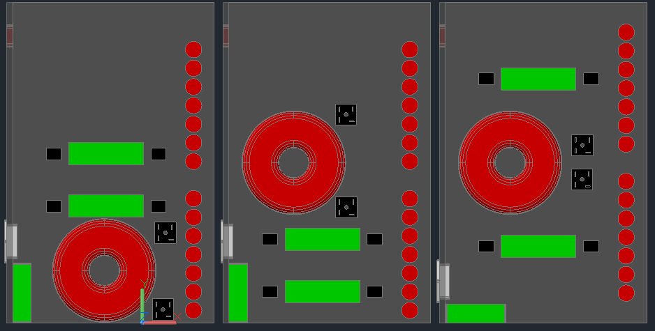

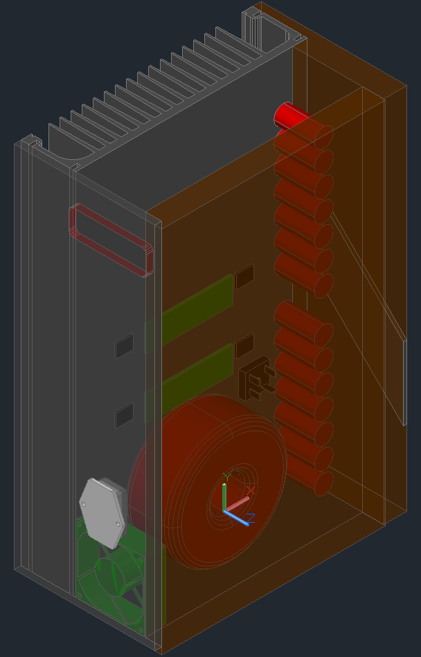

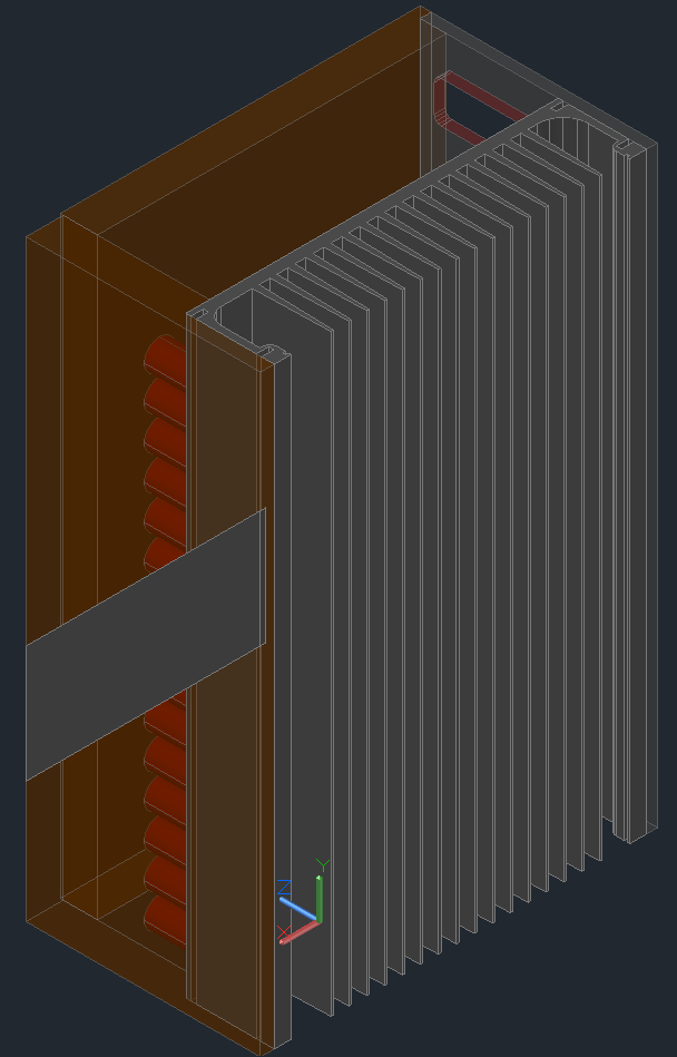

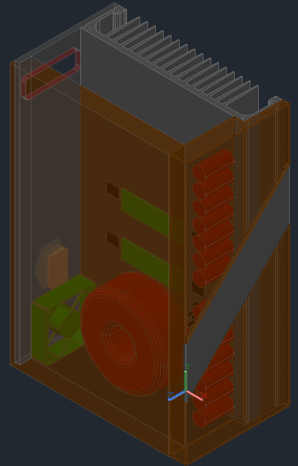

I'm just another newbie, fascinated by the simple design of the f5, and I decided to build it as my second project after 10 years of abcense from amp building.
All parts are already on hand, but since I will build up the amp standing vertically I'm wondering where to place all the parts in thermal issues.
CAD Construction of the amp:
Best placement of Caps, Amps, trafo and vent are not clear to me.
Could you support me by giving an idea which one will be the best compromise for all parts?
I'm trying to keep the temp of the Caps low while putting the pcb on the best place to dissipate the heat.
On the other hand I want to put the transformer as low as possible.
Side view:
Any ideas welcome
Thanks in advance!

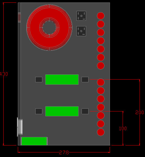

Both pcbs doesn't fit in one line, how much vertical distance should I keep between them?
Size of the heat sink is 270 x 430 mm
I would suggest 100 and 200mm off the ground, is this ok? Or should I put it more upwards with more distance to each other?
Thanks for your patience with an noob
Here's a similar build: http://www.diyaudio.com/forums/pass-labs/121228-f5-power-amplifier-280.html#post1740775
