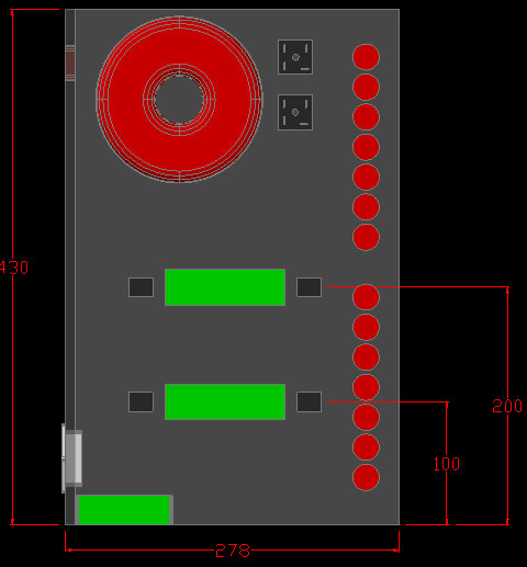

Both pcbs doesn't fit in one line, how much vertical distance should I keep between them?
Size of the heat sink is 270 x 430 mm
I would suggest 100 and 200mm off the ground, is this ok? Or should I put it more upwards with more distance to each other?
Thanks for your patience with an noob :rolleyes:
The 100mm up for the lower row of mosFETs looks about right. 100:430 = ~23%
The upper row @ 200mm seems a bit too low. ~47%. aim for between 55% and 65%. Try 260mm up from the bottom.

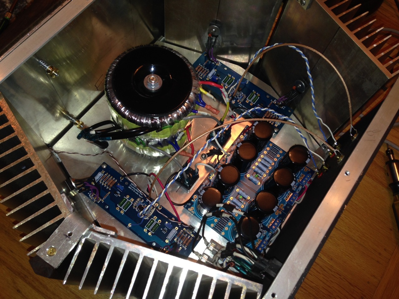

Well, thanks to the fine folks here in the Pass forum on DIYAudio, my son's F5 is (nearly) done. Done enough to post pix, at least :).

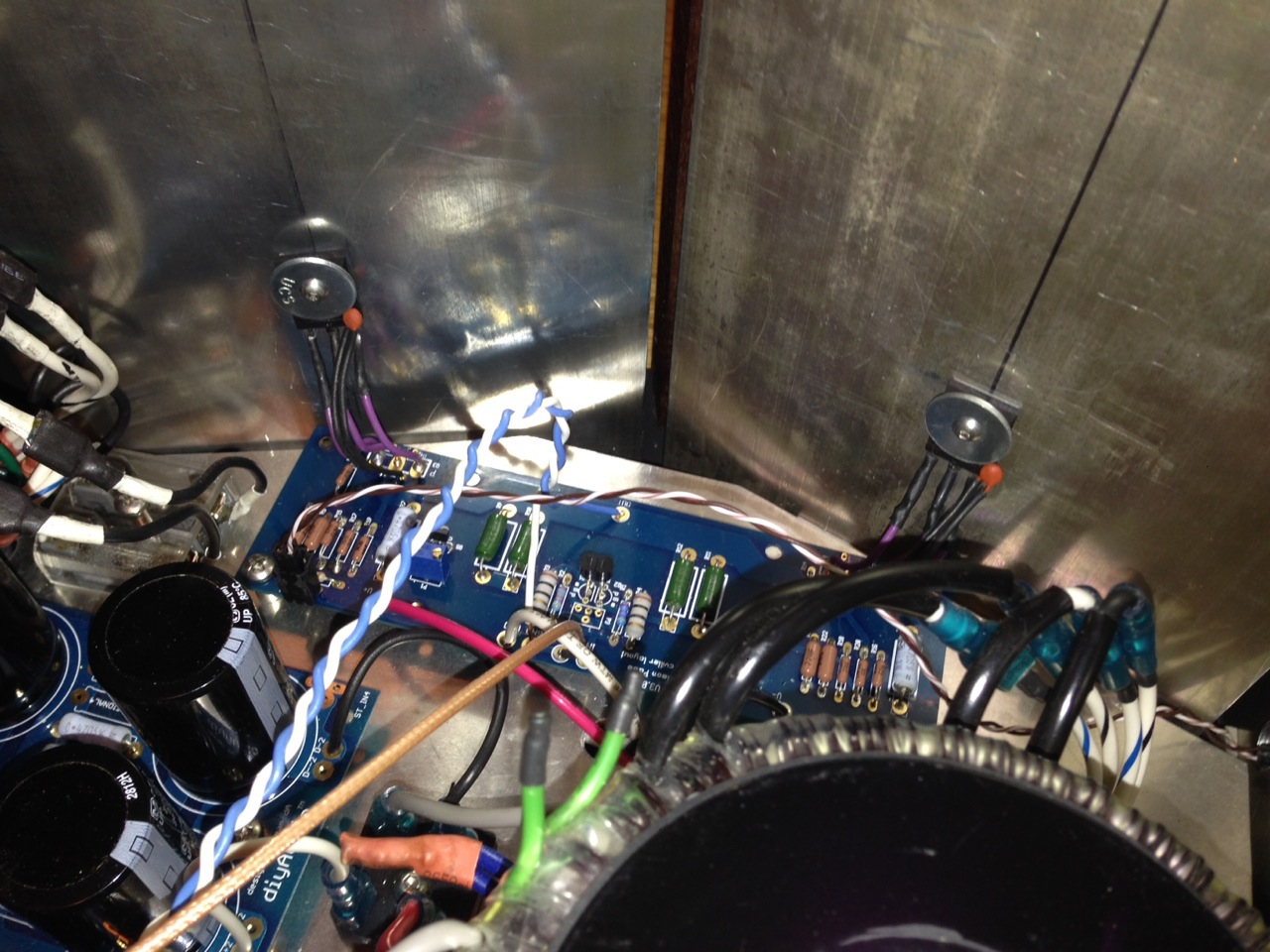

Many bumps along the way; but it's humming right along, puttin' out heat, and playing beautiful music. Unfortunately when I say "humming" I mean it literally, of the 60hz variety. We reduced the hum quite a bit by replacing the coax input wires seen in the photos with twisted pairs routed along the bottom plate, but a faint hum is still present when a source, or just RCA cables, are connected to the inputs. The amp is dead silent when the inputs are shorted.
Here's how I'm thinking of dealing with the hum, in ascending order of difficulty:
1: Rotate the toroids to move the secondary leads further away from the amp boards. Would require lengthening the secondary and primary leads.
>Q: Could the little wire stubs from the unused secondaries be causing problems? would cutting them flush help?
2: Install a ground loop breaker per the instructions on the ESP Audio Pages.
3: Install an EMF shield around the toroids.
>Q: Ferrous or non-ferrous? I.e., is the EMF noise primarily electrostatic or magnetic, or something else? From reading other posts it sounds like magnetic fields from a toroid are negligible...
4: Change the topography of the rear plate so that the input and output connectors are close to the left and right edges of the plate, and the IEC & switch are in the middle, so the output wires and more importantly input wires have a more direct path to the connectors, and reducing their proximity to the toroids, secondary leads, and PSU board.
5: Put PSU in separate housing (last resort to be avoided at all costs).
Your thoughts are greatly valued, as usual. Sorry for the low-quality pics... I'll try to take some shots with better lighting & will post them to the Pass pictures thread.
(PS: Before anyone asks, yes the MOSFETS are insulated. Only had TO-220 sized sil-pads but they fully cover the metal pad on the FETS with some overlap. Tested for continuity and they're OK. Will replace with larger insulators later)

That thing looks awesome!
You already have a ground-breaker, it's the CL-60 from PSU gnd to chassis.
First thing to try is rotating the transformers. Loosen the bolt and twist them as much as you can and see if you can make it better, or worse. Better is of course preferable.
Get the input and output wires away from the transformers and up against the chassis walls.
You have confirmed that it does not hum when the input or inputs are shorted.
What does the hum and noise measure?
Does it hum when one input cable is attached? Measurement?
Does it hum when the remote end of that cable is shorted? Measurement?
Does adding a second cable change the hum? Measurement?
Does shorting the remote end of the second cable change the hum? Measurement?
Does shorting the two remote ends of the shields together change the hum? Measurement?
Turn it off. Let caps discharge. Put little stickers on ground points on boards and chassis. Get two alligator clips attached by maybe 1ft wire. Turn on amp. Attach alligator clip to one of the ground points. Touch other clip to each of marked points. This is easy way to find a quick solution. Also touch and move all ground wires. This can expose improper placement of wire or solder joint that needs touch up.
