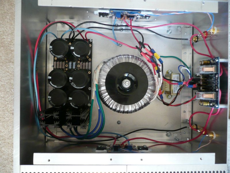

F5 Oscillating Need Help!
I just finished the F5. without any input or speakers connected, I was able to adjust the bias between 0-10mV. It takes a good while for it to warm up before proper adjustment.
I am using a Speaker Protector Circuit. It kicks in at about 1V.
I thought everything was dandy so I hooked up my aikido pre and turned everything on. I got intermittent pops. good thing I used the speaker protector.
I disconnected the speakers and tried again. When I turn on the aikido, it seems to OSCILLATE. It jumps anywhere between -5 to 20VDC! Akido off, it's steady.
I've run the aikido with the mini-A and my ref C without
any issues. exact same setup, ac cables,etc..
these are Peter Daniel's boards.
RCA inputs are isolated from chassis.
1. Aleph PSU +V and -V going to F5 boards
2. Aleph PSU Ground going to chassis and earth gnd through .1uF||10 1W Res
3. Aleph PSU Ground going to - Speaker Terminals
thanks.

Re: F5 Oscillating Need Help!
1. Check if there is any DC voltage leaking on the Aikido output.
2. Replace the cables from in RCA connectors to PCB on your F5 with shielded ones.
3. Check the reaction of the F5 in several steps:
a. without interconnects attached to the amp box
b. with only one interconnect cable
c. with both interconnects attached
d. Aikido turned off, attached one, then, both channels
e. Aikido on, volume down, one interconnect, then, both channels.
I got a low level buzz from my F5 when connected to NS10 when the F5 and NS10 were connected and with experiment, found that with certain cheap interconnects, NS picks up crap on the way from the CD. By increasing the volume (no signal), the buzz grew, at zero volume setting on the NS10, there was just a slight buzz, only audible with my ear on the bass drivers. Without interconnects, the F5 was dead quiet. No protection circuitry in mine. By replacing the interconnects between F5 and NS10 & CD and NS10, displacing them to be further away from each other, all the interference disappeared...
So, I suggest that you play a bit with the with the wiring. Disconnect the speakers and measure (if you can - able to) what happens with the amp... Also, if nothing from above helps, try to omit the protection circuitry or dislocate it...
But first go the suggested way...

The image attached is my F5. The input/output wires go quite near each other and the input wiring is made from UTP (PC networking) cable. At first I suspected that might be the problem in my case.
Once I took a better look into your attached image, it was oh_so_obvious that you lack one piece of wire per channel...
Glad it's all ok now, even though my posting wouldn't help at all!
