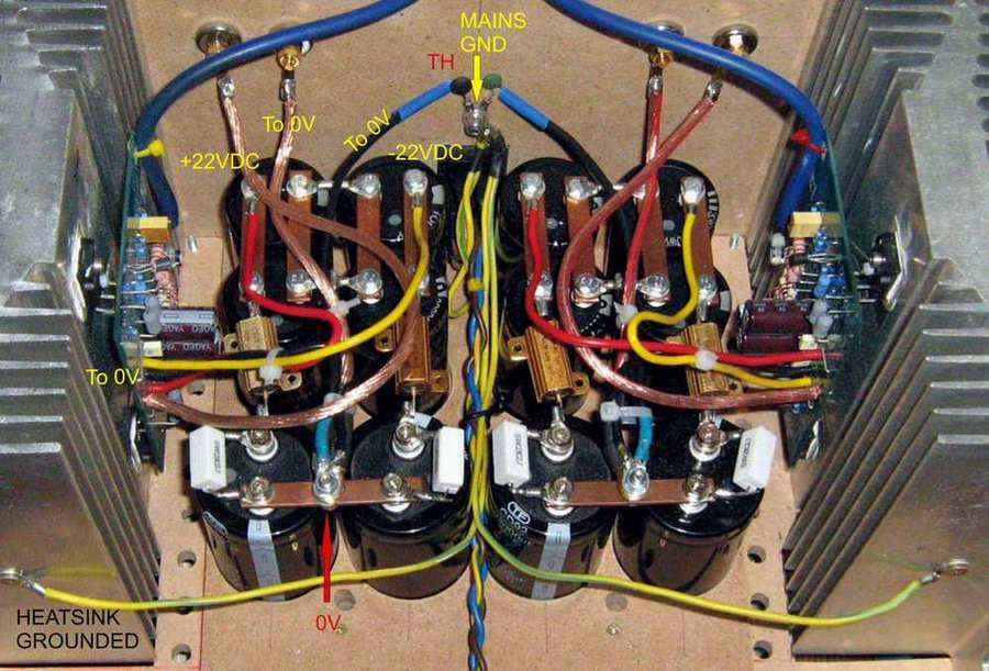

stein2 can you post a closer picture of your PSU - I would like to know how are you did gnd wiring
with so much capacitance how you are starting up - with soft start or cl-60 what value fuse you use
Sorry for the delay in response, I was away for almost a week on a business trip.
Now I'm back, and a question for you, do you mean my first attempt with wired connections or the new project with the PSU made on PCBs?
As for starting, there's a thermistor from a PC PSU, 10 Ohms NTC in series with the 230V/50Hz primer and a 0.1uF/250V capacitor taken from the contacts of the IEC connector from the same PC PSU connected in parallel with the primer of a 400VA transformer...
If you need a picture showing the PCB, I'll make a few, and if the older wired solution is what you want to see, I'll look for an image showing the details. In both cases there's no issue with hum, ground loop or any audible noise...
Bit too late to edit previous post. Here's an image how I did it without a printed board.
To the "0V" point goes the center tap from the transformer if one rectifier bridge is to be used, and I grounded the heatsinks because the "box" was made of MDF, not metal. In case that the housing is of metal, do not ground the heatsinks with anything, unless they are electrically insulated from the metal of the housing which will be grounded anyway.
