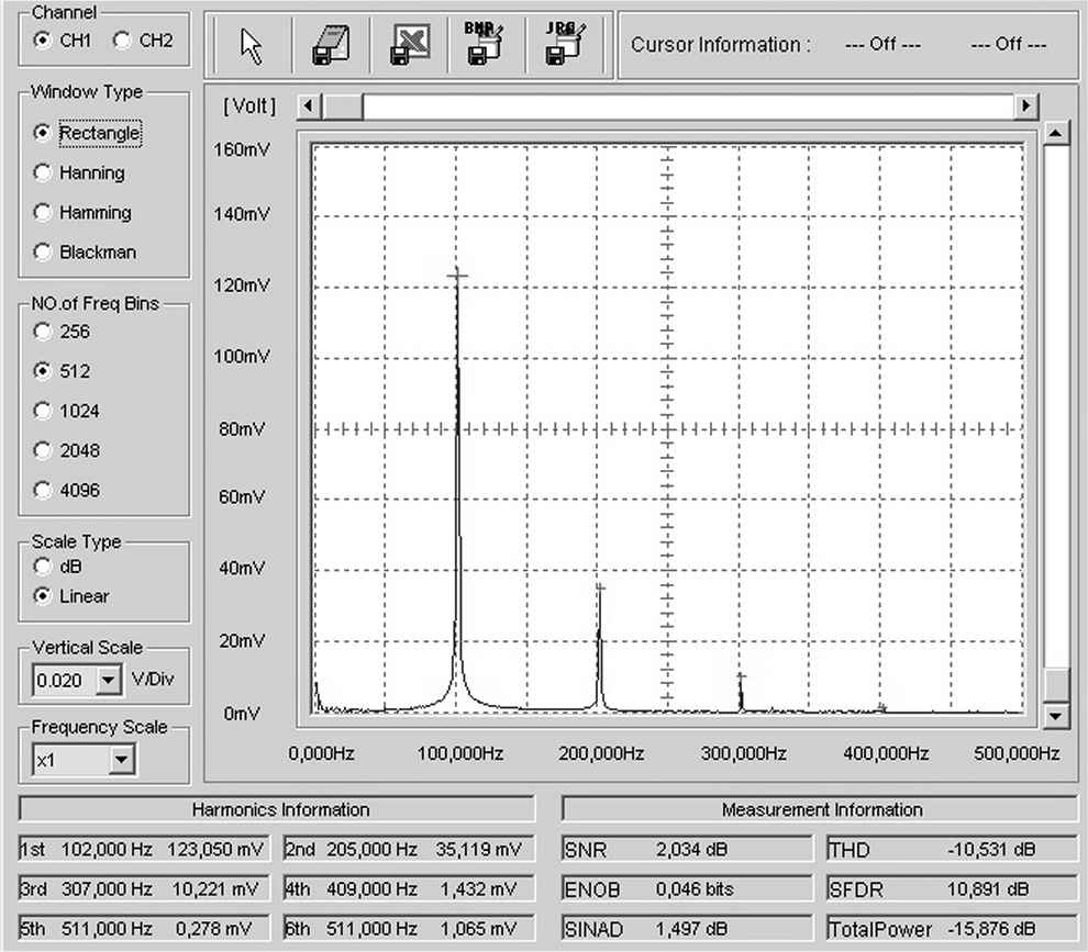

hum
I have this 100hz hum from psu. I use 8 x 10000uf caps. I suppose i must use more than 8 x 15.000 uf. What about 8 x 220000 uf, can these reduce this noise.
