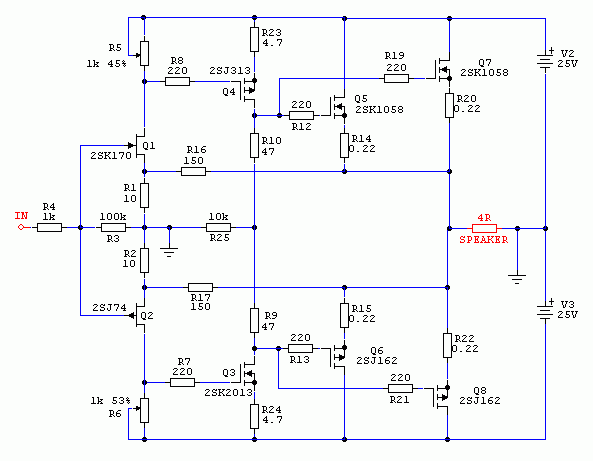

R25 value
Hi Gabor,
The trick is to adjust it nicely. R5 and R6 set the current through k2013/j313 drivers (try different values, about 100mA worked for me) and voltage drop across R9 and R10 sets the current through output laterals. R25 loads the Q3 and Q4, you might want to lower it somewhat (I liked 4k7 in the end). R23 and R24 degenerate voltage gain MOSFETs and if you change their value, you'll have to readjust R5 and R6.
As you see, this is not an industrial type of amp (build-it-by-manual approach is no good here) and you'll have to find the balance of values that suits your sound preferences.
Just take it easy, don't rush it (don't burn anything ;) ) take time to listen, and you'll be fine...
I don't know how to design solid state circuits so if I am way off, please go easy on me. I can follow directions pretty well and have scratch built many tube amps and pre-amps.
I have built this amp using all the parts in the original schematic (attached) with the exception of the output MOSFETS I used a quad set of 2SK134/2SJ49 as comes in the Hafler DH200. I am using a +19-0--19 volt DC rail supply.
I can't get any current on the 2SK2013/2SJ313 and 2SK134/2SJ49. It occurred to me that R25 would not let much current flow and that seems to be my problem. I adjust R5 & R6 and the offset and the current through the outputs is the same. If I try to balance it out I get 0 bias with 0 offset.
I tried 4k7 in place of the 10k with no different result.
Sure hope you can help me out.
Rush, your output MOSFETs are fine (they are Hitachi Laterals too).
If you have 3mA flowing through input JFETs (I suppose they are labeled k170/j74 GR), you'll have to set R5 and R6 to about 700-800R to get some current flowing through Q3/Q4. If you still don't get any current through Q3/Q4 it means that you miswired something.
Current flowing through Q3/Q4 creates the voltage drop on R9/R10 which opens the gates of output MOSFETs and current starts flowing through them too.
R25 has nothing to do with it - it's just a load for Q3/Q4 VAS stage.
