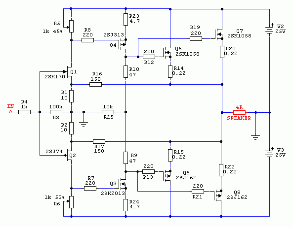

Input circuit made with BJTs can sound as god as one made with JFETs, even better - and vice versa.
It's just that BJT-made input circuit usually doesn't really like a volume pot directly connected and JFETs don't mind.
Another thing is that BJTs demand very precise matching to avoid input DC offset when you don't want to use a coupling cap but you want high input resistance.
So it all comes down to choices and personal preferences - generalizations are to be avoided...

BJT input higher resistance needed
Hi Juma.
Thanks for good explanation- missed that, you was a little step faster than me.

So i will match some and playing with input resistance if i came up to build
next time- i work on your small F5 at moment- some ideas circling around my
head. ;)

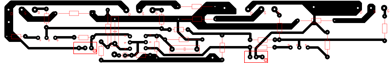

here is a slightly revised one with curvy traces:) + option to link in-gnd to pgnd with a link or a resistor + 4 mounting holes so that one could use to-3 with short wires off the pcb.

Here are the PCB thanks Prasi, excellent work.
PCB were ordered from PCBWay.com These guys provide amazing, fast and professionnal service. They verify your Gerber and tell you if all is well then and only then you pay for your order.
For the price of $10 USD you get 10 PCB with a maximum size of 100mm x 100mm + you get to choose the color of your PCB and the silkscreen color. Shipping is also cheap ($11 USD) if you don't mink a slower transport.
This time a got a small notepad + pen as a gift. You've got to try PCBWay, they are great. I'm not associated with PCBWay, I simply like to share some good news based on my amazing experience with them, I've ordered about 6 times so far and everytime it has been the same great service.

Thank you Eric, All the best for your build. They are indeed great looking PCB's.
Regards
Prasi
