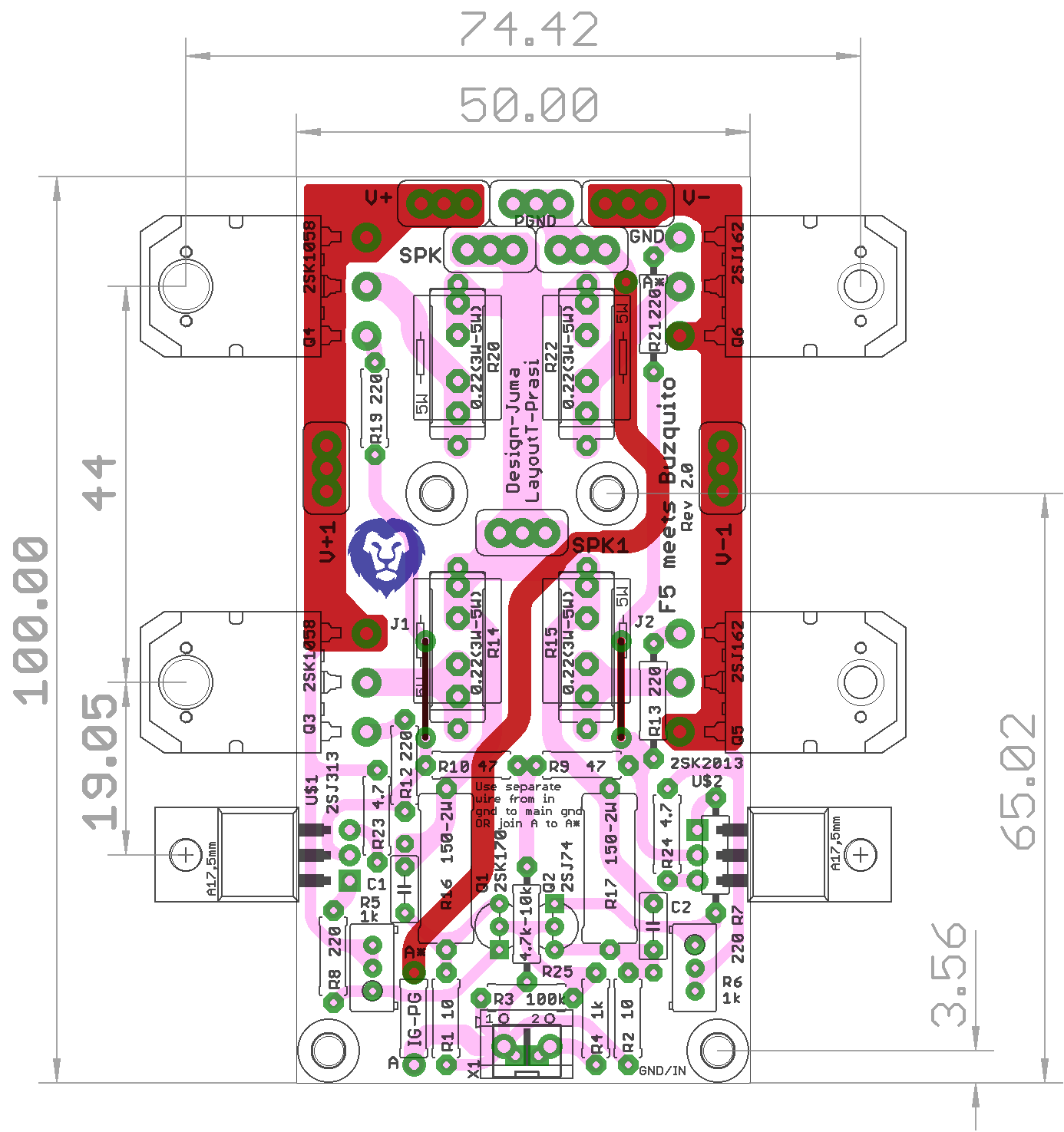

Here are the PCB thanks Prasi, excellent work.
PCB were ordered from PCBWay.com These guys provide amazing, fast and professionnal service. They verify your Gerber and tell you if all is well then and only then you pay for your order.
For the price of $10 USD you get 10 PCB with a maximum size of 100mm x 100mm + you get to choose the color of your PCB and the silkscreen color. Shipping is also cheap ($11 USD) if you don't mink a slower transport.
This time a got a small notepad + pen as a gift. You've got to try PCBWay, they are great. I'm not associated with PCBWay, I simply like to share some good news based on my amazing experience with them, I've ordered about 6 times so far and everytime it has been the same great service.

Thank you Eric, All the best for your build. They are indeed great looking PCB's.
Regards
Prasi
