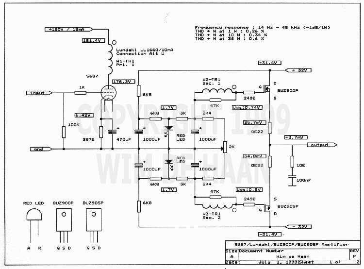

Maybe this is interesting? :D
it is , generally
