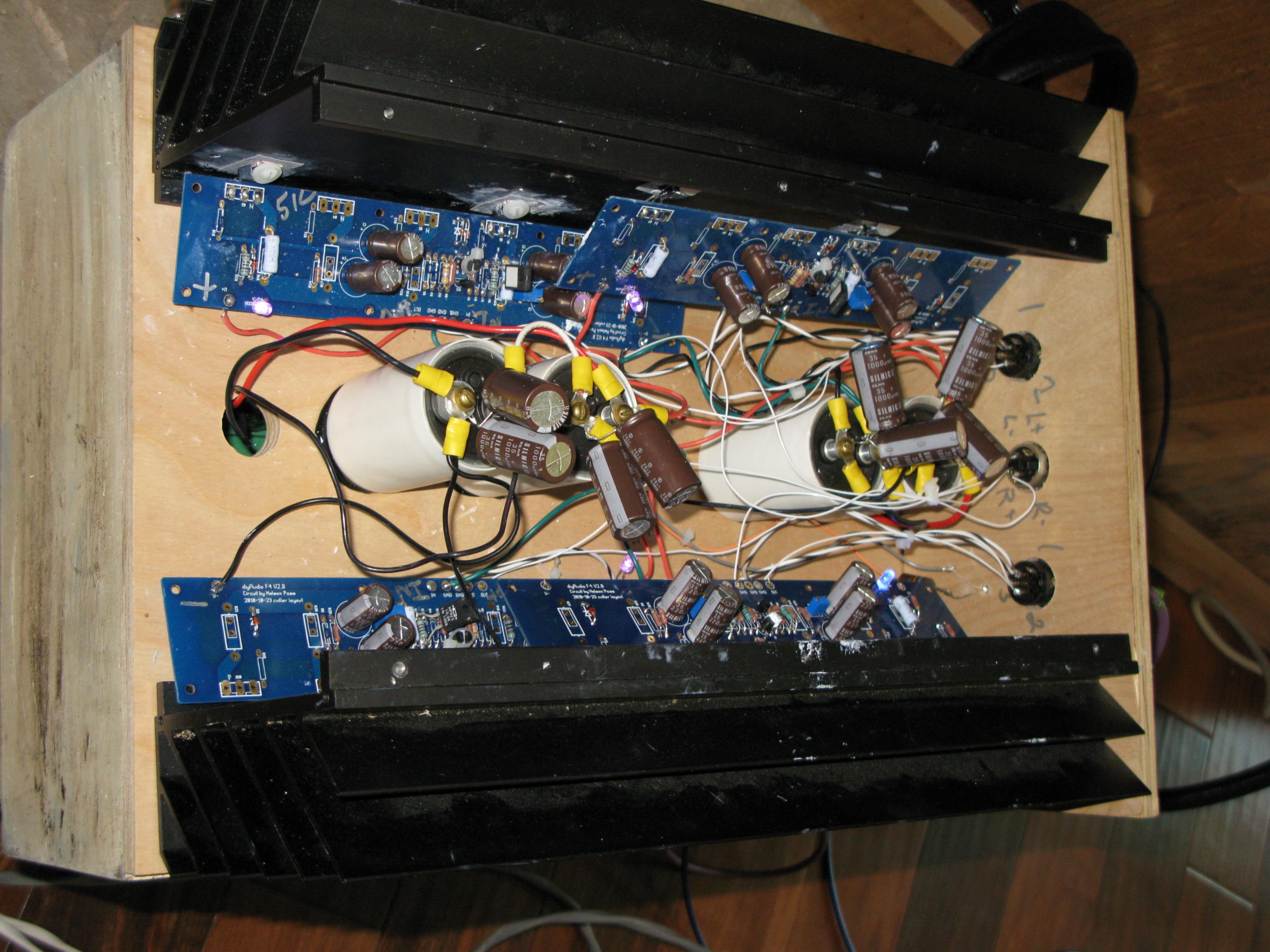

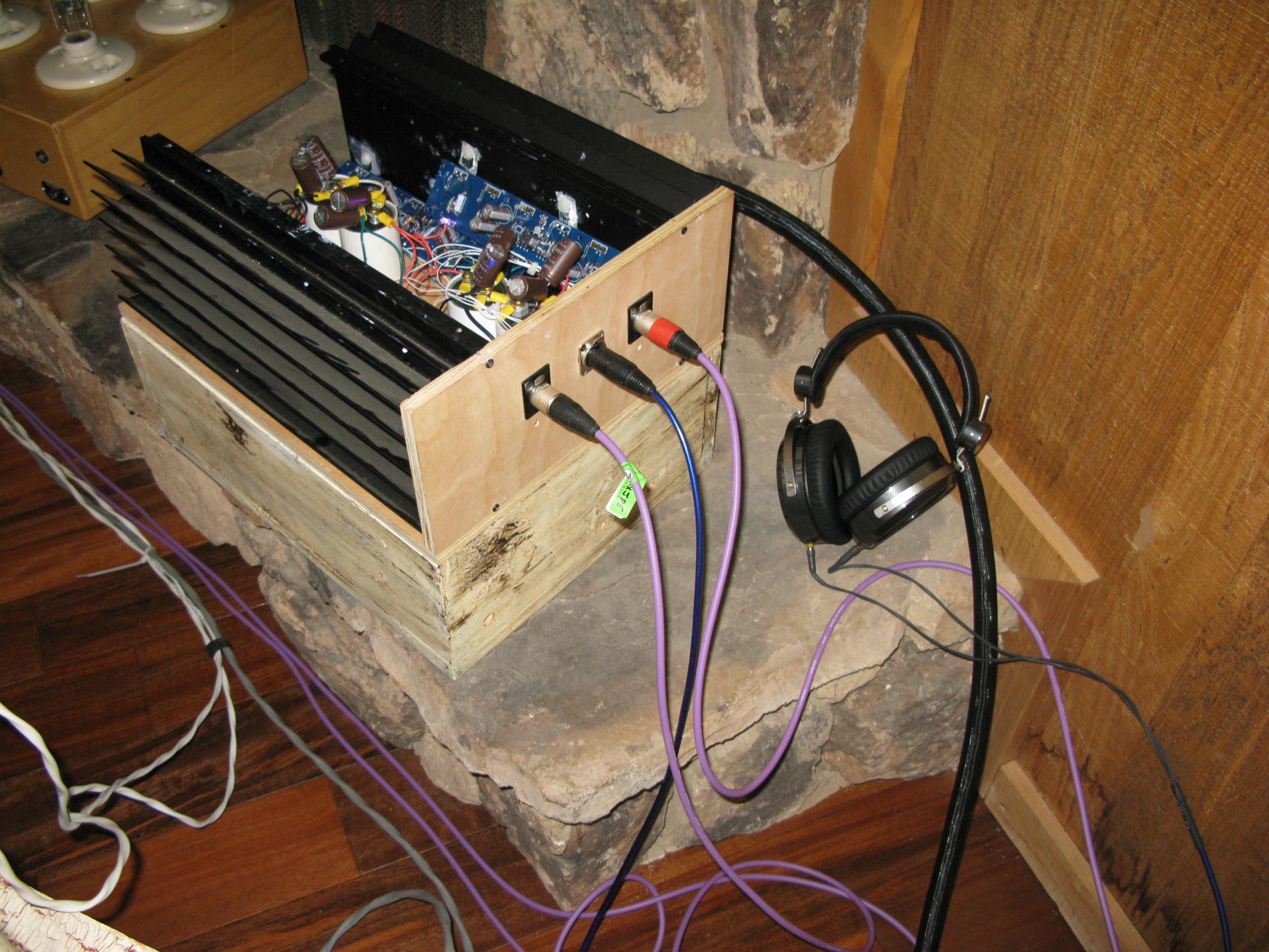

F4 Headphone Amp Up and Running
Thanks to Choky's patience in helping me debug a "bad" board my balanced F4 headphone amp is running. This is from Choky's schematic in post 3026 by generg. Thanks Nelson for the incredible current buffer. Preliminary listening (Buffalo II to XP10 to F4) says this is a keeper. As you can see "case isn't quite done.
The basement compartment contains transformers, first bank of caps and inductors.

F4 headphone amp
I have been listening to my balanced F4 driven by Pass X10 and fed by my Mc through a Buffalo II for about 3 weeks now. Running with 300mA bias at 15V.
I have to say this setup is absolutely superb with my HiFi Man 500s and with modded Denon 2000s, The bass is low and tight. There is very nice detail and the female vocalists (Etta James, Eva Cassidy, Jacintha, Nora Jones ) sound incredible. Why did I wait so long to do this. Highly recommended.
Thanks Choky and all who contributed to this thread/project.
