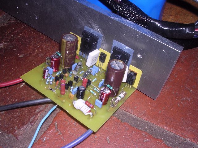

HI MIKE,
Thank you for your design and the time that you give in this thread .
I' spend a long time to read it and i'have not finish yet !!
I' finish this week the proto of symasym 5.3 according your web site .
It works great !
Offset 2 mv !
As i' want to use it in a active system (5 sections) i' will built 10 pcs.
I would like to implement some" gadjet" or modification.
First one control polarisation by external switch and relay .( low level when not listeniing seriously and more high when listening 100% ) for saving power!
Second one: can I' use inverter input for inputing the modulation ? Normaly it's better for the linearity.Is it possible ?
Witch modification i' have to do?

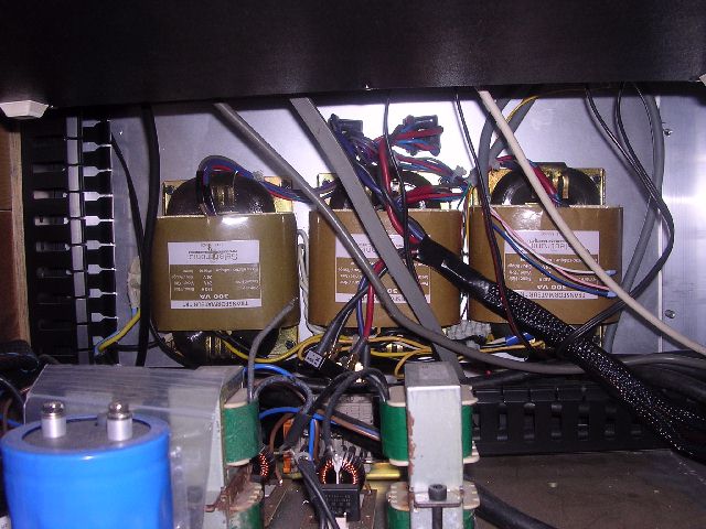

The amplifier power supply is a tree phases ( star / delta coupling ) 24v transformer and 2*47000 µf by rail.
Now i will order some better component to finish this project capacitors....output devices ?
Thanks ...

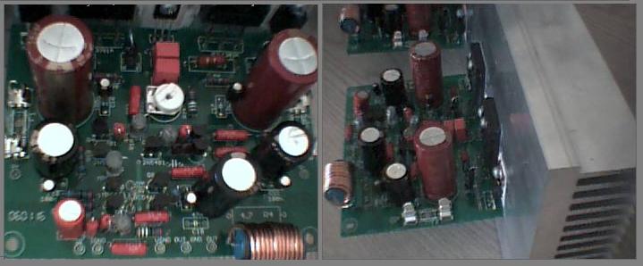

Hi balthazard !
Well done !
On your photo i miss the biasing pot ? Maybe an older photo...
About your modifications,i am not sure if i understood them. Do you want to apply an external switch lowering the supply voltage ? Normally i would say that symasym is cold enough to not need it, but with ten of them the idle dissipation becomes evident. I see no problems in doing so, symasym was designed to work within a wide range of supply voltages. Or do you want to change the biasing ?
About using the -input for feeding the signal, i can't really recommend it. Symasym was not designed to be used like that and will need a reworked feedback network. I doubt you will benefit from that in this case, symasym has already a reasonably good behaviour in the input stage.
A better idea might be adding a unitygain buffer with low output impedance to feed all 5 amps at once ?

Hi MIKE,
Thanks to reply.
Sorry do not be so clear !
I' put a fixed resistor for the bias .
It is this resistor that i' want to switch the value for changing the bias via relay.( 20ma - 500ma )
I' keep power supply at 36 V by rail.
I' need 10 pcs for active systeme (Crossover is 2 *dcx 2496)
After dcx output there is 10 Koms stepper attenuator.
My idee (i'saw it in instrumental amplifier like B&K ,,Tecktronix they use inverter input) is to use also inverter input .
I' will make some test on big power speaker.
Here under the transformers for 5 sets.
JC BALTHAZARD

Hi balthazard, i understand ! Will the relay be directly on the pcb using only short cables ?
20ma might be very low bias, this will be easily audible, you shouldn't go far below 50ma.
About using the inverted input, i am not sure if it is a good idea. In theory it should not really improve linearity for symasym, because of the high gain the current swing in input diffamp is already very low.
But, i have not really experience with this kind of input.
Mike

Hi Chris, no need for a hurry, i was just curious... Maybe you should have sold your shop with the lifetime right to get everything you need ?
You're right about the ceramics, replacing mine with a mica had an immediate improvement on sound...
