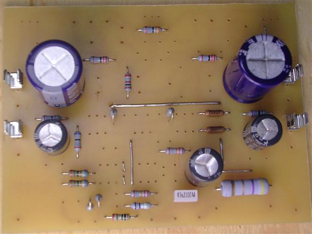

With the kind assistance of Clem, another pair are coming to life. Clem was kind enough to make some boards, he sent me two of them.
This one is waiting for parts, then measurements before I finish the other one. Those darn capacitor sizes! 😉
I'll report when done.

Hi Chuck911,
It's very low tech. Coat a section with liquid solder flux (for electronics). Put a few dabs of solder on the traces in the area. Use solder braid and your iron to coat the traces.
Hot dip except it's really hot drag. Clean with lacquer thinner.
-Chris
Yeah this is fine idea. I must try it for my homemade boards. I hope that I can find our old iron. 🙄
I was thinking about heating PCB with some solder in kitchen oven and use something like wipe to wipe off waste solder. But IMO your idea is better. Thanks.
