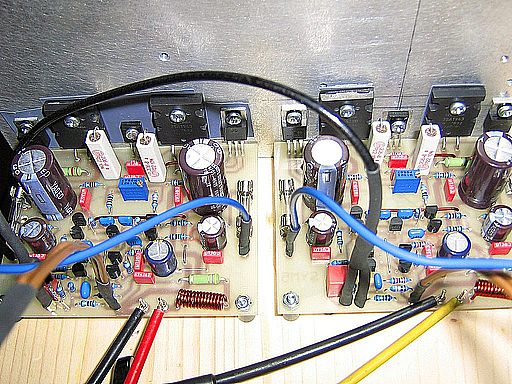

Hi to all,
the second channel is finnished since one week or so. The sound has improved comparing to my old Denon PMA amplifier. The bass is more precise, and drums show a more detailed sound now, so for me, this amp is definetly a keeper.
At a glance, the overall performance of my system is limited by the speakers and the CD player, which are far from top-of-the line devices.
Next I will remove the 100nF over the elyt of the feedback network, because I used a Panasonic FC type for the elyt.
I also like to design a DC protection circuit, before I put the amp into a case.
At the next weekes, there will be another 5.3 come to life, build by a friend of mine. He is living just around the corner as well.

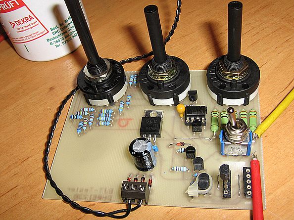

We have designed a small BJT-Tester suited for power devices as well, I can post it if someone is interested.

Hi Sheldon, you're right, if you have these caps anyway it's a good idea to keep the amps fullrange. That keeps it simple to experiment with different setups.
Your speakers look quite exotic ! Funny idea to use the same wood for passive radiator.
Tobi, nice to hear that you are pleased ! You're right, if the elyts are high quality you can remove the 100nF bypass caps. In my earlier version i used less quality elyts here, and the 100nF removed the colorized sound at once. A DC-protection can reduce quality if you get a relay into the output, but it gives a better feeling to know that the speakers are protected. The best protection might have the DC-protection shutting down the powersupply ?
One small question, looking at the orientation of the transistors in the inputstage, did you use bc550c in the input and 2n5551 for the ccs ? That's a combination i have not tried yet...
What do you think about mid and high range of symasym ?
Mike
Mike: Yes, I used BC550 for the input stage and 2N5551 instead of the BC546 for the current sink.
About DC-protection: I thought of shortening the supply lines, too. But now I am considering about using a relay, because if you shorten the PSU lines via a SCR or similar, you may get into trouble during power-up. It has to be ensured, that the protection circuit does not fire the SCR's when you switch on the amp. This could be done by a short delay, but during this delay, the output is connected to the speaker. att'n:
A relay is normally open during turn-on, and it is much more easy to deal with.
I am no HiFi-guru, but I cannot imagine that one can hear the influence of a good relay between speaker and amp.
Listening Impressions: I am not shure about the Highs, the mid frequencys are nice, and the total sound is somewhat more calm or relaxed, and complex music is played more relaxed. It is possible to "follow" a single instrument line way better than before.
Tobi
What can it 'test'?
"Tester" is maybe the wrong word for it. It is rather for matching transistor pairs, you can calculate the DC-gain of the transistor- that's all.
The plus of the circuit is the wide range of base currents, and the wide range of selectable loads. The minus is that the PNP and NPN base currents are not exactly the same, so if you want to match a NPN/PNP pair, this circuit is not so ideal. However, the worst difference of base currents was 1.2% on my prototype.
Selectable base currents are 1,2,5,10, 20, 40, 100, 200, 400, 800 uA, 2, 4 mA
Selectable loads are 1, 10, 100 R, 1k, 10k and OFF.
