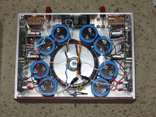

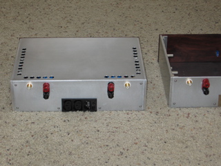

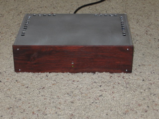

Finished Amp
One done, one just waiting final assembly into chassis. Everything as per original specs except for these minor changes: C12,13 are 1500uf, C8,9 are 120uf, R31,32 are 150R, and the power transistors are MJL4231/4302A.
Power supply is separate bridge for each channel, with 2x8mf per rail (8 caps total). Transformer is 25V, 500VA.
DC offset on left channel is less than 1mv, less than 4mv right channel. AC residual is at the limit of my meter, less than 0.4mv - no hum at the speaker. They are biased at 70mV across the emitters of the two output transistors (about 150mA).
Note the green LED on the front panel. That's powered by 6 turns of wire on the toroid. In the previous amps I used 5 turns, which is just enough to light the LED. Interestingly, with the LED just lit, it acts as kind of a power meter - it dims slightly during heavy bass passages. Doesn't seem to do that with 6 turns.
