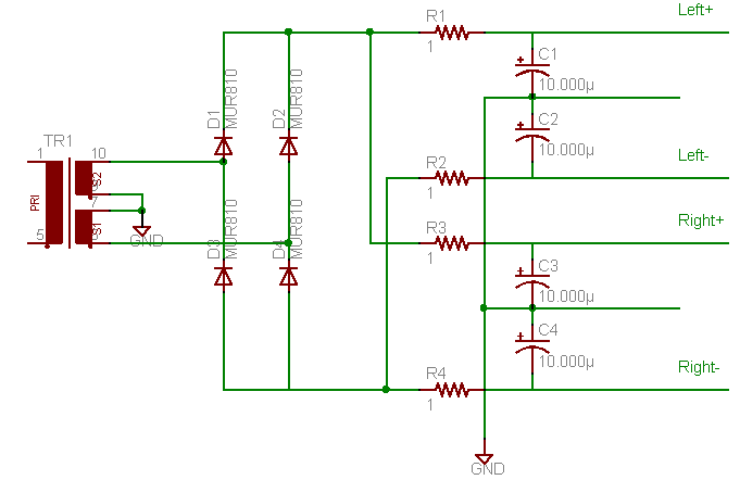

If you have a split secondary I'd use two separate bridges one for the plus and one for the - voltage. The bridges of course would be made up using discrete schottky diodes.
So a total of 16 diodes for quad secondaries (or two xform) for a stereo.
MikeB

Thanks folks, but now I'm a bit puzzled. My questions right now are:
a) Is there a measurable advantage like lower noise of Schottky diodes or soft recovery types over standard rectifier diodes and integrated bridges?
b) What are the advantages of split bridges for + and - rails, and
c) what are the pros of split bridges for each channel?
Lukas, these 1ohm resistors, skip them ! For example, if you have a peak into 4 ohms of 32v, you get already 8 amperes, multiplied by the "timefactor" the diodes are open, you easily loose more than 10volts. This easily halfes the outputpower and might destroy all dynamics in low frequencies. Would be a pity.
Symasym was designed to have reasonably high PSRR, it should not need these. I tried some snubbers, but heard no difference.
About the MURs, may i suggest MUR820 instead of MUR860 ? 200v rating should fit and MUR820 is ~2 times faster.
If you already have 2 metal bridges, use these, they have typically a rating of 25a/250v and are not bad and "undestructable".
Go, and use the 2 metal bridge rectifiers, one per channel (like Chris already said), also one capacitor bank per channel. I suggest 2x ~10000uf per channel. I use 2x22000uf (BC caps) for a single psu for both channels, seems to be enough. Bigger caps can do more harm then they help. (worse ESR, torturing the diodes)
I have not investigated PSUs very much, made some simulations to investigate the diode ringing, unless you know exactly what you are doing, do not place any caps across diodes or in paralell with the ac-supply, you risk turning the ringing into oscillation. A nice RC on primary side can really help, but needs suitable parts and can be installed afterwards.
If you look at Pavels measurements, the 100hz ripple is barely visible (< -110dB), and if i remember correct, Pavel uses a "normal" PSU. Pavel can you show what you exactly used as PSU ?

12 Cents said:Thanks folks, but now I'm a bit puzzled. My questions right now are:
About a), it's the ringing creating HF-trash into the rectified voltage, b) i am not convinved that it is really better, except it halfes the load to the diodes, c) better separation of the supplyvoltages, giving better stereo separation.
b) might get interesting when you make a dual bridge per channel, creating extra power grounds per channels.

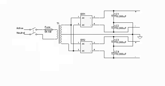

The PSU is much like this, with 100nF caps in parallel with electrolytes.
The diode bridges are rated at 15A.
/Thank you RodE, I borrowed the picture a little bit, as I was lazy to draw a new one, always friends /
The 10R resistors between IGND and PWGND of Symasym help to prevent ground-loops a lot.
