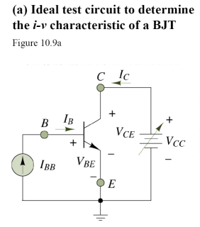

12 Cents said:dx master, you wrote that you have done a matching tool, can you show that to me? Right now I only have this:
Please look at the PDF.
This is what build and now will sit in a box with a Gosse DMM.
The PNP Testpart ist eq. to the NPN Testpart !
And resolved over a 'Umschalter'.
Or for just matching some small signal bjts a much simpler version... (see attachment)
You only need one of these constructions, it's identical for npn and pnp.
I used a dip8-socket for placing the transistors, the whole thing fed by a 9v battery.
The vbe is simply measured by checking the voltage between base and emitter, the hfe is calculated by simple math:
Re = one of the 1k at emitter side
hfe = V(Re)*100/V(R3)
V(Rx) = voltage across resistor. Not the perfect accurate one, but built quickly.

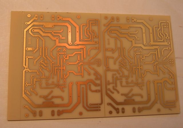

Thanks Mike and Uwe! See attached my board, done with a gutted scanner as glass fixture, some traces have small holes (can be checked well by holding against a 100W light bulb), I will use some solder for that.
Oh destroyerX, Mike is smart, and you are heartful (new word... I mean hearty).
Yes, that worked out. I used 3 min but maybe will up to 4, because it needs to heat up or sth and after 2 min it has maybe 80% maximum light output. I developed ~ 3min. Was not too clever and wiped the board dry with toilet paper after developing and rinsing, that left some resist in some areas where it shouldnt belong. But all in all worked and was fun . This hobby is so many-sided
