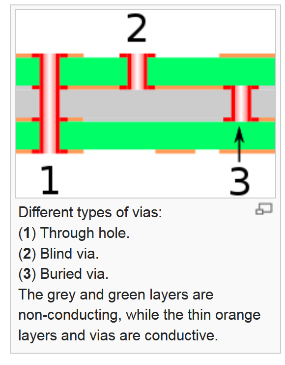

Wikipedia tells you the different types of vias, see attachment & link.

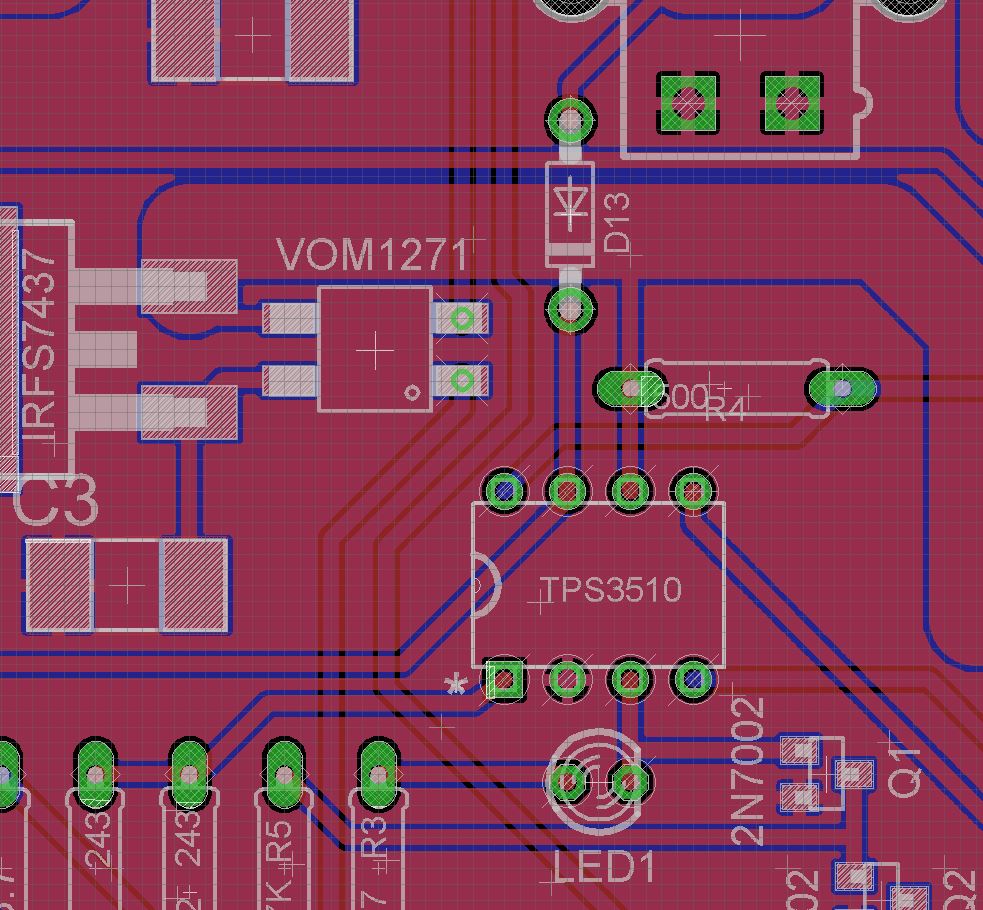

I personally don't put vias directly under IC pads because I worry this will wreck the planarity of the soldering surface, and prevent some of the package legs from touching their PCB solder pads. Giving rise to invisible open-circuits, one of the more difficult PCB troubles to diagnose.
In your drawing I'd probably move the green via to the left by 3 circle-diameters, away from the landing strip where the package leg touches down.
edit- Does this mean I would/should be willing to put vias inside pads of 2-terminal components like capacitors and diodes (which don't require planarity)? Um, err, yes I suppose so.
Thanks. That's good advice.
It was the Wiki article that led me to believe these weren't buried/blind.
I presume that underneath an IC (not the IC pads) is likely less of an issue? Things are getting rather cramped at one area of this board. I'd like to move the vias to the left here rather than to the right...

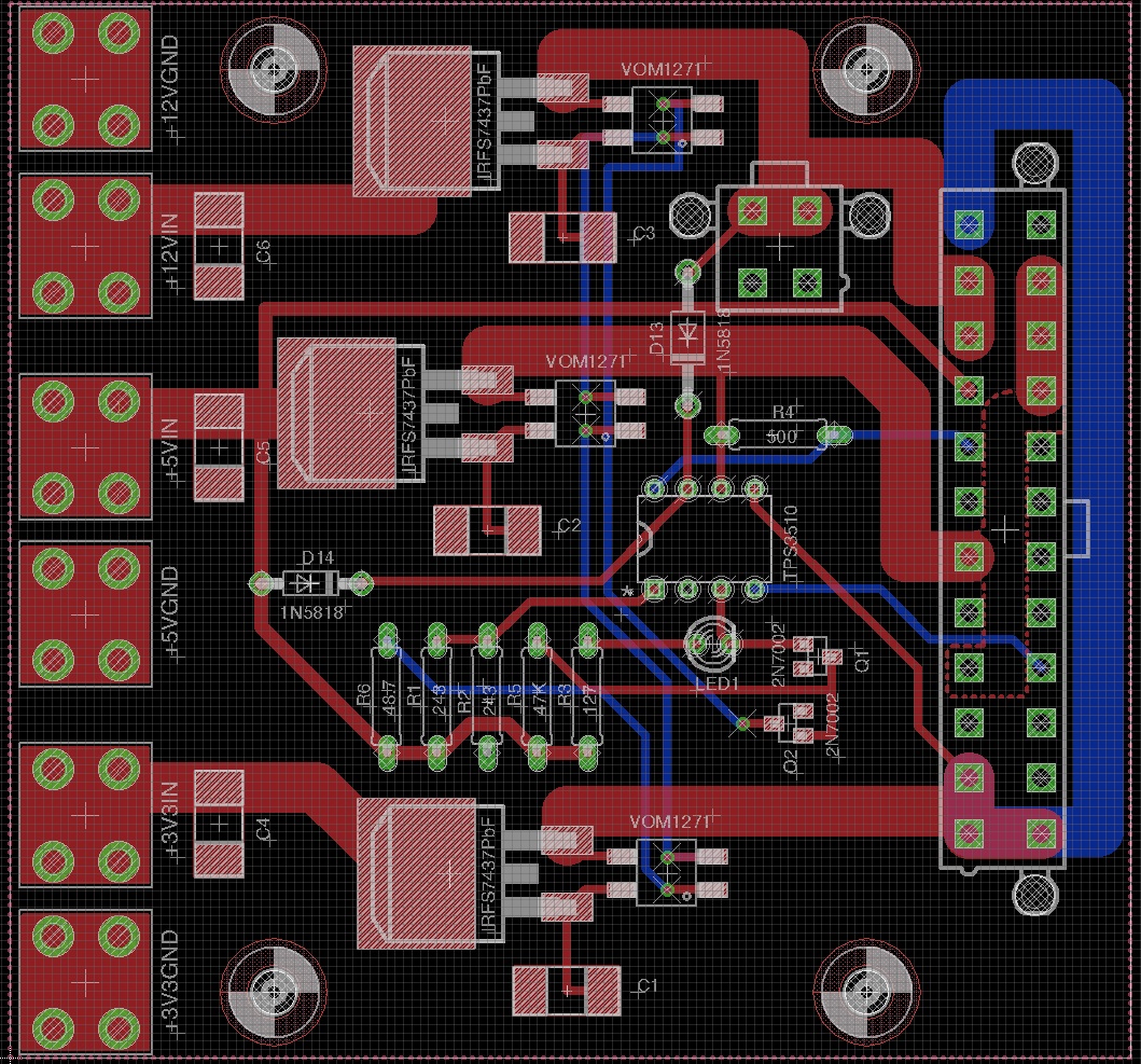

I've made some progress with the TPS3510 "control board". See attached image.
I have made the following calculations to determine appropriate values for C1, C2 and C3 for voltage slew rate control ahead of the pass transistors. (The parts in the schematic are placeholders for now.)
Cgate = Cload x Ipu/Imax
where
Cgate = the size of capacitance from gate to ground
Ipu = the current fed to the gate and Cgate
Imax = the maximum permissible current through the pass transistor (in my case, 5A
The circuit I posted in #147 (with the voltage divider of R1 and R2 corrected) should lead to a forward current across the VOM1271 diode of around 30mA. According to the VOM1271 data sheet, a typical open circuit current for an If of 30mA is 47uA. So Ipu = 47uA give or take***.
Earlier I posted the ATX PSU spec for capacitive load:
Using these and the above formula with Ipu of 47uA I get:
Cgate12V = 8,000uF x 47uA/5A = 75nF
(all 12V comes from a single rail in my case)
For the 5V and 3.3V I get 56nF. (The 5VSB voltage supply doesn't go through a pass transistor.)
What I am unsure of is whether being conservative in these calculations or in the selection of the gate capacitors will restrict, adversely, the flow of current once everything is charged.
I can use a ECHU1C563GX9 for the 5V and 3.3V. For the 12V, I have (from the same series of capacitors) 68nF or 82nF available. Dropping 82nF into the above formula and solving for Imax yields 4.6A. If this "throttle" remains fixed post initial charging of Cload then I have restricted the current capability of the power rail.
Perhaps I am better off using 68nF for a maximum current through the pass transistor of 5.5A. Judging from a look at the safe operating area for the IRFS7437PbF, 5.5A burst would appear ok:
*** I am confused when I look at the data sheet for the VOM1271 and compare Electrical Characteristics, Fig 2 and Fig 8. From Electrical Characteristics, If = 30mA => Voc of 8.9V and Isc of 47uA.The former matches Fig 2. The latter, however, seems to clash with Fig 8 when I look at 8.9V on the x-axis...

I can't find the posting where you wrote out your full and complete list of design requirements, but (from not-so-reliable-memory) I think I remember that one of them was, approximately,
Achieve far, FAR lower voltage noise on the final supply rail, than the noise from an Anker E4 Astro battery pack. If this goal is achieved, it annihilates any possible assertions or claims that mains-powered regulated supplies must be inferior, always are inferior in the noise department.
Assuming I remembered correctly, it's rather a big surprise that your PCB layout does not include at least one stage of supply noise sensing, amplification, and buffering, to let you accurately measure noise on your kick-those-guys-in-the-rear-end power supply. I would have thought you'd include a very low noise opamp in a gain-of-35X circuit (AC coupled with a low frequency rolloff well below 20Hz), so you can accurately measure your supply noise without being contaminated by noise from your scope and/or other instrumentation.

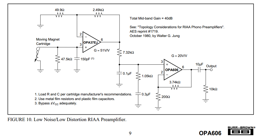

Walt Jung's blog includes a preprint of his AES paper on passively equalized, ultra low noise RIAA amplifiers. Walt's first stage is a pure, flat frequency response, gain-of-25X amplifier block, for optimum signal-to-noise ratio. His later shifted to a gain of 50X in the first stage; if we take the geometric mean, sqrt(25*50) = 35X might be an uncontroversial, fence-straddling choice of first stage gain. But your PCB has no supply-noise-amplifier at all! It is rather a surprise.

I took a look at the Walt Jung article. I'm unfamiliar with opamps generally but this is a logical next step for me (and obviously IC regulators themselves are a form of amplifier) and I might guess that this is, in part at least, the reason for suggesting this next 'assignment'. :)
When I look at Fig 2 in the AES article, I see (in sequence) a gain block of 24.7x, (I don't understand the reason for Rt and Ct except that I read they provide "input termination" and "are optimised for flattest response") a transfer function N which boosts low frequencies and reduces high frequencies as required by RIAA equalisation, a further 40.2x gain block and a high pass filter with corner frequency of 1.6Hz. (Perhaps C1 was meant to be 1uF?) One would think that the transfer function N could be removed because we want to observe the actual amplified input (and not certain frequencies attenuated or boosted) but maybe that thinking is a bear trap; else if only one gain block were to be used 35x could be achieved by simply changing R2 to 34k.

Walt Jung's AES preprint discusses partitioning a high-gain amplifier into two or more pieces. He notes that for best noise performance, the very first stage should have extremely low noise and operate at high gain. That way, the noise of subsequent amplifying stages will be negligibly small -- it's effectively attenuated by the gain of the first stage. There is another benefit: RMS addition of uncorrelated noise sources diminishes the second stage's contribution even further.
However in an RIAA phono preamp, you can't make the first stage gain enormous, else large input excursions like ticks and pops will overload (clip) the amplifier. Jung chooses a gain of approx 25X as a nice tradeoff. Later, (when helping to create) the datasheet for the OPA606, he boosted his recommended gain to 51X, figure below. This offers three possibilities for mindless copycatting: (i) 25X gain; (ii) 51X gain; or (iii) something-in-between-how-about-35X gain.
You might decide that it is preferable to test both power supplies (Anker E4 Astro battery pack, and new mains-powered supply PCB) the exact same way using the exact same noise measuring apparatus for both. When the exact same test gear, used the exact same way, gives better results for Red than for Blue ... Red is the obvious winner. Since it would be very difficult to integrate a low-noise, gain-of-51X preamp into the battery pack, perhaps the conclusion is to measure both supplies using all-external test equipment, and thus omit the preamp from the mains-powered supply PCB. Or you might go ahead and put a supply-noise preamp on the PCB, just to have that measurement option available later. Don't forget to provide a mechanism (jumper?) that shorts the preamp input, so you can measure the noise floor.
edit- Oh by the way, Walt's choice of an OP-37 decompensated opamp for the first stage, is brilliant. Since he's operating it at a closed loop gain of 51X, there is no risk of instability, and he gets all the extra bandwidth that comes with decompensation, for free. The OP-37 is quite a low-noise little devil, to boot. Well done!

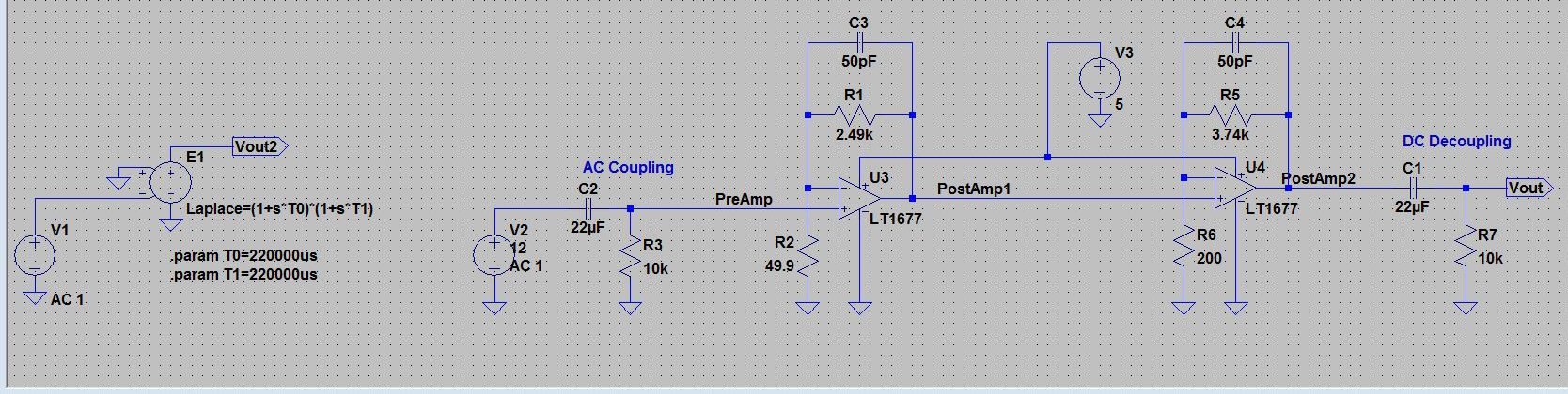

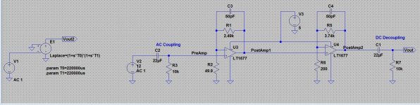

Ok. Proposed circuit addition below. I didn't read anything inthe datasheet regarding sensitivity to decoupling the supply and so didn't bother with this (plus the 5V is already decoupled with a 0.1uF cap at the connection point to the board). The gain is pretty much flat from 15Hz to 55kHz.
60dB of gain. 1000x. My scope has a lowest vertical resolution of 1mV per division. Should be ok. My presumption is that the scope's FFT analysis can show the spectrum of the noise (I've not used this yet).
I also took another look at Lasse's pre-amplifier schematic. It becomes demystified when the switches for gain control are removed. The LT1028 (LT1128 ?) he uses seems to have impressively low noise.

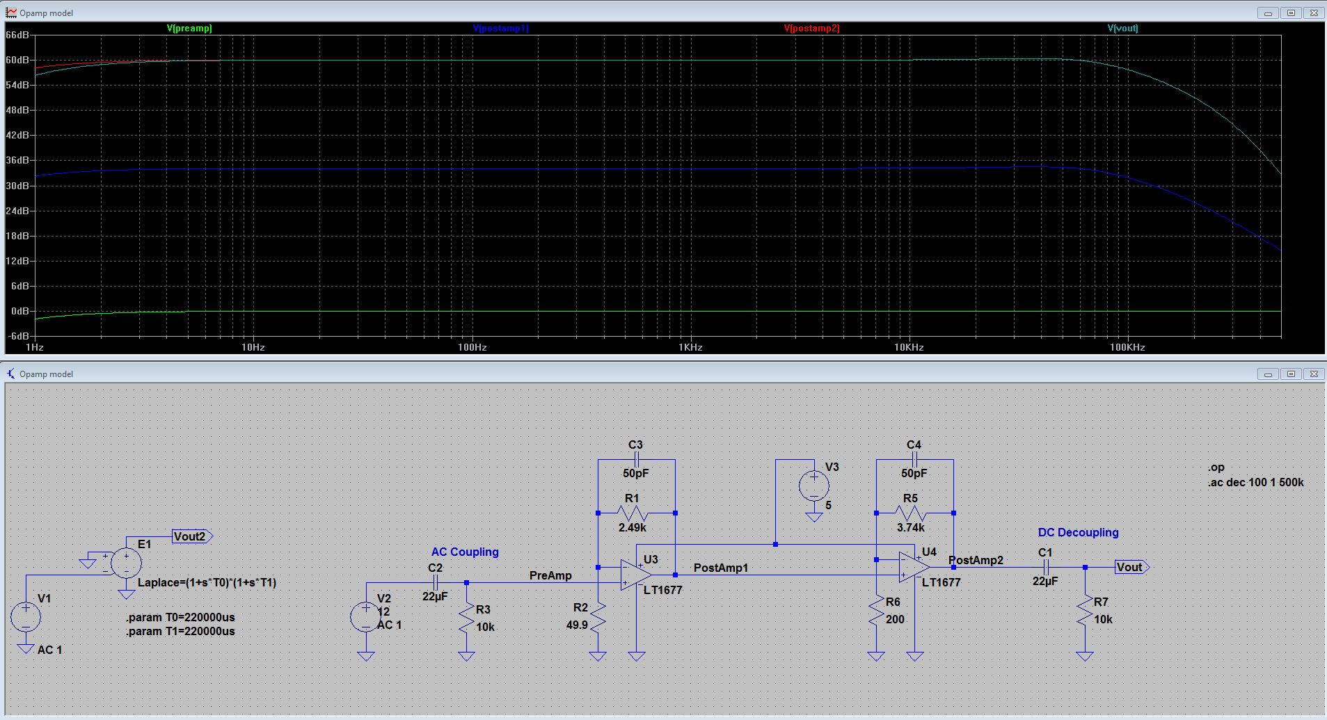

Okay, I see a couple of problems...
I pulsed the input voltage and did a transient analysis to look at the results at various stages in the circuit. Obviously there's the issue of clipping if the change in input voltage is too large versus supply voltage/gain. Increasing the supply voltage to 12V provides more headroom. I assume the general problem of potential clipping is unavoidable and places a practical cap on gain for a given supply voltage.
It seems I should add dc decoupling between op-amps. Even when I do this (duplicating the 22uF and 10k resistor) I have a small amount of DC measuring ahead of the first op-amp and second, and a small negative on output.
There's also the poor shape of the waveforms constrained by the slew rate of the op-amp.
I'm sure I am missing something else...
