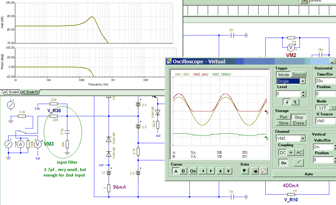

So, that amp is single ended source follower with bootstrap (tracking rail right?), and you minimize nonlinearity by modulating CCS with error of source follower. That's good idea.Sure, it is what I am talking about. Linearized wideband amp sounds better than less linear that starts rolling off from 100 Hz, with global feedback around resulting in better measured linearity. For example, when I used source follower loaded on modulated CCS, and this source follower is powered from another one bootstrapping it, the result is very linear, but not because transfer function is linearized by feedback. Because variations of voltage between drain and source, and current through it, are minimized. Actually, what I am aiming at, is not linearity, but rather smoothness of transfer function.
You right, smooth is better.
I am applying small input filter and it is more smoothness, and more again with bigger filter, but I don't like this stage getting slow.
It has 83dB current gain and not reaching 90dB with filter, while it reach 95dB without filter.
Edit: not 83dB current gain, but 83dB -18dB = 65dB, because output measured is voltage into 8 ohm resistor
