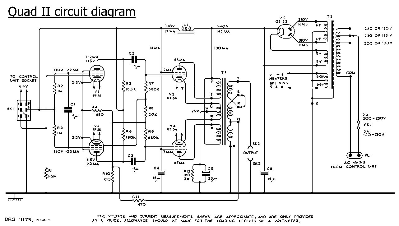

Quad II was tetrode (KT66) with cathode feedback, does not seem triode connected to me.
And the Quad 22 preamp had a pentode connected EF86 at the input.

But not pentode (bear's contention), that was my point. And again, you have to believe that JGH never listened to a triode amp, which is somewhat north of ridiculous.
