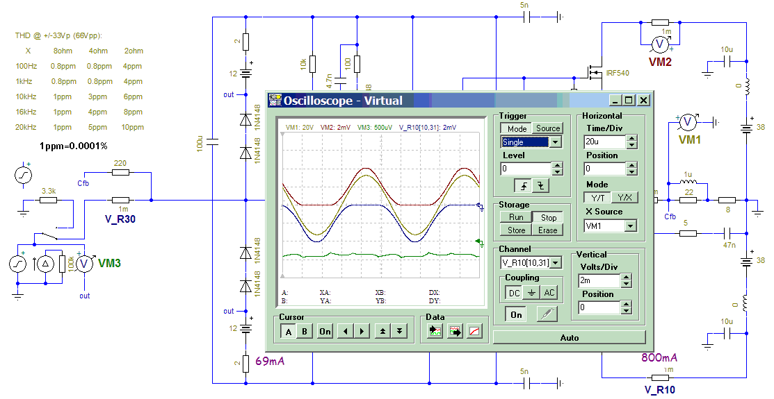

That is not always true and not a surprise, my N2 has low feedback and only 9 transistors including the power mosfet and its current source, it could operating also with 8transistors in total. There are no easy way to get stable high NFB that could reach 1ppm THD and less, with only 7 transistors driving mosfet output. Low distortion in solidstate isn't always high feedback but the output stages could be linearized with good design.
Why need 1ppm? because it need to work as linear current amplifier that has linear forward and reverse transfer. 1ppmTHD V-amp results in around 0.01%THD I-amp (depend on I sense resistor used). 0.01% THD is the margin that my ears start to hear differences for H3 and up, H2 is 0.02%.
In N2. It just have crossover distortion rises when operating in 10kHz and up with high current 2ohm load.
Attached shows 800mA biased N2, crossover at 10kHz is only in micro volts. I am choosing 200mA because that crossover distortion is already inaudible in around 100mA. Test is also easily do with biasing switch.
You know? This kind of buffer (I call it power gain in the past, but not a good name) has linear load transfer from output to input that makes it sounds like what is at the input.
