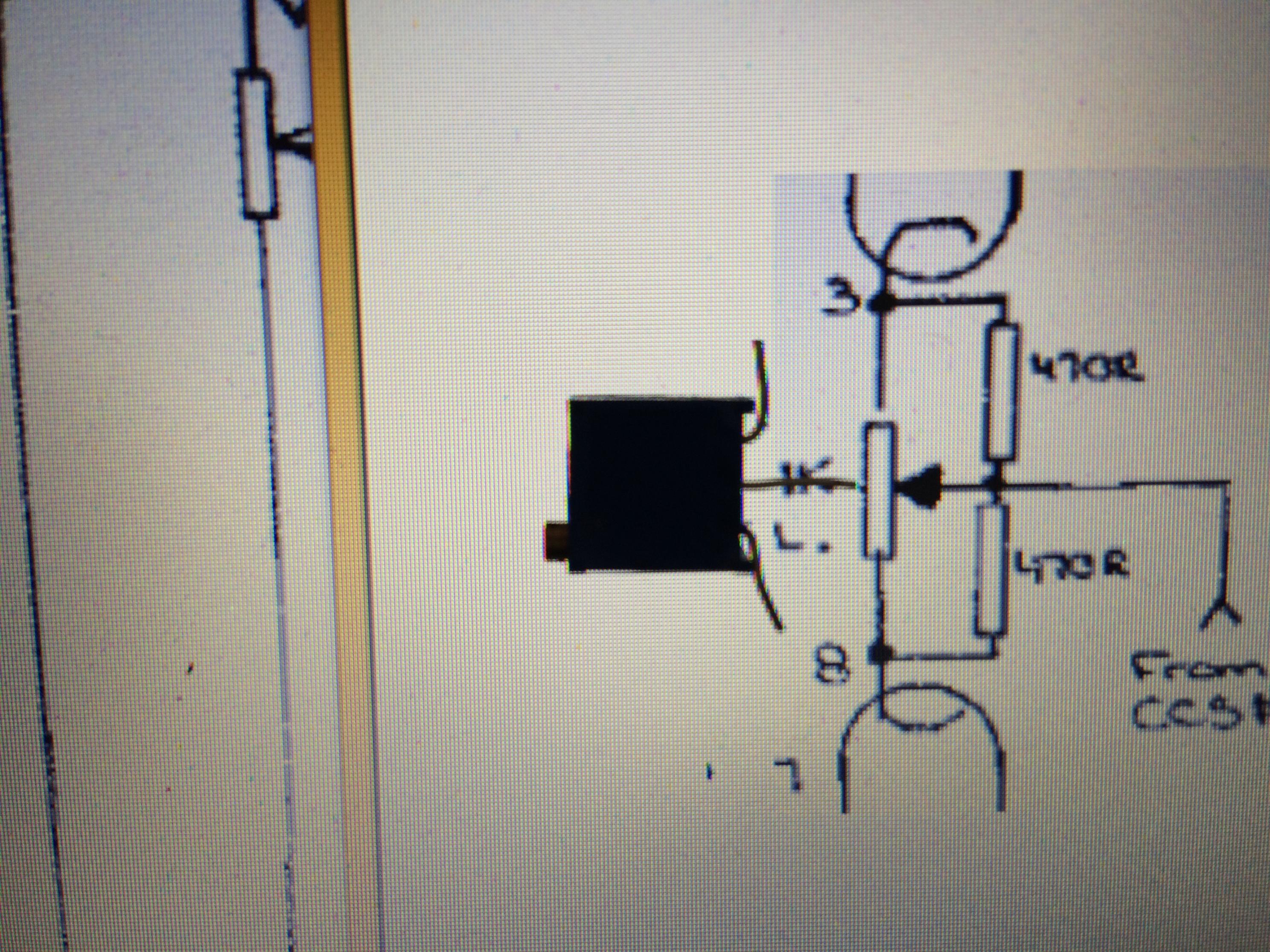

I am building the baby huey as of page 1 of the thread. I dont want to make a stupid wiring mistake and burn anything, hence the post. Is this the correct way to attach the variable resistor pin out, used in the CCS, to the cathodes of the driver valve (see photo)? Thanks Alan

I have tried smaller caps to reduce surge but the problem still remains. I am using 200ma fuses and the amp even as a mono unit sounds great, but I am not happy that the power transformer is now unprotected. On start up the ccs voltage before it enters the adjustable resistor (between the cathodes of the ecc) starts at -7.73v BUT! I have just discovered it then goes to -1.13v after a few seconds and says there...Is this what we should expect? Alan
totally confused now...it is an ecc83s that is my driver....my transformer is 3.15v ct 3.15v, when I wire it as the data sheet that is 4 and 5 not joined , each connected to a 3,15 and the ct at pin 9 I get very dull heater and only can hear the feedback source in the speaker.....when i join pins 4 and 5 and connect to 3.15v then pin 9 to the other 3.15v and ground the ct and the ccs to the ground bus i get amplified rich sound but the ccs before the adjustable resistor now reads +1.2v which I am sure is wrong...I knew it was a mistake to by at ct heater winding but it was the only reasonably priced trannie I could buy.
Fwiw... With a 6.3V heater supply, the correct way to wire your ECC83 (12AX7) heater is with pins 4 and 5 shorted and one (3.15V) lead goes to that, while the other (3.15V) lead goes to pin 9.
For 12V operation, one (6V) lead goes to pin 4, the other (6V) lead goes to pin 5. Pin 9 is the heater center tap, which may or may not need to be connected to ground, depending on the situation. With a center tapped transformer, the transformer's center tap would be grounded, and pin 9 would be left disconnected. With single 12V winding, you could ground pin 9, or create a center tap with two resistors. 'Ground' has to be somewhere.

317 VDC where? Your B+ with a capacitor input filter would sit at 353 VDC approx. You'll lose some voltage through any C-R-C-R-C type filters, and definitely some with a choke input filter at the input of your power supply.
Are you using a multi-turn potentiometer in the cathodes by chance? That probably isn't going to stand up to the current you are running through the wiper contact. Normally that position would use a wire-wound control. For a couple mA, you might get away with a more normal single turn control that can handle some current through the wiper.
