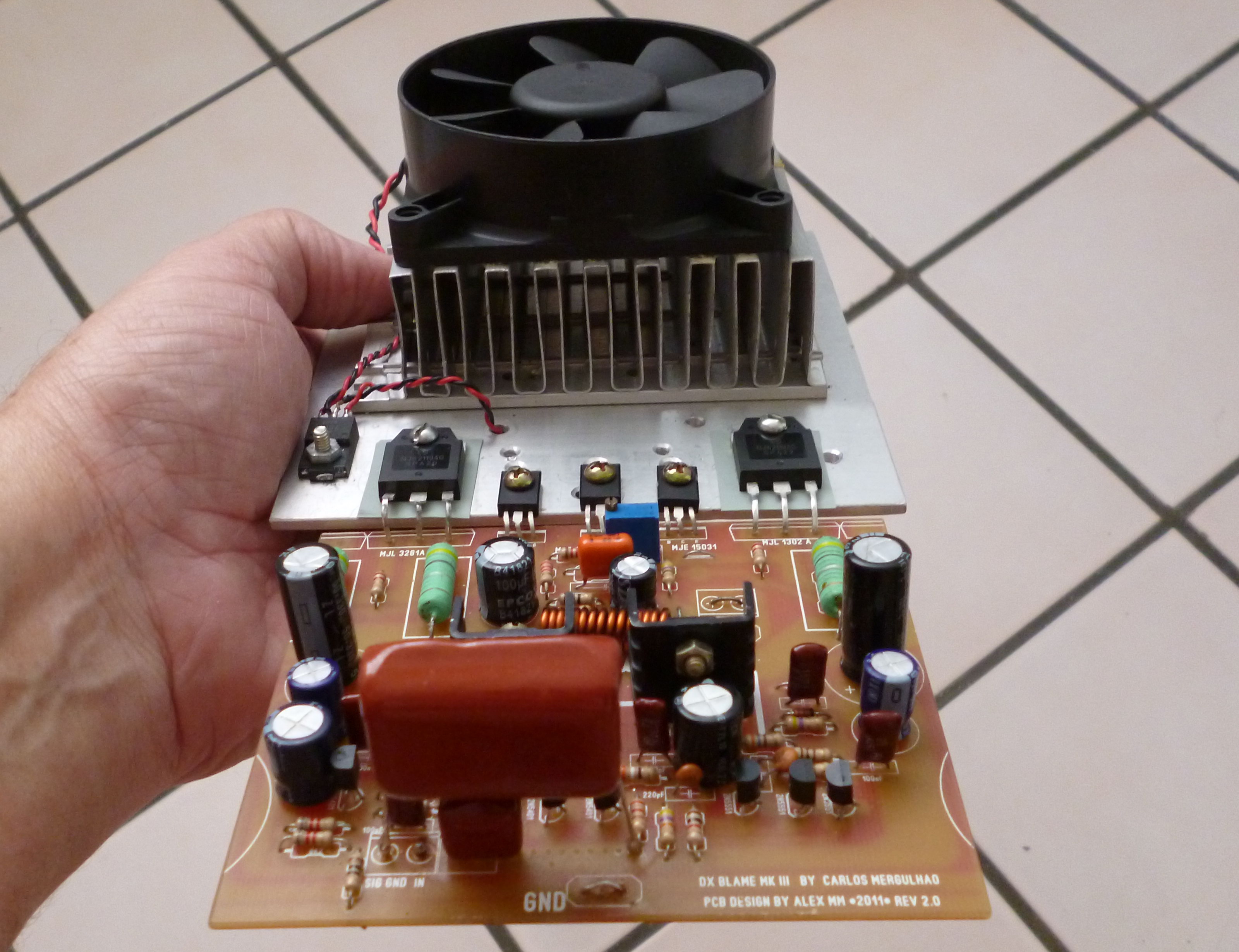

dx super A
I'm here to hear all suggestions .
i'm not a designer engineer and i DON'T KNOW EVERYTHING
I will continue testing all my diy amplifiers
Didn't believe that measurments isn't the truth.
I have repeat measurments in another place with another test equipments.
Results are same and publiced.
The amplifier is playing of course ,the video is on youtube.
I have inspection my board again and again.
Another builder have same overshot ,so it is clear this isn't mine mistake.
No one is in my ignore list because no one is my enemy.
Best regards to all.
Thimios.

You are not in my ignore list too Thimios
Entered, but when i have perceived your good will....then was removed.
If another one builder has the overshot..then we have a problem.
My last post was not dedicated to your Thimios...the target was other guy.
As soon as my pcboards arrives...or even if not arrive, then i will etch and gonna build into the pcboard to see if the trouble goes to the pcboard or to parts....about the design i do not think so, as i do not have overshot in several amplifiers already made.
I had once, some overshot, in the Precision 1... what i cannot remember if this was detected before or after the release... the solution was the adjustment of the output coil ...inductance was increased if i am correct in my memory..also the parallel resistor was tweaked.... sorry, memory is not something that works very good on me.
If you find solution to the overshot..then let me know.

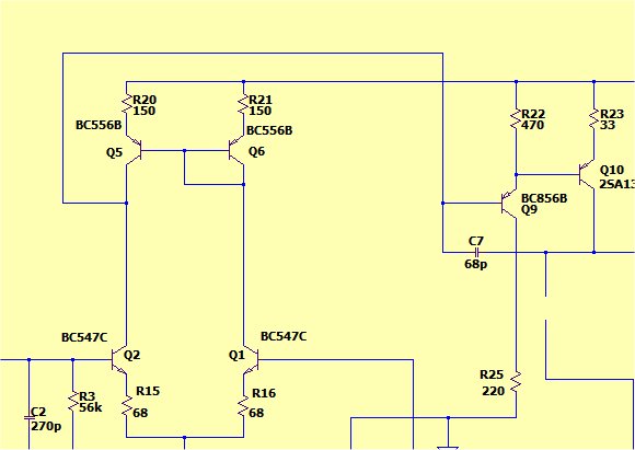

If you sold the board and the parts - had total control over everything ,
no one would have overshoot. Everyone would have your exact amp.
But , they use the parts they have ... all over the globe. BCxxx grade a-c
grade C can be very high (800Hfe),or low ... grade A (120).
I ran (simulated) your amp with 556b models - 10R/68R for LTP/CM , and it is
at edge of stability by design. For the 556B you use , this is good (sound).
Use a 556c , and overshoot/ringing will be there. The low Re for LTP/CM is good
for low noise , but the design offsets this by using 1.2k/56k for DC/Nfb (higher
noise).
This not MY opinion , but the way transistors work ... no way around it.
Using a huge miller (150p/220p) reduces performance at the VAS.
Subwoofer amps such as .. Project 117 .. use the "monster" miller. Rod elliot says "can not
oscillate under any condition" = 220pF miller.
68p miller with larger degeneration at the input stages does 2 things ,
1. Allows a larger margin for error in device selection (more parts will be stable).
2. The "poor" little input stage will not have to drive such a large capacitance.
Lower THD will result. You can also lower the CCS current for cooler transistors.
Compensation for this amp comes out better (with even better performance)
with (below-resistor/cap values) , even the BCxxx c grade is within limits. In fact , ANY grade
of ANY of the components (LTP/CM/VAS) will make for a very stable amp.
In the "imperfect world" what you are doing here is "trading off" a little
input noise for more stability-wider device selection-VAS performance.
OS

I am at work and i am already inspecting with magnifiers
Wonderfull pcboard... very well made...we have worked a lot...in special you Juan.
I could not find any mistake till this moment... and i do think i will not find any technicall error alike long tracks, nearby tracks, danger of magnetic coupling or something alike.
I will assemble to check that overshot...it is not a big problem, but this kind of stuff scares people...and i gonna find the way to remove, or reduce, if i face the overshot at home
I will do it, but slowly as i want to enjoy myself building the best pcboard we have made.
