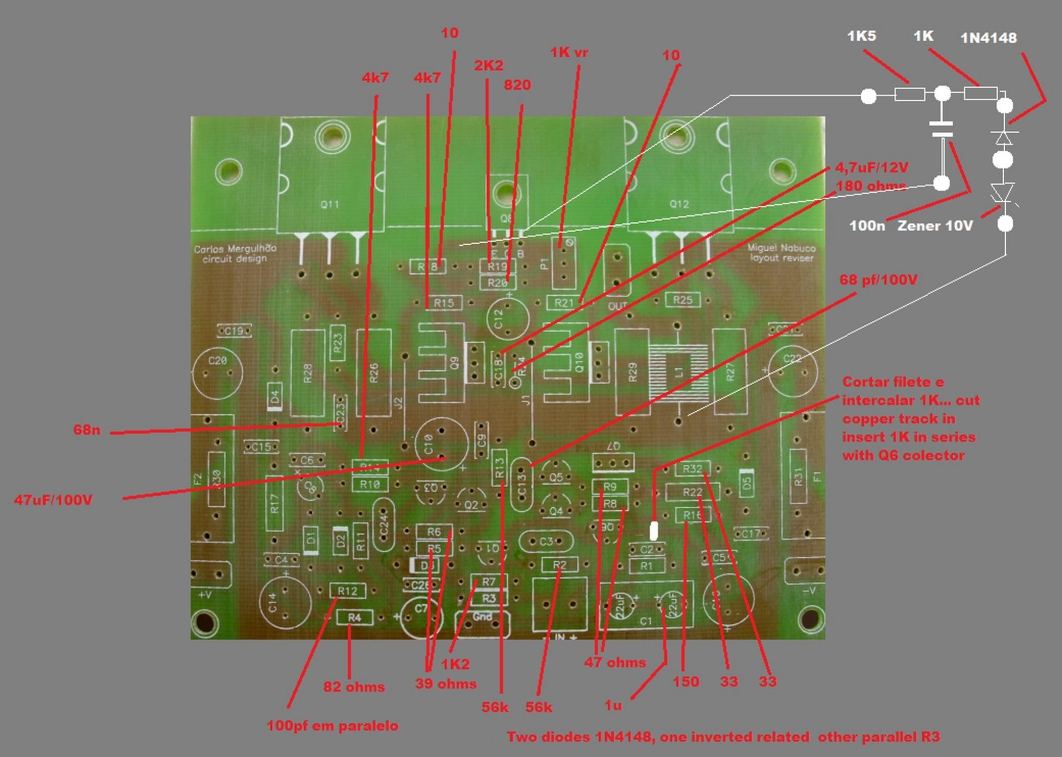

Dear overall, if the capacitor is creating troubles
Then remove it.
If perceive the absence of the capacitor, as empty holes in the pcboard, then install a couple of Megaohms resistor there just to fill the blank space.
If overshot is appearing in these pcboards...and bothering, then increase the output inductor value and increase also the resistor value that is in parallel.

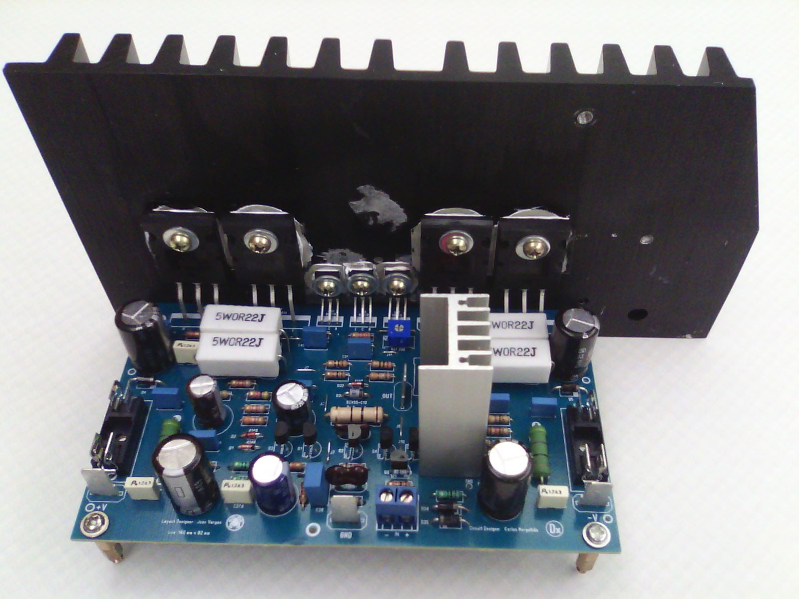

Nice video thimios...thank you.
Corazon loco (crazy heart)..... this recording is a mix of Italian language, modified spanish spoken in South America and also Portuguese.
Nice the paper clips to hold power transistors in place attached to the heatsink....lovely!...this is DIY in the most pure expression of art...really a genuine one.
This Blameless style amplifier.... highly tweaked for sonics, i something musicians usually appreciate.

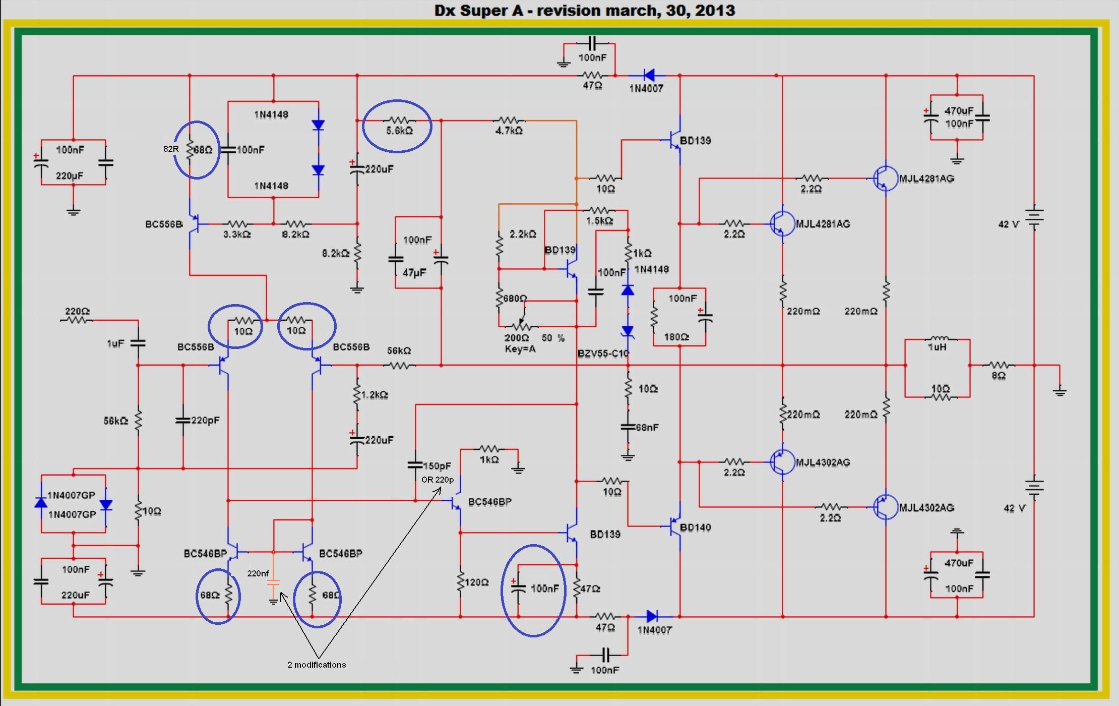

Last schematic made, result of last tuning, the last revision and last update
If you feel the differential CCS transistor hot, them increase the 68 ohms resistor to 82 ohms....it is left side and up the image.
Tunning made watching the harmonics... the advantage is small..but it is the last i have made..at my home, this is the schematic i am using in three amplifiers i have.
One to the Satelite TV Receiver, another to my computer as monitor and the third is to reproduce music in the laboratory.
The 100n capacitor into the VAS sometimes unstabilizes...if you perceive something strange, some harshing in treble high end..then remove it...cut it with a plyer, then you can insert it once again to listen...push it in contact with a pencil.... and then monitor full power noise from FM inter station...but do that only if you have powerfull tweeters as this overdrive the tweeter..... into the tweeter is always a good idea to put a filter into it.. something alike the zobel, or a 10 ohms resistor in series with 100N capacitor into the tweeter terminals....why?
You may use your tweeter with other amplifiers than the Dx Super A...and some of them produces a lot of harmonics, while clipping and these harmonics goes to the tweeter..unprotected it will blow up.... usually tweeters are 10 percent of total power...so...if your amplifier is operating 4 ohms..it can put out 150 watts.... and the tweeter must be 15 watts minimum to normal operation...but if someone decide to overdrive the amplifier, the power will go to 180 or more watts...rich in harmonics...the tweeter killers....so..be aware against other amplifiers and be aware that even the Dx Super A or other Dx Amplifier, when overdriven, produces crazy killer harmonics..and they go to the tweeter, as harmonics are multiples of the main frequency..so...they go to high frequencies and concentrates there.
As i told you, i have four pcboards, each one different from the other...i do that on purpose to see how stable they are.... and one of them show unstabilities and i had to remove the 100N capacitor...was a green board made to the Dx Blame ST adapted to use the Dx Super A on it.... to one of the two boards included in that amplifier, i found unstabilities with the capacitor inserted...why?
I do not know...maybe differences of components.....sometimes we have bad contact, interruption into a connection inside a component..sometimes inside a transistor, sometimes inside a capacitor...this switches on and of the component, and this produces strange noises into the waveform while clipping....maybe the removed capacitor was the defective one...i gonna track it back to inspect the hell capacitor..as the removal fixed the stuff....all other 5 pcboards, or 5 channel have not presented any problem like that....if i remember...it was an old Siemens orange colour capacitor.

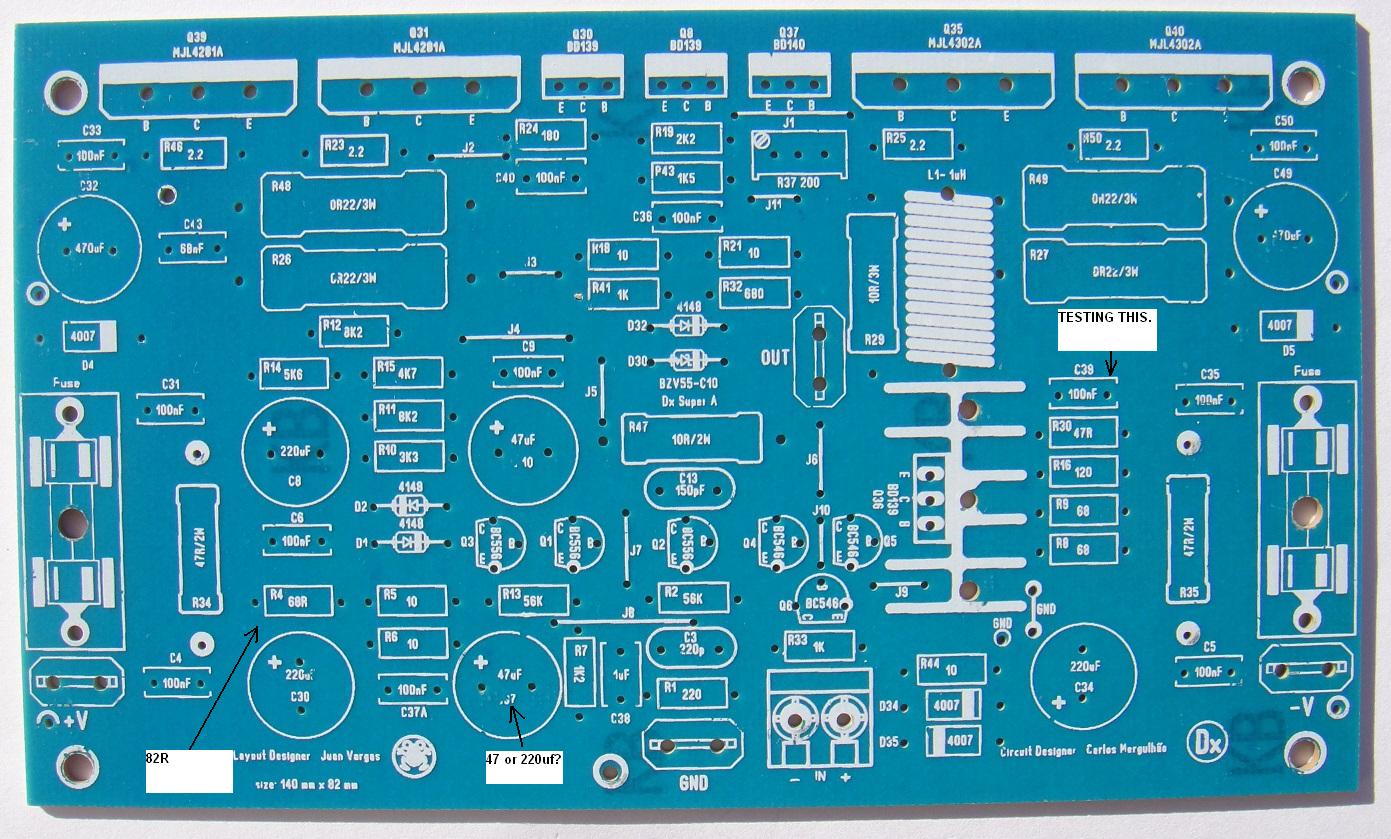

Juan boards use 220uf..... Brazilian pcboards from Zimmer uses 47uf
You can use the one you want.
This is because of tunning.... to each circuit i have selected a kind of sound, because of local preferences.
If you want sonic signature with more weight in the bass, then use 220uf, but this makes treble and voices a little bit blurred or undefined...if you prefere treble, if you love the high end..then reduce to 47uf.
This creates a different harmonic distribution, has some minor effects...what is better?
For Brazilians it is lower value, something of update made in Brazil a couple of months ago.

Well ... this unit was made according to the last schematic published
It is not a Zimmer amplifier pcboards nor Juan amplifier pcboards...i am using Brazilian group buy green pcboards made in special to distribute in Brazil...i have many pcboards left and i use them as a base to assemble my amplifiers...below the pcboard there are some extra parts needed..some arrangements made to install my new circuit into the old green pcboards.
Man ... i have so many pcboard models that i gonna be tired to show you all them..but for sure no one have produced overshot.... this is unaceptable to release...having this effect or defect in my home i would be working till fix... and if not fixed, then the amplifier would be killed and trashed..... and i do that to make good stuff and because to avoid what is going on..someone showing overshot, in this case you, and people thinking the amplifier is no good....to avoid that, i do not release anything with strange behavior.

Well.... overshot does not kill sound..... it is not normal but does not affect sound...or at least, humans cannot perceive.

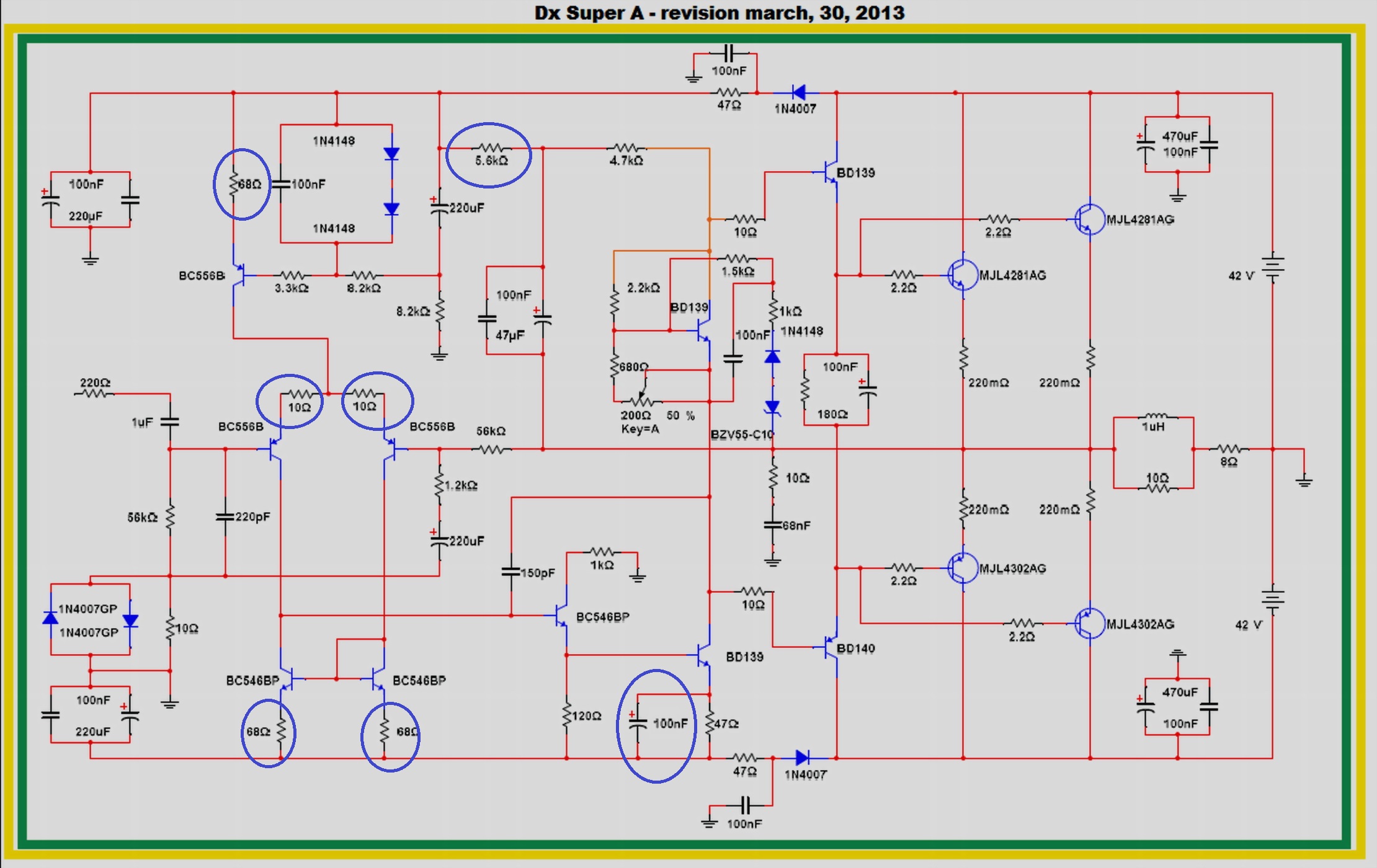

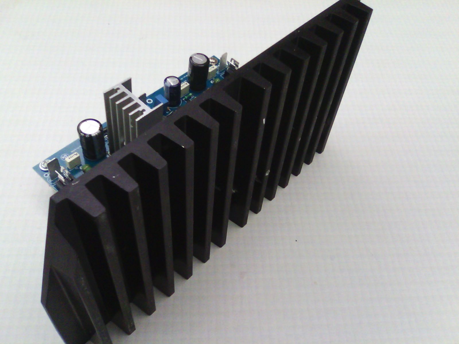

I have to say that a good friend, Mr. Adi Klausner, have assembled Dx Super A, using Juan pcboards...he is happy, satisfied and sent me pictures with thanks.
Yes, he is on troubles...the toy heatsink cannot face even 8 ohms.

You can give it a try dear Thimios..because the overshot bothers you
And the overshot does not sound...also the capacitor installed there does not sound as i have tested listening today.... it can slow down the amplifier, but this is theory, real world is what you listen.
If this is what bothers you, the overshot that appeared into your pcboard, then you may be rid of it.
Before suggest you i have tested myself.... listening and inserting and removing the capacitor... it is not a matter of" i think so" as many people does..i am sure will not impact the sound...if others say that to you... that may impact the sound... i can guarantee they are lying to you.
In the reality, not only the overshot or the cure i am suggesting you will not harm the sound..it is just a psychological matter.... that tragic belief that something goes wrong...and this is something that may be studied this way..... what will be good for you to feel good.
Again i repeat, this overshot is not presented in my amplifiers...the ones i have at home... the overshot does not appear in the simulator nor into the oscilloscope.
It is possible, despite i have not that belief, some problem into the pcboard layout..... as soon i receive mine i will check it....also other guys can report if they face the same problem..if they face, then the pcboard may tbe something to have suspicion, as i am not having the effect/defect in my home while using other pcboards.
This overshot (better to say hf instability) could not be present in any amplifier, it is fault and of course it is audible ..

If You really want to know what to do (but it is a bit late, no?), I can post schematic with corrected faults. But yes, here will be a lot of things that must changed step by step, because a lot of basic faults
