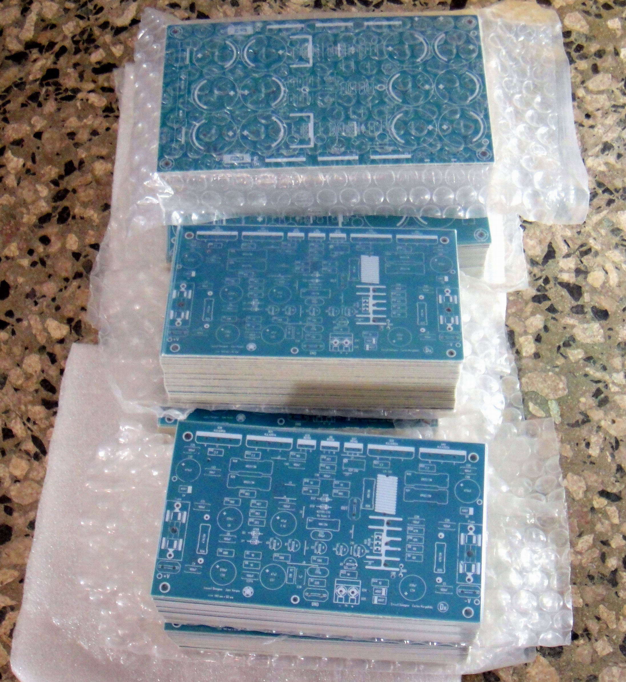

Almost half or the whole batch was sold.
I suggest you to move.
Well.... in one month we gonna have white pcboards from Zimmer too..the Brazilian pcboards.... same price.
regards,
Carlos

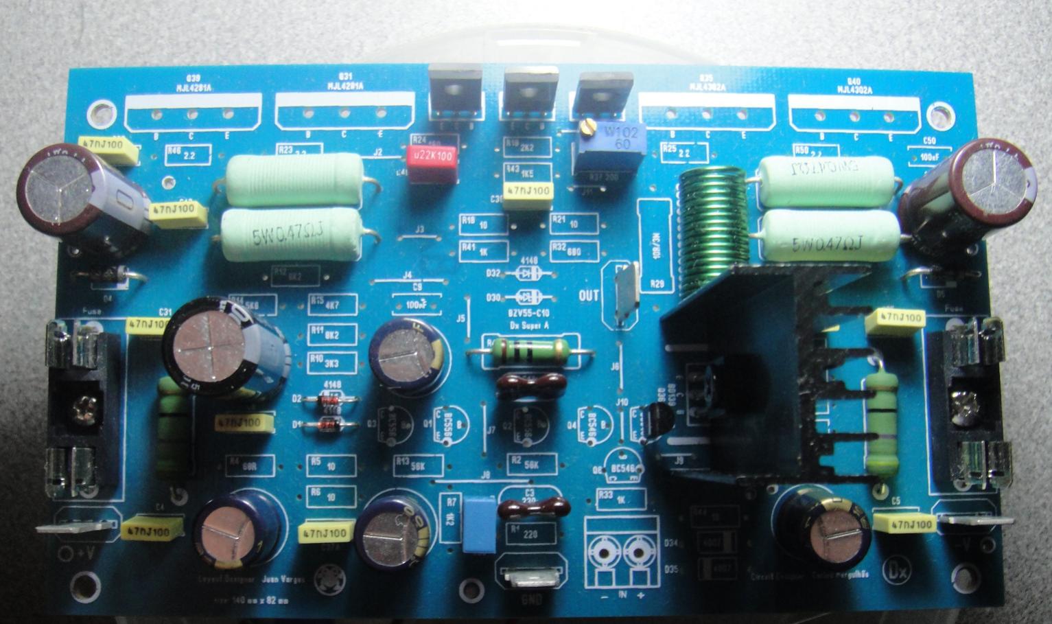

Wow, OK, so I sent payment at 3PM on Saturday and the boards arrived today. Simply amazing. Nice boards too. So much for me gathering the parts while I waited for the boards. :D
Only one bummer, the PS caps that I was hoping to use don't fit. The caps I have are 35mm and the board needs 25mm. Not a huge deal but there are twelve of them. Looking on ebay right now. I already completed my order from Mouser. That should be here any day.
Thanks Juan for being so prompt!
Blessings, Terry

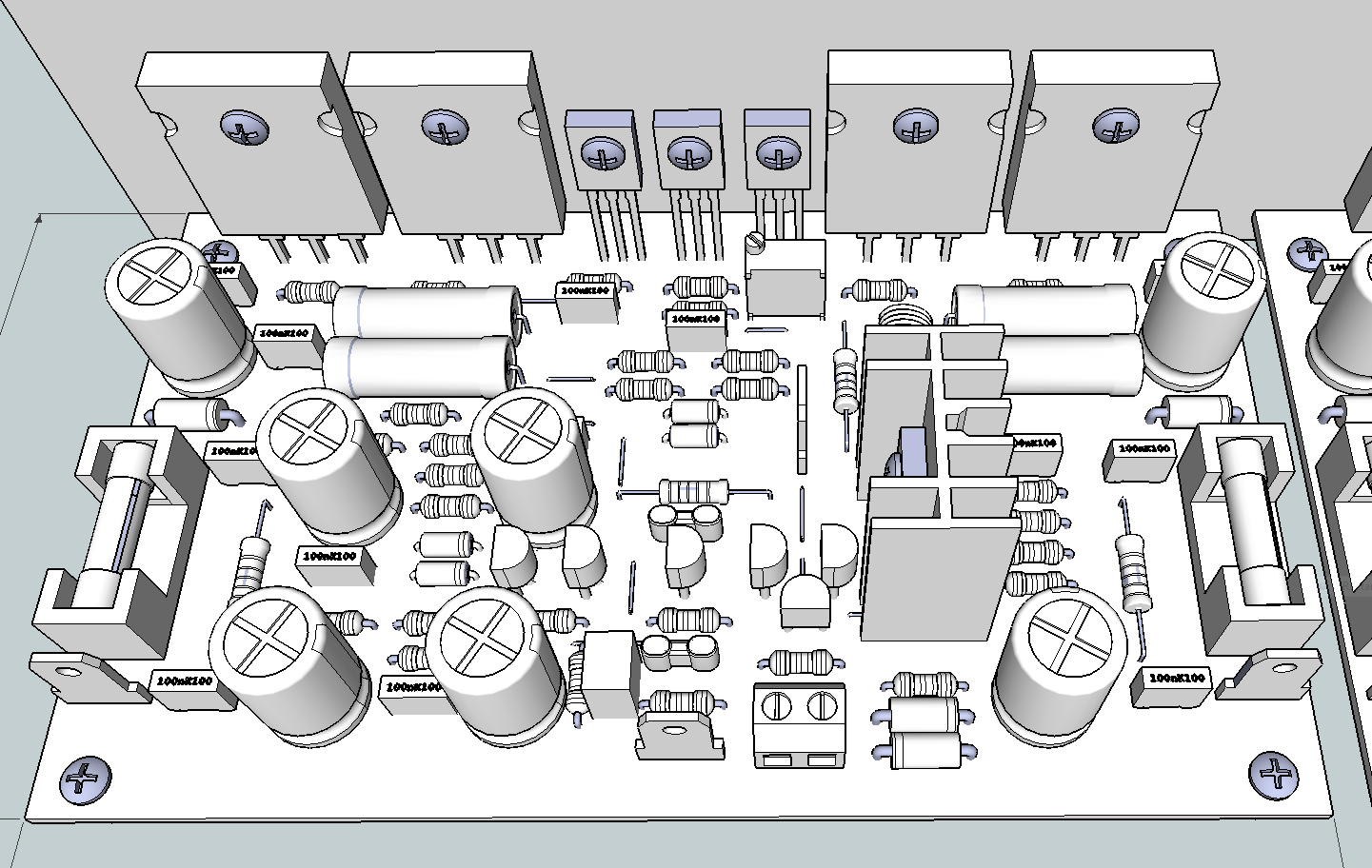

well I like to share my ideas as always I was simulating how the final project looks like using Google Sketch

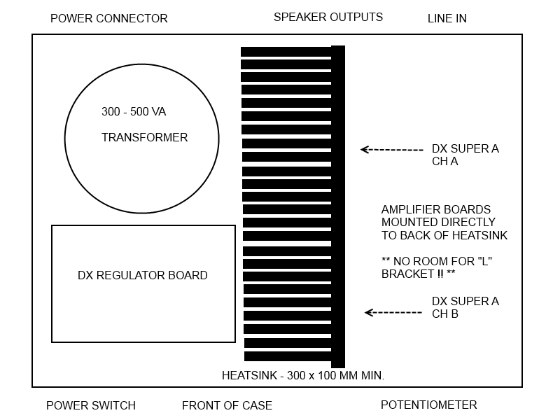

Hi Juan, I really like the way you have mounted both amplifiers (stereo pair) on a single heatsink. I will be building my DX SuperA with single heatsink in the middle of the case seperating the transformer and regulator board.
In my opinion this makes for a "cleaner" looking case (no heatsinks visible on the sides or back of case).
can you make a quick drawing of your idea if possible ? :)

Terry see if you can drill new hole for your caps to fit. Usually excess traces on filter cap are adaptable to different size caps...
Hi Crispy,
Naw, it won't work, the lead spacing is actually ok, it's the diameter of the cases that is the problem. You can see in the attached picture. They overlap everything. Best to just buy some new caps. Found some on ebay for less than $20 for a whole set of 4700/63v.

Juan, I will upload a better drawing tonight.

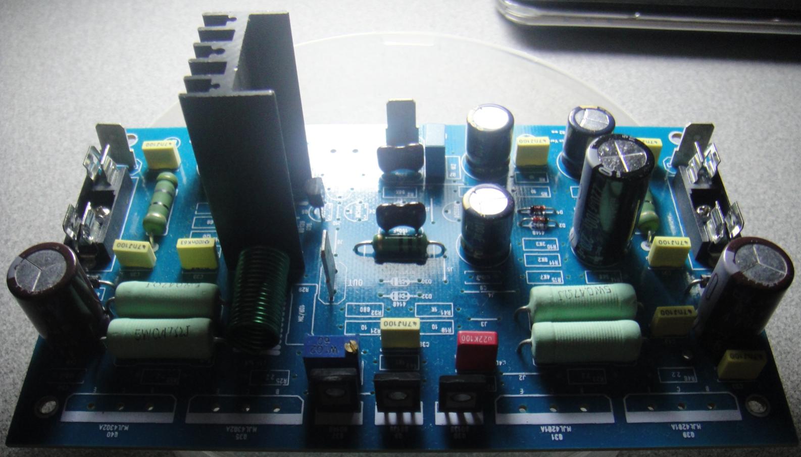

Terry, do not forget the power transistor insulators
Some tips:
Use thermal grease too... attach transistor applying some strenght... a lot of heat is generated there as transistors are resistors.... they are variable resistors, or transference resistors....where we have resistance we gonna have heat.
To clean the excess of grease use cotton wabs (cotonette from Johnson and Johnson) dampened with Kerozene.... clean also using a cloth dampened with Kerozene...but do not use too much liquid into the cloth or the cotton, because if liquid, it infiltrates behind the transistor and dissolves the grease..so....humid, not wet.

Attention to avoid shorts while soldering...clean the pcboard with a brush and kerozene and inspect it with lenses, or magnifier.

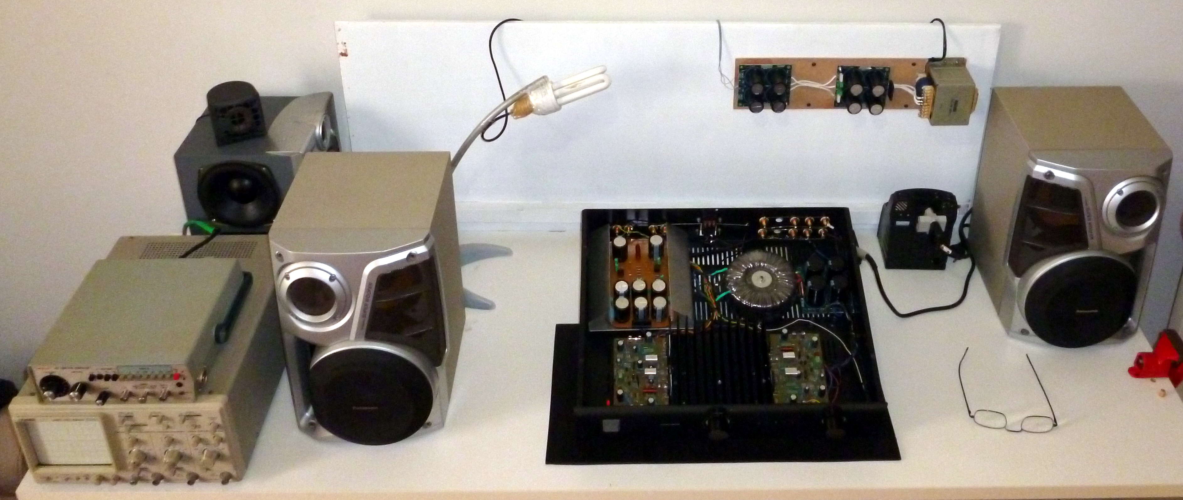

I was testing if the Super A sounds good with these
speakers.
I found result good.... small bass and strong treble and mids.
This is because the amplifier that matches this speaker have 4 output, four amplifiers, one for bass and other for treble in each one of the 2 channels..so...circuit ballances volume in between bass an treble there.
I have joined the speaker wires together..the bass speaker plus the midrange and tweeter... and no resistor to reduce squawker and tweeter effect..this way resulted too much bright..but quality was very good..unballanced tones but nice quality.
Well, these speaker almost melt...they cannot face the Dx Super A power..... we have twice as much as these speaker can hold.

Hello guys
I was comparing my simulation to the real thing it was almost as I thought how will look like and I feel really happy with the results, now that I have a bit more time I can gather the parts I need it, thankfully I have must of all 1/4W resistors and I need to get me the caps, those you see on the board are just to see how they look, the green 7 watts emitter resistors is really not need it but I like to make my boards nice and it feels great I'm not sure if you guys think the same way as me, well I have to separate the resistors and commence installed them today "if" I have time jejejejejeje alright guys take care
