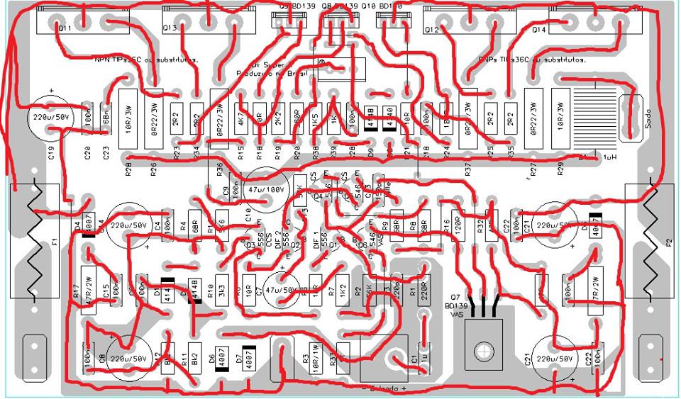

Make the pcboard youself...we did and worked great.
we have used hot iron method of image transference... xerox copy of the layout or laser copy..and then we make the image transference using hot iron for clothing... laundry hot iron.... maximum temperature and long time over the paper till it becomes yellow (burning and smelling)...several minutes applying heat..in special in the corners because it is there (outside perimeter) where more failures happens.
This works great...need some skills but the second time we d....... usually, results fine.
When we do wrong way..then we have to remove the toner using steel brush and do it again...just that.
The "never miss method", tracing red lines over the schematic and checking in the pcboard works great.

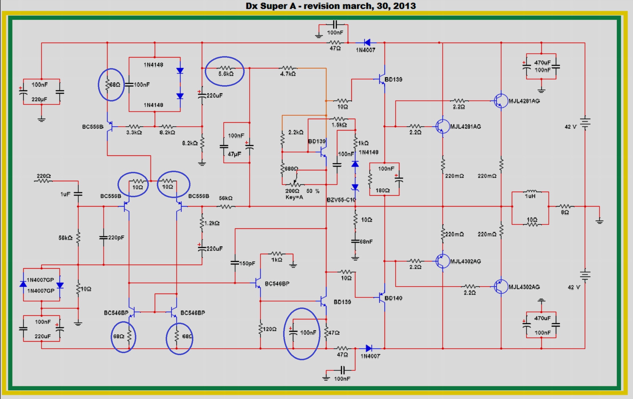

Dx Super A works together Dx Supply
But you can have amplifiers only if you like the simple standard power supply.
Audio is clean with the Dx Supply or any kind of series pass regulator that has some electronic filtering or capacitance multiplier effect... sound is still very good while using standard analogic power supply.... or, simple rectifier and filters.
I do think to push the amplifier hard, and without a good electronic filtering, you will have some main noises (60 and 120 hertz ripple) together your bass tones..this way result your bass tones will not be that pure...but....there are some guys that likes this way and they feel the sound with "more body"...as it is a multiple tone bass.
Imagine a 35 hertz tone playing...pushing it hard you gonna have 120 hertz tone of rectification not perfectly filtered..then your tone gonna have a composite tone... this happens when you use standard power supplies (rectifiers and filters)
In matter of fact, the 120 hertz tone and harmonics resulted of tones beating one to the other are weak in comparison with the main frequency of 35 hertz ...but they are there..and you perceive the bass as not perfect.
This happens when you push the power amplifier hard and when your supply is not electronically filtered.
This is up to you.... i strongly suggest you to use both... Dx Super A and Dx Supply..... will be a good experience for you life to check the performance of both parts working together....made one to the other.
If you decide to use a normal, old and standard simple supply (rectifier and filters) i do suggest, anyway, you to keep the Dx Supply, as you can adjust several voltages and this can be very helpfull to use together other projects. as a workbench power supply.
But if you want only the amplifiers..no problem at all...you can also order the supply only....not only order but you can make by yourself, as all layouts are provided to you to etch at your home.

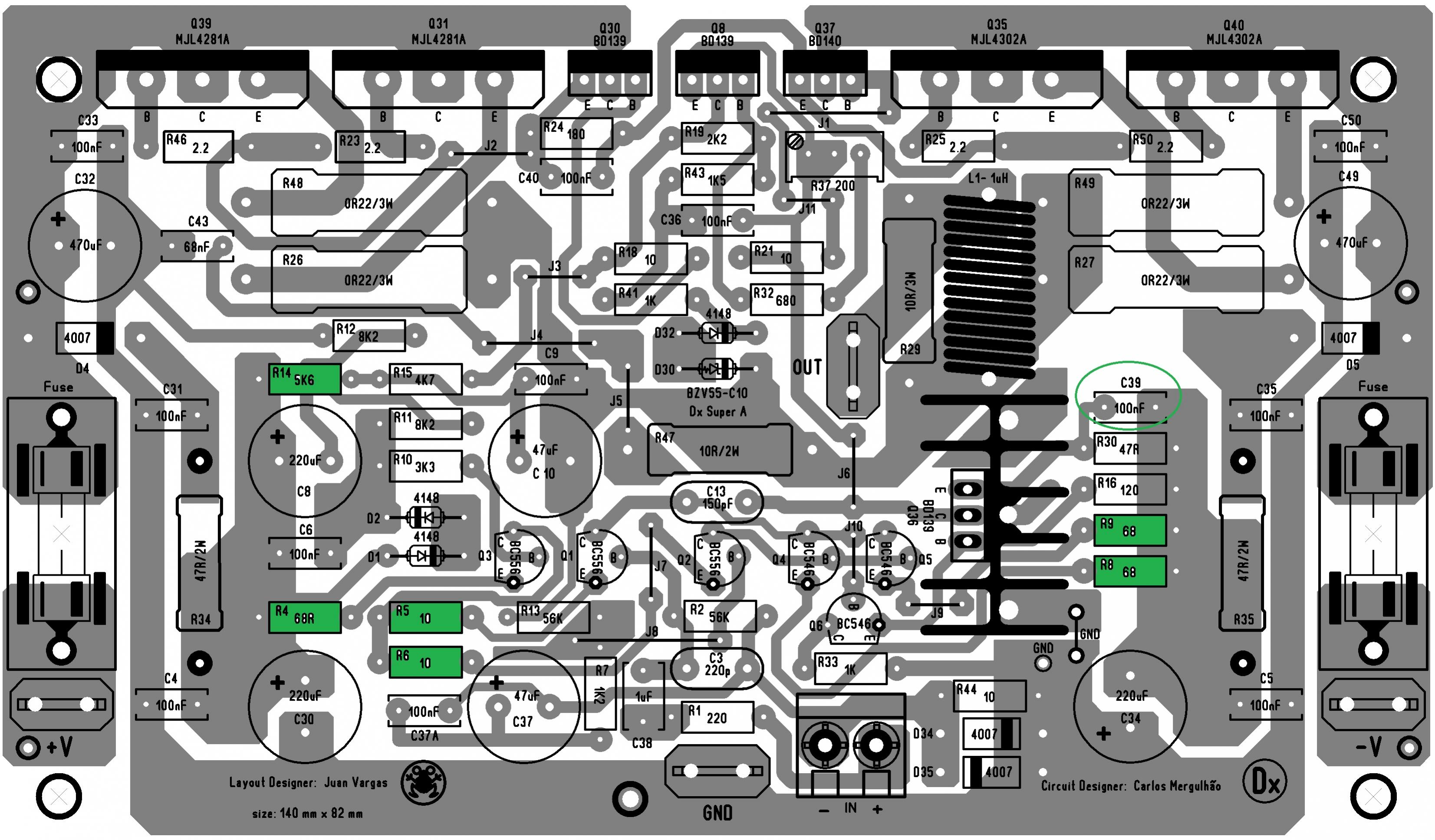

Hi Juan,
Did you get my email? I want two boards when they are available.
Thanks, Terry

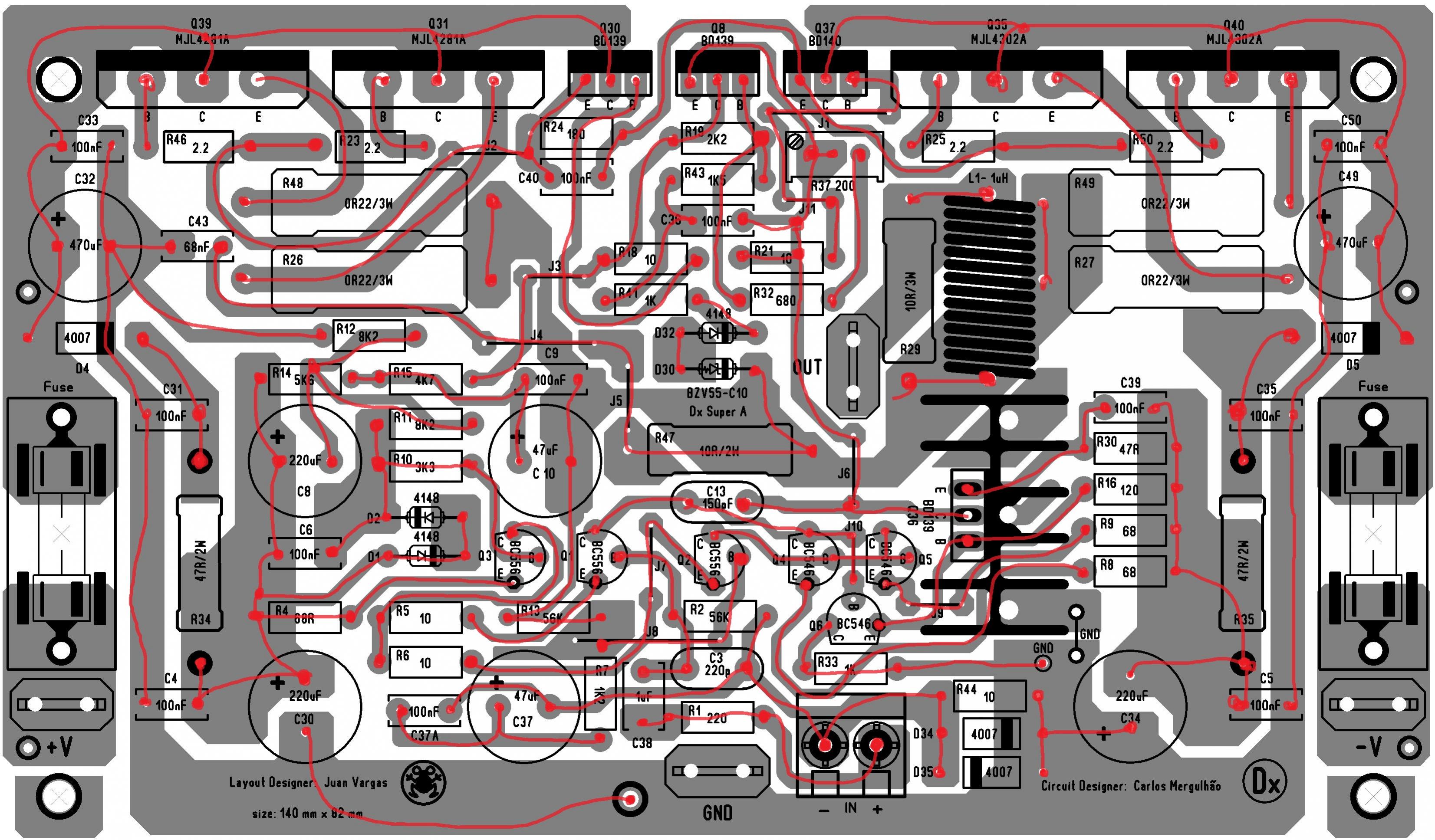

Hello Carlos
Have you considered doing a layout with two amplifiers and the power supply all on the one board? A stereo amplifier with all the output transistors in a row attached to one big heatsink. It would eliminate a lot of messy wiring.
Hi sir is not a bad idea you have to incorporate all in one single board but remember that will add extra cost to the project and also can make it more difficult, yes it can be done but think about this not everyone will have the luxury to get really large enclosures, I'm a poor guy and I still not have the case for my Dx Super A's but I happy any way with what I have, the Dx Super A will be a lot smaller than the previews one 140 mm x 82 mm, what Carlos and myself was trying is to reduce size the best we can so that lower the cost if I'm to build a large boards let said 230 mm x 220 mm that will add an extra cost, and in my opinion from what I learn from mister Carlos if you design something that is "unique" always keep it that way I hope you understand sir.
Regards
Juan
Yes sir, that is the one I used. Sent it last Friday. If you need another please let me know.
Thanks, Terry
try this one then sir vargasmongo@gmail.com
I was checking and noting come out that is weird ?
Regards
Juan
Hello Juan
Thanks for taking the time to reply. While one big board (2ch + PSU) would be more expensive than a smaller one, the cost should be comparable or less than the combined cost of 2x 1ch boards + PSU board.
I assume most people constructing these projects build two channel amplifiers. In some cases people may build 4ch amplifiers when bi-amping their speakers, in which case they could use two large boards.
For my projects I am going to recycle old amplifier cases. Here in Australia people throw away (or sell very cheaply) their amplifier when it develops some small problem rather than have it repaired. For $10 I can buy a broken amplifier with perfectly good case, transformer and heatsink. The electronics can be disposed of and replaced with DX amplifier. It is much more cost-effective than importing metal cases from overseas, with the expensive shipping cost to "down under".
Regards

This is an example of what I mean. The rectifier diodes could be either on the main board or next to the transformer bolted to the chassis.
