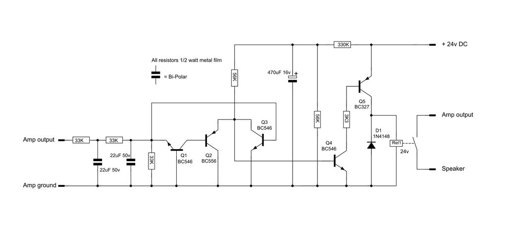

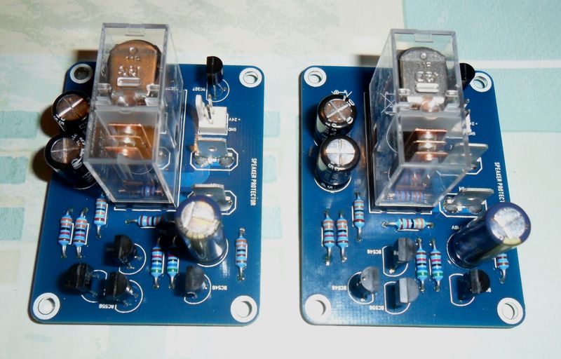

I use this circuit (originally from Silicon Chip Magazine) in my DX Blame ST. One board per channel. It delays speaker turn on, and fast disconnects speakers when main power is off. And the main protection is against DC on the output. Well, I have had one occurence of DC after an exccessive input signal blew up one of the channels (one driver and one output transistor), and nothing happenend to the speakers.

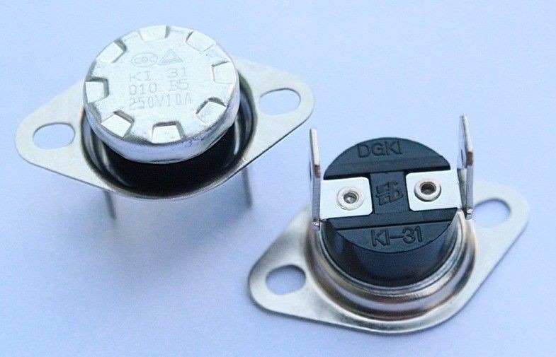

thank you. did you use the thermal switch? it seems to be a thermistor but I never used one before. would you to explain this please?

This is a mechanical switch (like on old fridges) that you mount directly on the heatsink. In this case, should be the normally open (NO) contacts type. I would rather install a NC one linked to the input mains, so the transformer would be turned off in case of excessive heat, not only the speakers.

No, I did not install this part.
Ok!
I think that this part will be not necessary in this amp.
I will use good heatsink and speaker protection. Also an accurate choice of fuses on the amp may be helpful.
My question was about the dc protection, if it was able to work also without the thermistor.

It would be simpler to adopt the following schematic which is identical for DC protection and which has a time delay, to have 24V just add a voltage regulator or a resistive bridge in relation to your supply voltage.
I used this shématic in several amplifiers without problem.
No need to use the thermal switch. Simply leave its connection open.
It is exactly the same as above, except for this one does not immediately disconnect the output when power is turned off.
Yes, that's what I said.
After disconnecting immediately or not when the power supply is switched off does not matter, what is important is that it cuts off immediately when a dangerous voltage appears on the output of the amplifier.It would be simpler to adopt the following schematic which is identical for DC protection and which has a time delay

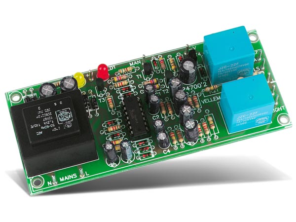

I think i will use dx protection as it is a standard type and fully working. Maybe i will use a board with PS and dc protection together.
