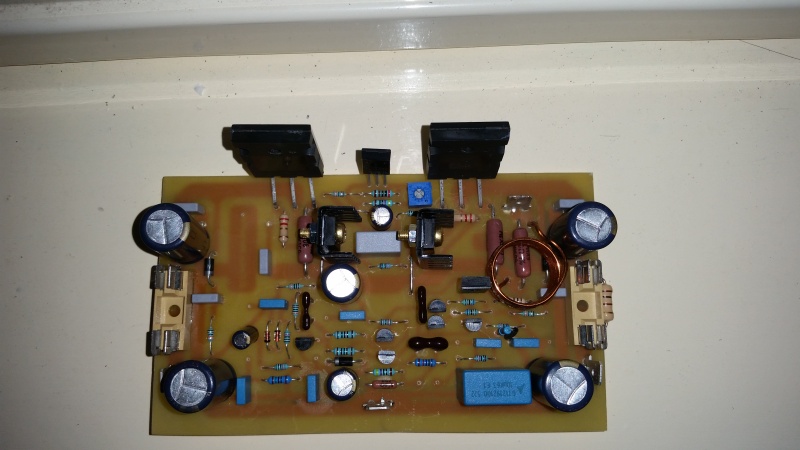

Williamdomingues...check your construction several times till you find errors
For sure this is not a nomal behavior and i cannot know what kind of mistake was made....there are so many options of mistakes that will be crazy to try to list them.
Check till you find.... check resistors, diodes and transistors related polarity, value and remove them, one by one, out from the pcboard to be tested.
Check the pcboard with the schematic..check each copper track and trace the checked lines in red or blue or other colour into your printed schematic
Check for interrupted copper lines and check for short circuits.
Strange behavior like off set, or big voltage into the output, no modification in bias current when you turn the trimpot, over heat in components or parts damaged show us the circuit is wrong related construction.
If you find the mistake, since parts are not damaged, then the amplifier will work perfectly...if not working you do not pray to god....work till you find the mistake.

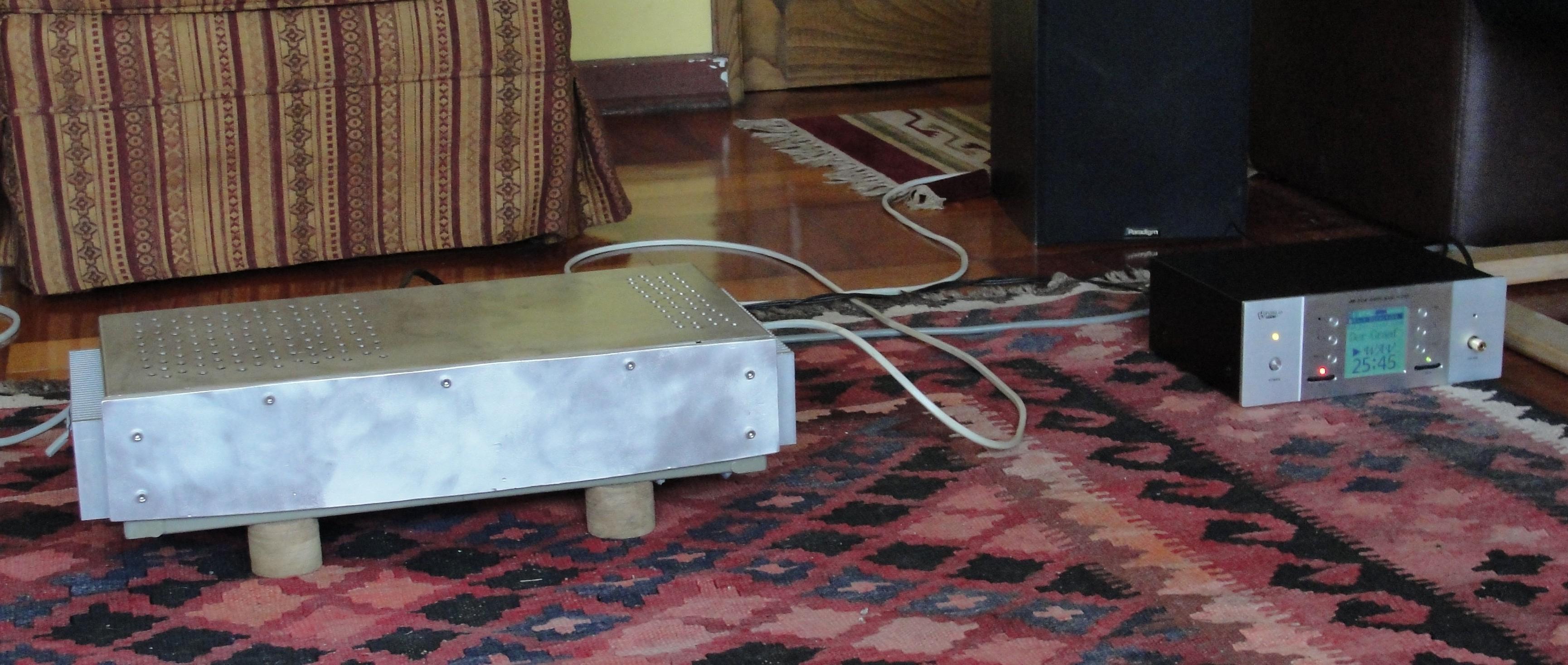

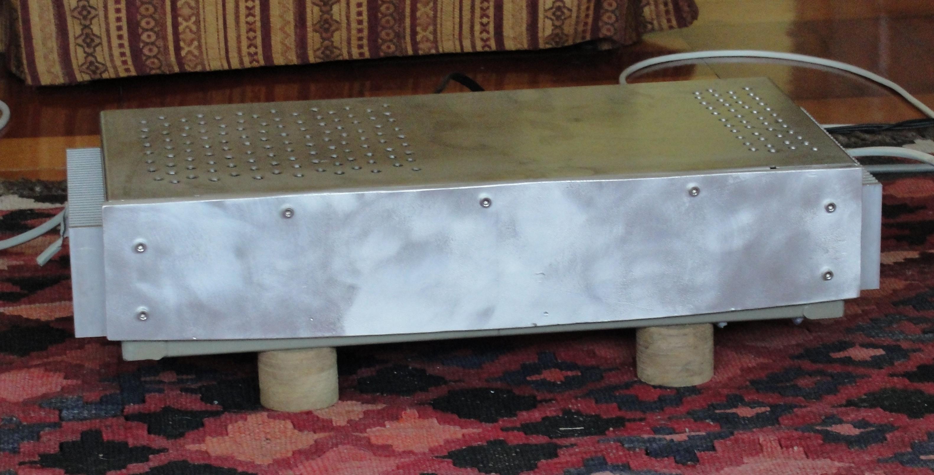

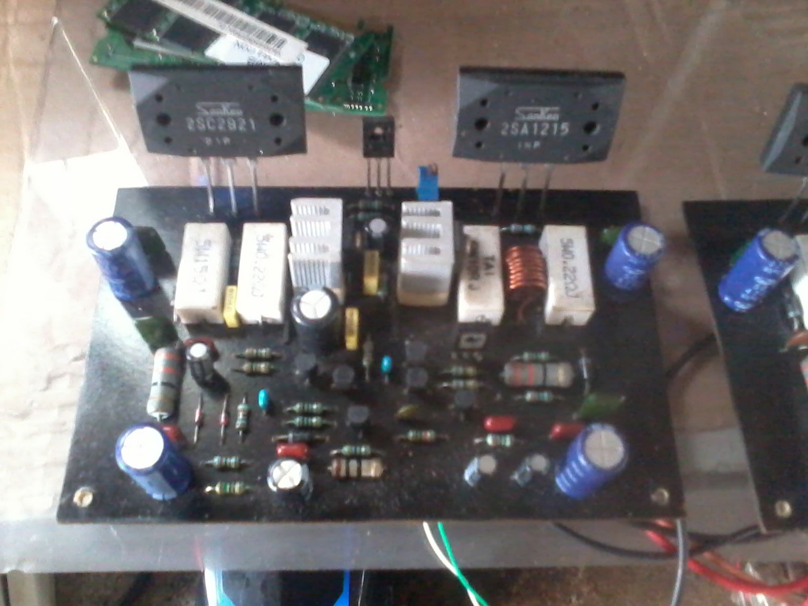

Dear Carlos,
Finally, the Blame ST is on its new DIY case.
The fins are a little small but that's all I had.
Sounding very good with deep and full bass. Never a complaint there, even with cheap SMPS (modded). Very especial sound, naturally detailed and layered.
Thanks again and enjoy.
M.

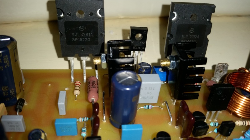

I send you some 2N5551 if you want me tohey guys, i fixed that issued adding the 1k resistor between the C of q6 and ground.
it is also recommended to replace th bc546 with 2N5551 but I can't find it.
Do you think bf493 is also good ?
hey my friends, here's the first channel of my dx blame.
Hope it will work at first attempt and no blow anymore.
regards

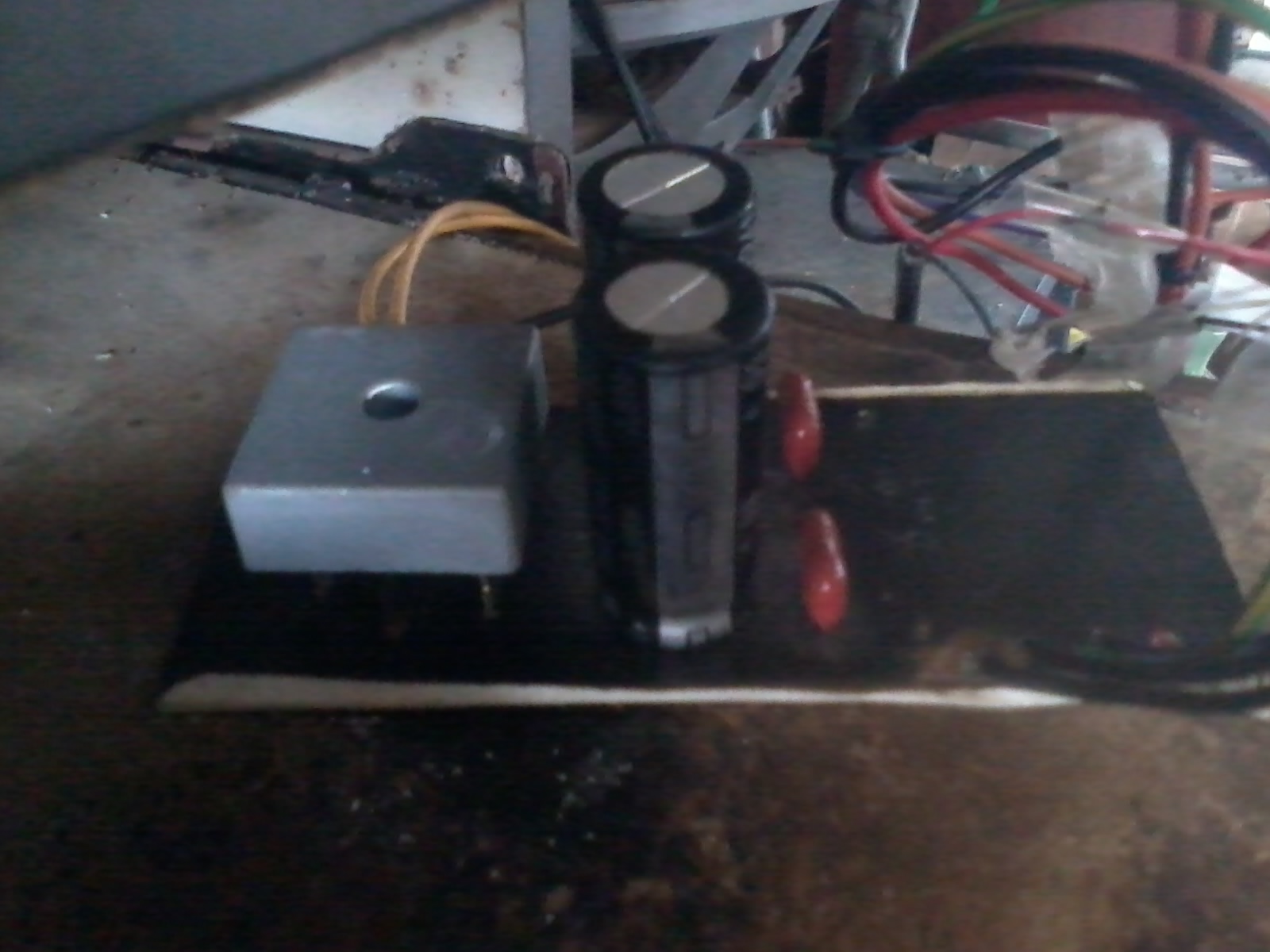

For those interested, I've been doing some experiments with the Blame's PS.
At first, I ran the Blame with a conventional linear PS that I use for experimentation and yet it sounded very good, as is supposed to sound.
I did not have any suitable box that could accomodate the amps and the big linear PS that I wanted, so I choose instead an inexpensive 500W SMPS. SMPS as you know have many very convenient traits, like slow turn-on, small size, efficiency, relativelly low cost, auxiliary PS voltages...
The Blame with the inexpensive stock SMPS sounded very clean but lacked weight and "roundness" of sounds (due to lack of experience I bought a regulated SMPS which I think may be part of the problem), compared to basic linear PS, which usually means less mid-bass. I paralelled some Wima 1uF red caps to the outputs caps and I think it improved a lot the sound, being more "refined" but still lacking in the mid-bass and bass extension. I decided to use my usual weapon and added 18mF of Rubycon ZL caps per PS rail, to the existing 6.8mF of capacitance. I added also a power Thermistor in series with the AC input line to avoid triggering inrush current protection mode. It worked nicelly, with >4 seconds delay in start-up.
Well, intial impression is very good, better than with basic linear PS, better than ever. A truly great amp to enjoy classic rock and jazz music as percusion is very engaging and instrumental timbres are very naturally rendered.
I will continue my experiments with more advanced SMPS as I suspect them also...
Thank you uncle Charly.
M.

I also tried a 450w SMPS 52v rail supply with my VHex amp vs the 300va toroidal linear supply and got excellent results. Bass is very good and ripple with a CRC using four 4700uF caps is excellent. No hum no hiss no noise with ears pressed to tweeter or woofer. A very quiet amp.
