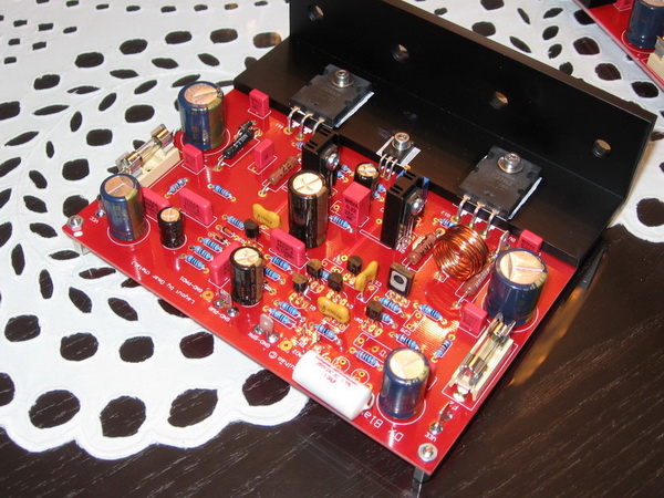

The way you've made your PCB you can't use a L shape profile.The PCB has to be a bit larger see pic
