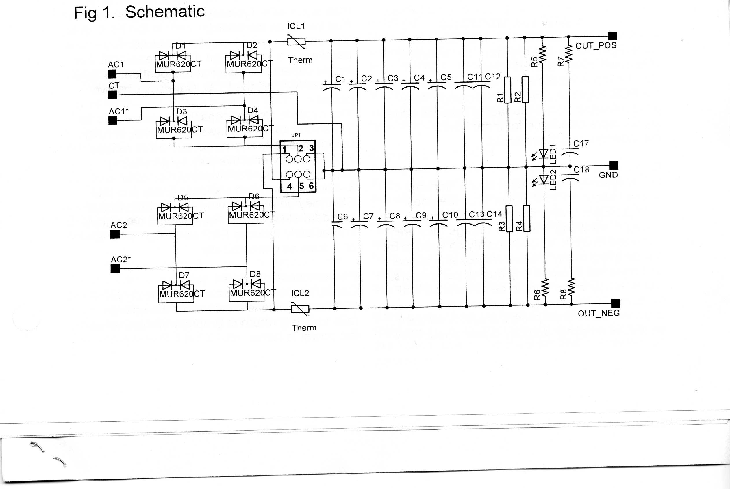

I need some help with the PSU for my dual mono Blame ES that I am putting together. I got some PSU boards but need some help with resistor values etc... each board will have 18000uf 50v per rail.
I've attached the schematic, Thanks for your help!

Hello Wendell,
take a look at Greg Erskine's Web Site:
Greg's Web Site
and take the values of the DX PSU, Carlos designed.
The values are:
R1,R3: the "Bleeders" - 2K2/2W (do not populate R2,R4 or use 4K7 / 2W for R1 - R4)
R5,R6: Leds' resistors: 6K8/0.25W
R7,C17 and R8,C18: PSU filter: 0R47/1W / 1n5
Instead of using thermistors ICL1 and ICL2 use "damping resistors" 3R3 / 3W with enamelled copper wire wound around them.

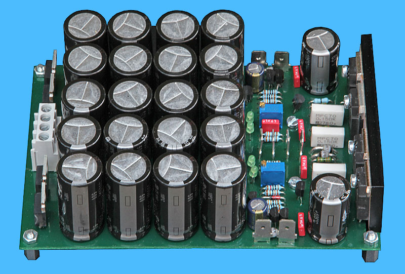

Amp is looking good Meanman. Nice and roomy. How big is the box?
Niss_man
W=42,5cm
D=30cm
H=8cm
This is a finished amplifier channel board (kit prototype):
